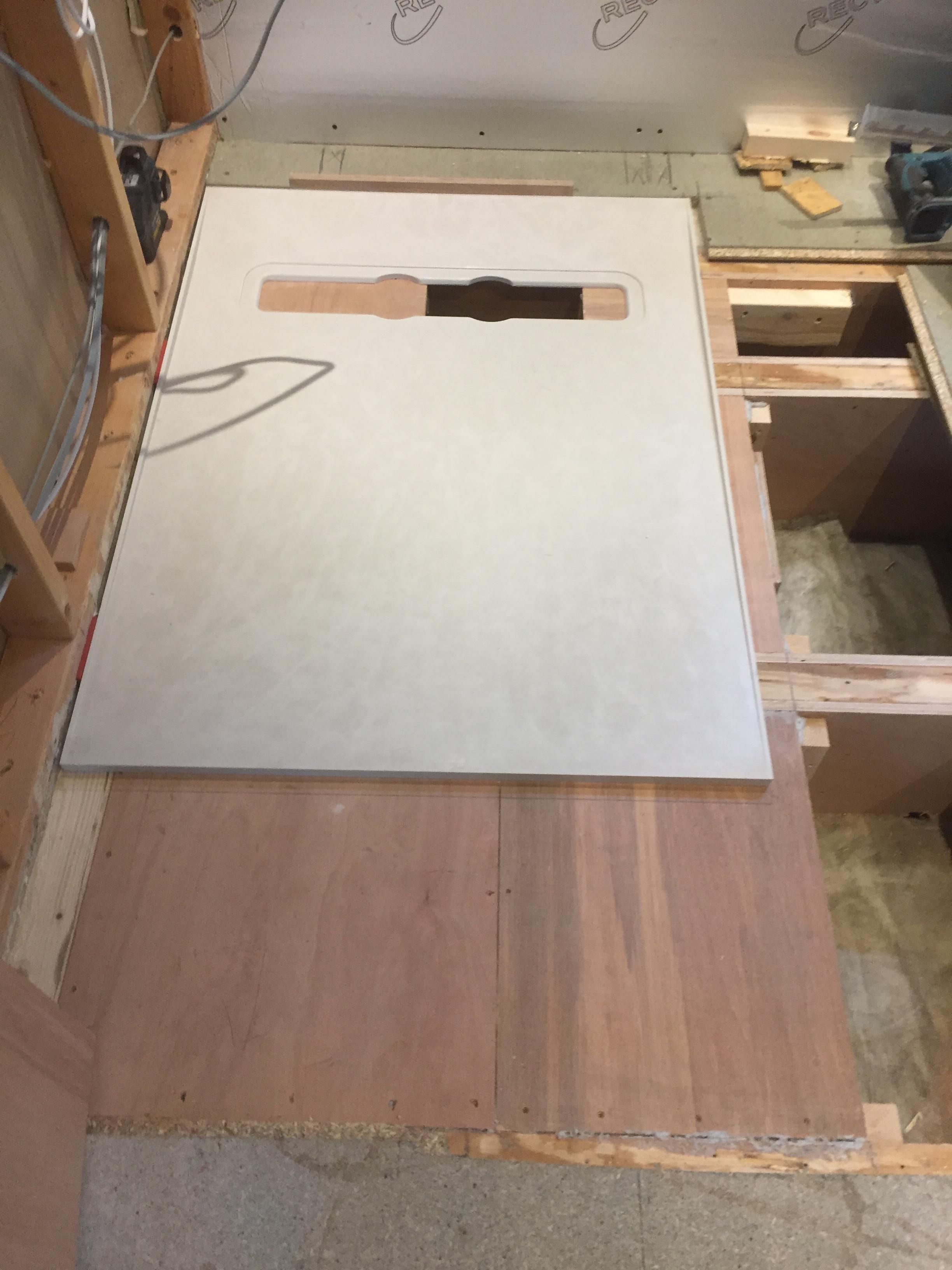

Fitting my Impey wet room former and am ready to screw it down.
However i have read the instructions and watched the video but cannot see them using mastic either under the tray or between the rotating ring and the tray.
For those who have fitted an "easy fit" is this right?

It's down to how good the subfloor is tbh. I always set them into a lattice of Sikaflex EBT and drill and countersink every single hole position.
A solid deck of 18mm plywood

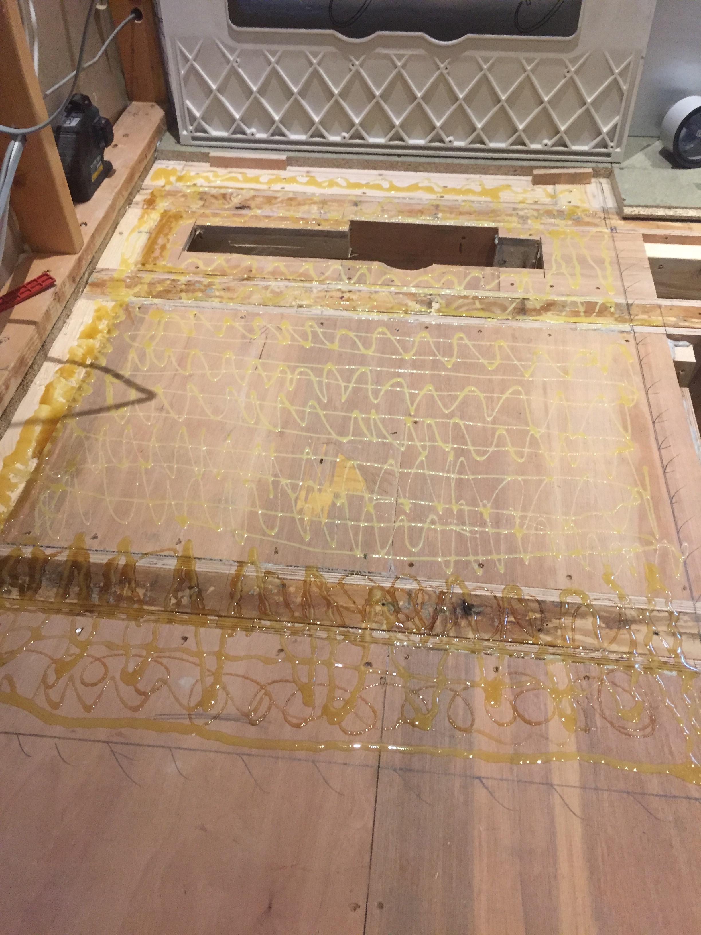

D4 expanding wood glue ready for fitting the 9mm fillet of ply used to raise the tray accordingly,

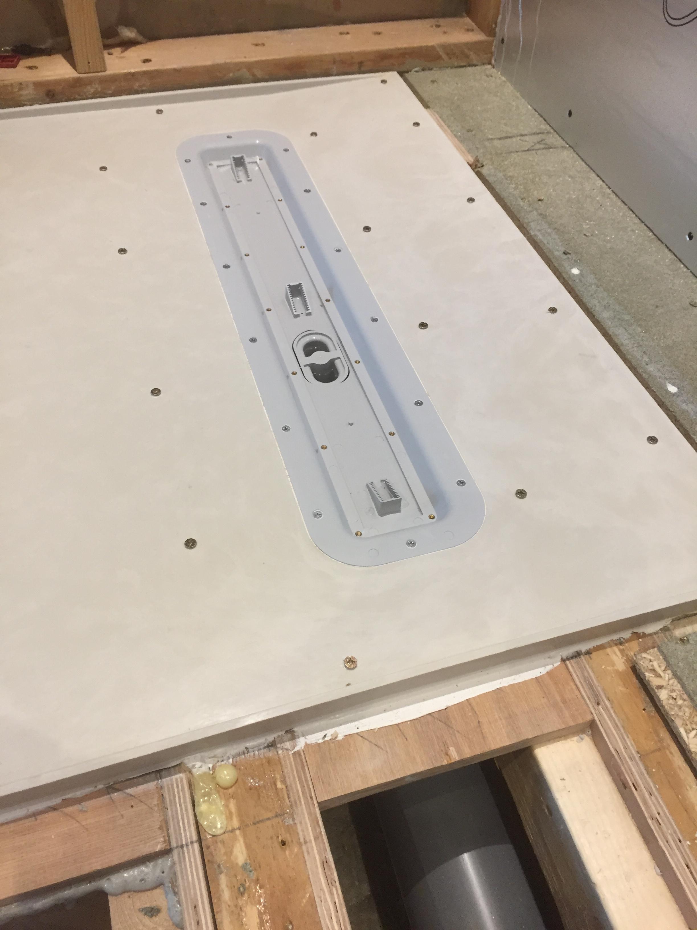

The tray set into SF and screwed at every hole marker ( the little pillars seen in the GRP from underneath ). See the little circles in the pic above ;)
You don't need mastic on the ring TBH ( DONT USE SILICONE WITH GRP EVER ) but I do use EBT regardless as I know it's bombproof then. The reason that Impey don't show that is because they assume you'll be covering the whole thing with they're waterproof decoupling membrane which terminates into the mouth of the waste, therefore after / past that ring and below the surface of the tray, negating the requirement of any sealant anywhere as the water ( in theory ) cannot ever get there anyway.
