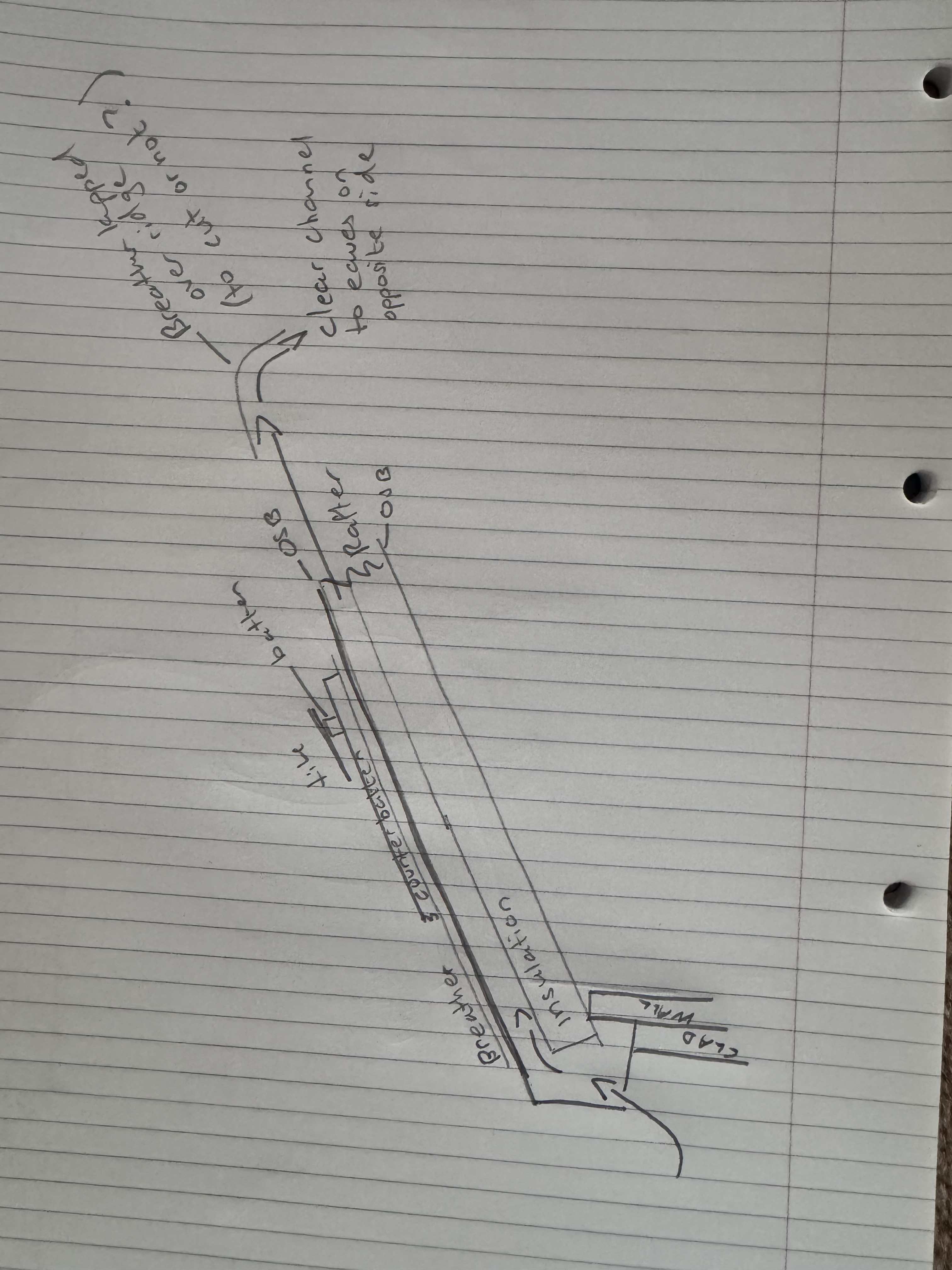

junglejim Posted Sunday at 08:07 Share Posted Sunday at 08:07 It’s time to make the cut across the ridge of the breather membrane… cassette roof construction. However it just doesn’t quite feel right after working so hard to protect the building and keep water out. I realise that I need airflow from the eaves and above the insulation to the top of the roof but with this design there isn’t av ridge beam so air can actually flow from eaves, over insulation upwards and back down to eaves on the other side… I’m wondering if this is sufficient to avoid the bed to cut the membrane and help me sleep easy knowing that the roof is watertight…. I’m sure this is a can of worms but any advice welcome. Thank you 👍 Link to comment Share on other sites More sharing options...

nod Posted Sunday at 09:47 Share Posted Sunday at 09:47 No I never have Some BC insist in this But I can’t see any good reason I’ve asked the last two BC and they have said it’s up to you 1 Link to comment Share on other sites More sharing options...
scottishjohn Posted Sunday at 10:08 Share Posted Sunday at 10:08 vented dry ridge system ? then it can come out at the tiop which is where the heat generated between tiles and mebrane will wnat the air to go Link to comment Share on other sites More sharing options...
junglejim Posted Sunday at 10:17 Author Share Posted Sunday at 10:17 5 minutes ago, scottishjohn said: vented dry ridge system ? then it can come out at the tiop which is where the heat generated between tiles and mebrane will wnat the air to go Thanks yes I have a vented dry ridge and airflow between tiles and breathable membrane. The question is about airflow beneath the osb as it’s a cassette roof. I have 50mm air gap that runs from eaves on one side between rafters and to eaves on the other. Not sure if I should also be cutting the membrane at the top as well but would rather not if it’s not necessary. Link to comment Share on other sites More sharing options...

junglejim Posted Monday at 10:01 Author Share Posted Monday at 10:01 10 hours ago, scottishjohn said: what is a cassette roof Factory made in sections built around rafters; osb - air gap - insulation - osb Link to comment Share on other sites More sharing options...
scottishjohn Posted Monday at 11:29 Share Posted Monday at 11:29 1 hour ago, junglejim said: Factory made in sections built around rafters; osb - air gap - insulation - osb so basically a warm roof as if it was sips panels so there should be little or no moisture inside it and making holes wil surely induce a warm flow of air where moisture can condense from heat inside house If i understand you correctly ? like it has vaulted ceilings as in a room like a loft which is heated from house? Link to comment Share on other sites More sharing options...
scottishjohn Posted Monday at 11:35 Share Posted Monday at 11:35 On 15/12/2024 at 10:17, junglejim said: I have 50mm air gap that runs from eaves on one side between rafters and to eaves on the other. I may be being thick but why would you have ,as you say a gap if you have filled space between rafters with insulation ,the osb can be hard aghianst it both sides the eaves gap is to vent the cavity walls to exterior ? I am confused is this a cold or a warm roof system a drawing please Link to comment Share on other sites More sharing options...
junglejim Posted Monday at 12:26 Author Share Posted Monday at 12:26 thanks @scottishjohn sorry I’m not being very clear basically a normal roof but sections made in the factory and then assembled on site. It’s a cold roof. yes vaulted ceilings. The roof layup from inside to out is: plasterboard - batten - ybs insulation - osb - insulation between rafters - air gap - osb - breather membrane - counter batten - batten - tiles Guidance from lots of sources is that airflow is needed between insulation and top osb. I’m just not sure whether I also need to cut the top membrane or because there isn’t a ridge which means air can flow across, whether I can get away without cutting. thanks for all your thoughts. Link to comment Share on other sites More sharing options...
scottishjohn Posted Monday at 21:25 Share Posted Monday at 21:25 (edited) It is not really a cold roof that is where all the occupied space is insulated from all of the loft and roof --eg flat ceilings I am guessing as it has pB then it is occupieed below the insulated roof section I would call that a wram roof so back to your question I do not see any need to slit it as there will always be low pressure on one side of the house due to winds ,heating of roof etc etc so it should cause enough of a draft to pull from one side to the other,just make sure there are no cold bits where the eaves meets the walls Edited Monday at 21:27 by scottishjohn Link to comment Share on other sites More sharing options...

scottishjohn Posted yesterday at 07:59 Share Posted yesterday at 07:59 you only show one baton far better to use cross batons ,then there is no ledge for moisture or crap to build up on over the years single batons with osb sheeting caused my house to rot as all winter the dust etc were damp ,,so 25 years on i had a problem on the north side of the roof the extra cost of double batons is very small and also gives you a bigger gap Link to comment Share on other sites More sharing options...
junglejim Posted yesterday at 08:33 Author Share Posted yesterday at 08:33 38 minutes ago, scottishjohn said: or below them change the Pb for insulated PB and loose maybe 35mm in head room,and you got a warm roof as it already has insulation above and only rafters are not insulated,but to be fair wood is a pretty good insulator Thank you for the advice. Yes I have counter batten and then batten… sorry not very good at drawing 😂 that was my thought on venting and several people have said the same which is reassuring. My concern was whether Warner air would accumulate at the top and condense but my assumption is like you say the differential pressure one side to the other will ensure air flow. Link to comment Share on other sites More sharing options...
