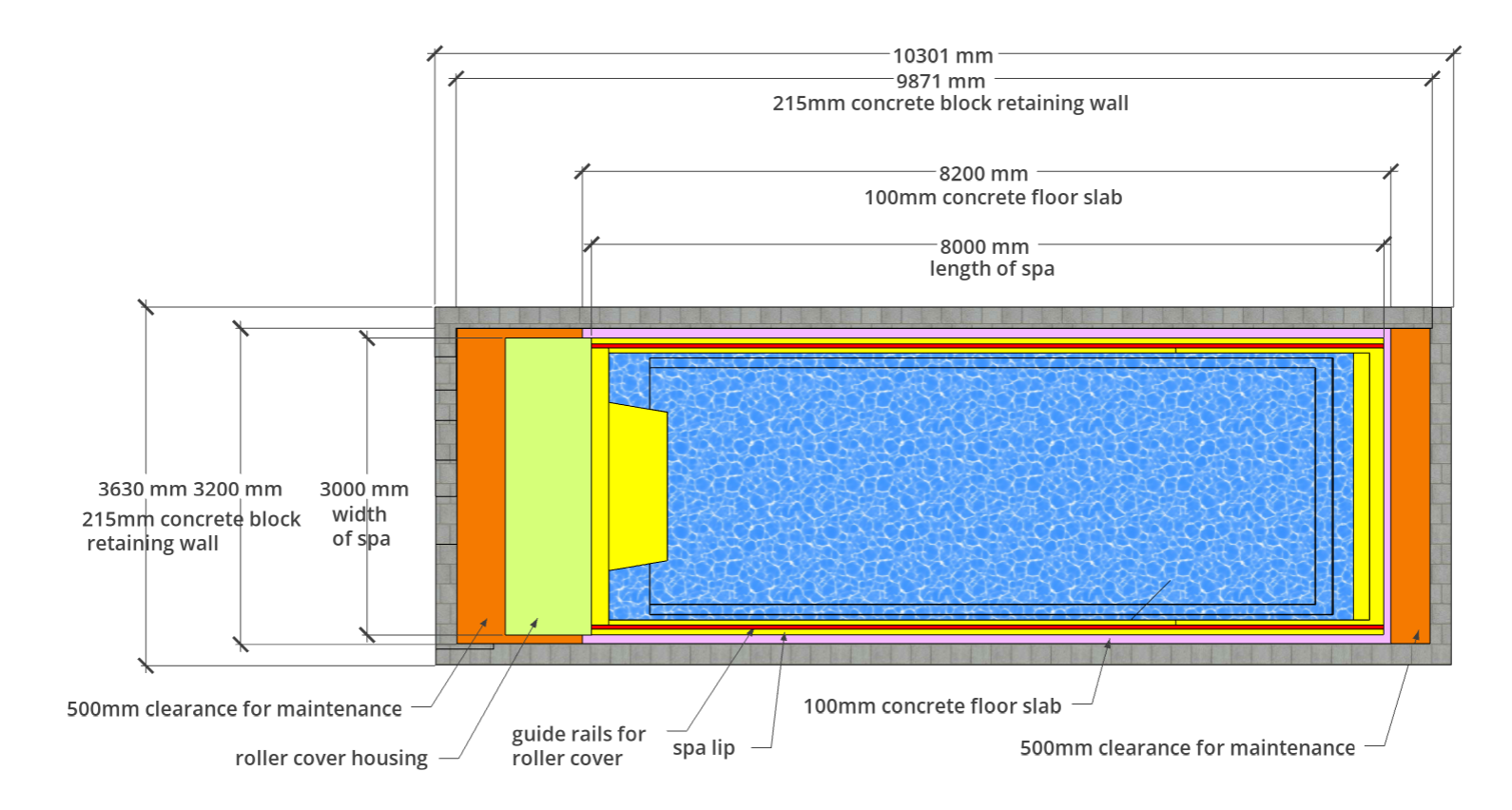

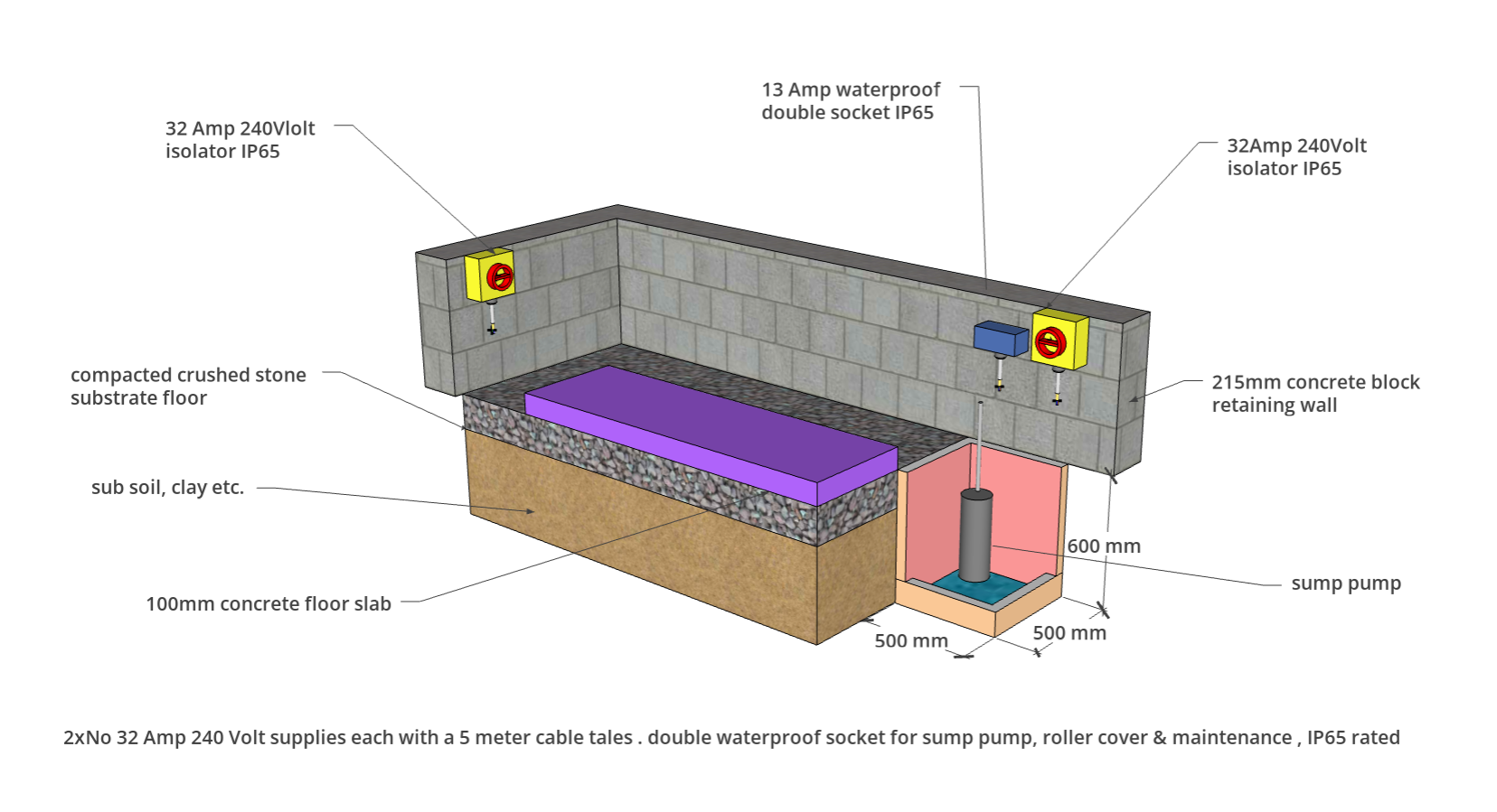

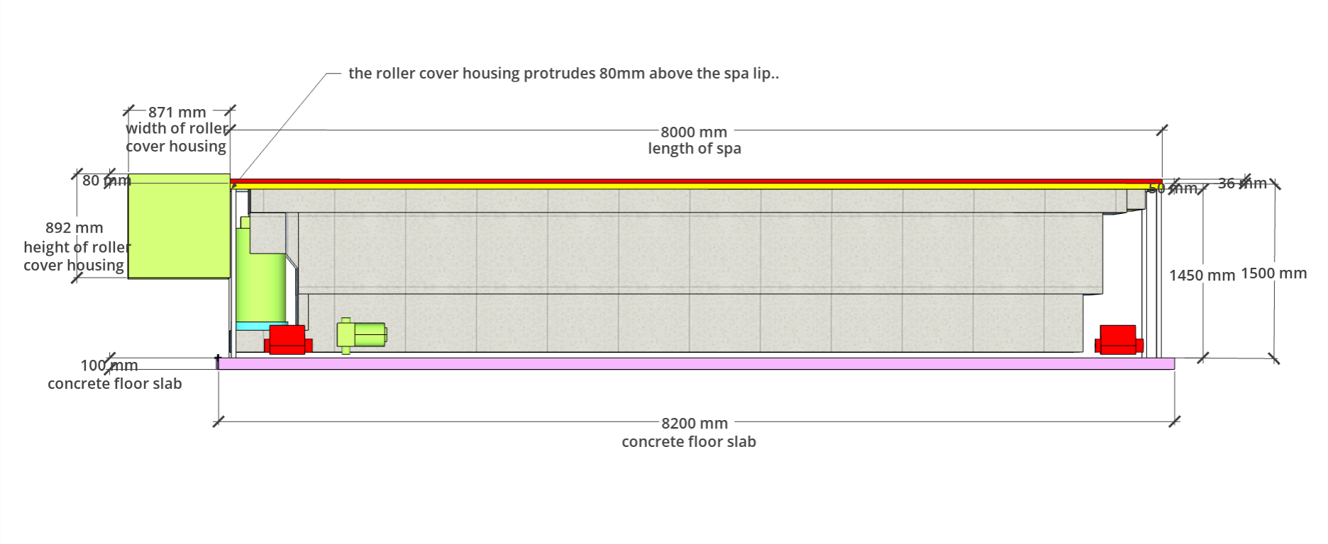

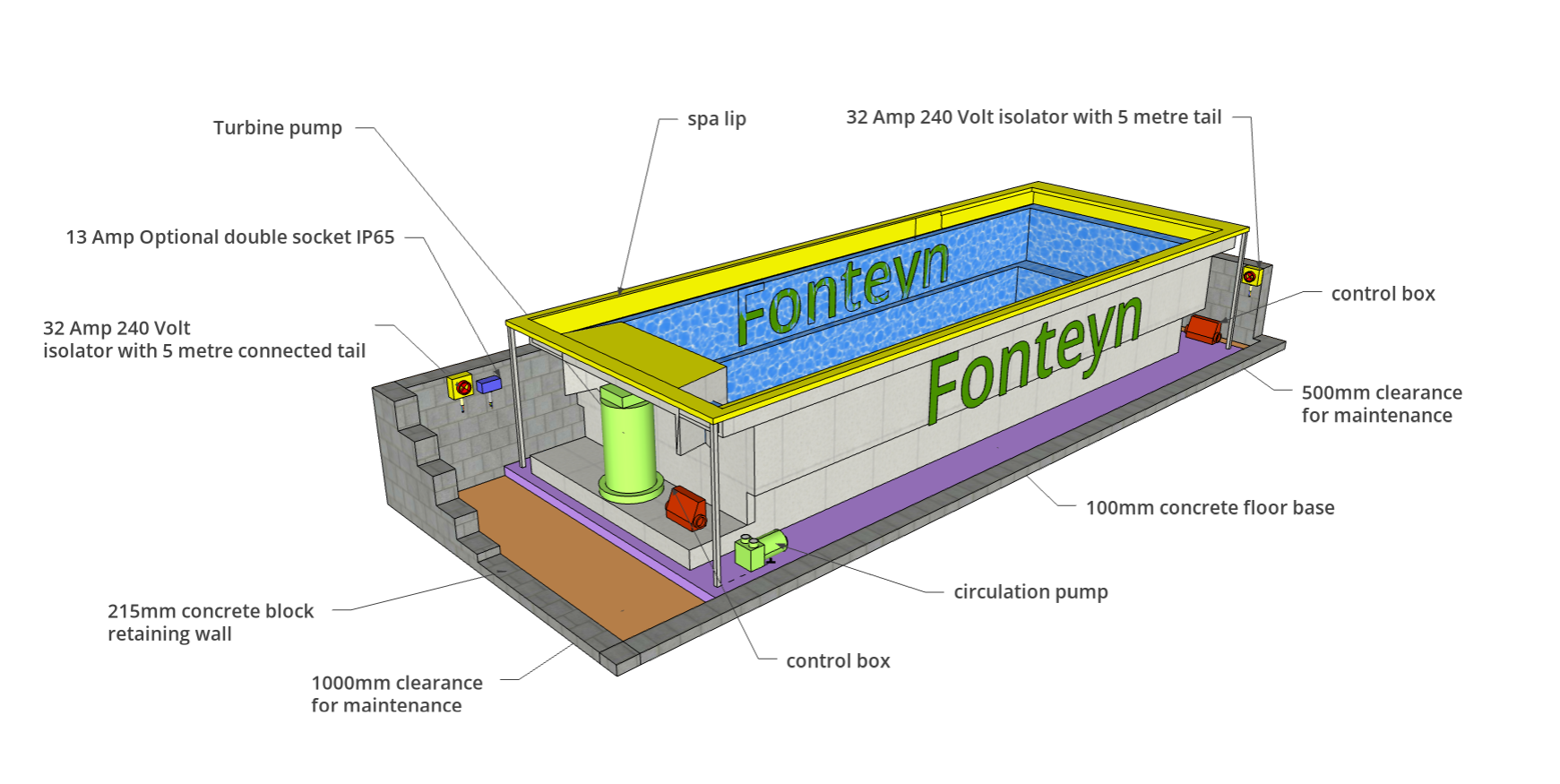

SBMS Posted December 8, 2024 Share Posted December 8, 2024 We're currently considering a (probably crazy) idea of sinking an 8m long x 3m wide x 1.5m swim spa as part of our self build. We've been looking at ones that are entirely self contained, and just 'pop' into a hole in the ground, with a bit of access either end to change pumps etc. The supplier has sent some construction details which basically outline: - a 215mm block retaining wall - a 100mm reinforced concrete slab - a soakaway and sump pump I asked whether any form of waterproofing would be required, and was told generally no. Likewise no shuttering etc. Am I missing something, or being incredibly naive to think we just dig a hole, build a wall and pour a reinforced slab? This is indoors. I've attached the details sent by the supplier. 1 Link to comment Share on other sites More sharing options...

SBMS Posted December 8, 2024 Author Share Posted December 8, 2024 Just now, Pocster said: I really really like ! . Haven’t got a clue - but it’s not crazy - just awesome ( until it gets wee’d in ) . Thanks @Pocster. I got a quote for a pool and fell off my chair. Then found this which is a fraction of the price... Its just the groundworks I'm clueless about. The builder can't believe it's as straightforward as they suggest (he keeps asking what's keeping the water out - whatever that means) and he's asking if it's not more like a 'mini basement' (which is £££).. 1 Link to comment Share on other sites More sharing options...

SBMS Posted December 8, 2024 Author Share Posted December 8, 2024 6 minutes ago, Pocster said: Well ! My house is underground and indeed I dug a big hole . Concrete slab and retaining walls . When it rained , it held water like a (expletive deleted)ing swimming pool ! I assume you want heated though ? So some insulation and ‘waterproofing’ of some kind surely ? . Entertain me - what was the quote for a ‘proper’ pool ? 😊 8m x 4m was £117k... without a cover and 1 light. This is an 8x3 with an electric roller cover, heat pump, a proper swim turbine and 20 odd jets (hot tub style) as well for £41k... 1 Link to comment Share on other sites More sharing options...

SBMS Posted December 8, 2024 Author Share Posted December 8, 2024 Just now, Pocster said: Yeah it is just the shell . When I think what they do abroad ( like in Spain ) is just a concrete pour and then tiled - admittedly that is outdoors - just thinking of a potential leak ! I was thinking of concrete retaining wall, lined with maybe 150mm PIR, and then a concrete base - not sure if PIR in the base would make much difference to heat loss? Any engineers out there? 1 Link to comment Share on other sites More sharing options...
Pocster Posted December 8, 2024 Share Posted December 8, 2024 Just now, SBMS said: I was thinking of concrete retaining wall, lined with maybe 150mm PIR, and then a concrete base - not sure if PIR in the base would make much difference to heat loss? Any engineers out there? Proper help will be along soon 😊 I just saw you pop up in ‘new posts’ and thought it was cool as (expletive deleted) . It undoubtedly can be done for a lot less than those mental ‘proper’ pools . Might be a nice learning curve . Naive is good . It means you don’t understand the implications and do it anyway . Speaking from experience here ! 😂 Link to comment Share on other sites More sharing options...

saveasteading Posted December 8, 2024 Share Posted December 8, 2024 A readymade tank is a good idea. It doesn't leak and doesn't crack. The slab and base need to be strong, and you need retaining walls for the pit. It's a basement though and will fill with groundwater. When you empty the pool it will float up so clever design needed. A concrete tank needs skilled design and construction or it will leak. In med spain the ground is hard and dry and doesnt move so they get away with rough concrete...most of the time. 1 Link to comment Share on other sites More sharing options...

Pocster Posted December 8, 2024 Share Posted December 8, 2024 24 minutes ago, saveasteading said: A readymade tank is a good idea. It doesn't leak and doesn't crack. The slab and base need to be strong, and you need retaining walls for the pit. It's a basement though and will fill with groundwater. When you empty the pool it will float up so clever design needed. A concrete tank needs skilled design and construction or it will leak. In med spain the ground is hard and dry and doesnt move so they get away with rough concrete...most of the time. “ An adult has entered the conversation “ Link to comment Share on other sites More sharing options...

SBMS Posted December 8, 2024 Author Share Posted December 8, 2024 (edited) 27 minutes ago, saveasteading said: A readymade tank is a good idea. It doesn't leak and doesn't crack. The slab and base need to be strong, and you need retaining walls for the pit. It's a basement though and will fill with groundwater. When you empty the pool it will float up so clever design needed. A concrete tank needs skilled design and construction or it will leak. In med spain the ground is hard and dry and doesnt move so they get away with rough concrete...most of the time. So the "build some retaining walls out of blockwork and reinforced base slab" doesn't cut it? If there's a sump pump pumping out the water would that do it? Or would you recommend a fully waterproofed design? Edited December 8, 2024 by SBMS Link to comment Share on other sites More sharing options...
