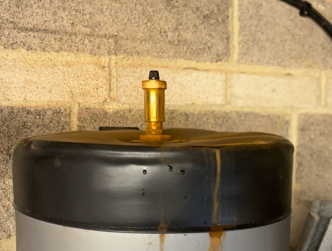

LEL Posted December 7, 2024 Posted December 7, 2024 HI All, i have an LG 14kw ashp powering hot water and central heating in a 5/6 bedroom house approx 350sqm, i have not issues with the hot water side of things, this works perfectly however, the central heating side gives me issues! when the system works well its great and keeps the house warm but at the moment, once or twice a week the buffer tank which is a 50l cordivari version seems to vent all the central heating system pressure out of of the aav at the top. i have changed the valve a couple of times but still have the same issue, anyone have any ideas what the issue/s might be?
JohnMo Posted December 7, 2024 Posted December 7, 2024 Do you close the cap at the top to close the AVV off? Post a pic of what you have and where the issue is.

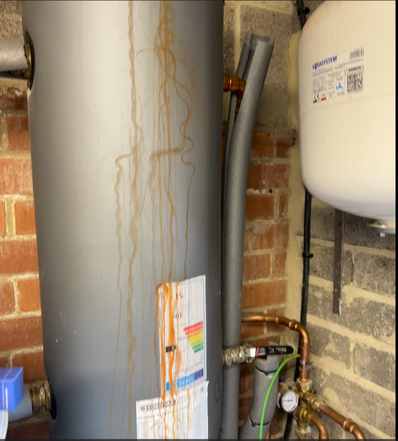

LEL Posted December 8, 2024 Author Posted December 8, 2024 hi yes, the valve is closed and then backed off a half turn to allow for bleeding automatically, pictures of the offending article is attached now
Nickfromwales Posted December 8, 2024 Posted December 8, 2024 The system needs to be flushed and treated, there’s a worrying amount of ferrous oxide present! This will routinely knacker ever new AAV that you install, so don’t waste time with fitting any more replacements until the cause for their failure is resolved. I wonder if this was ever treated with inhibitor?! How old is the system?
LEL Posted December 9, 2024 Author Posted December 9, 2024 @Nickfromwales thank you for the comment, there does appear to be a lot of build up, i don't think the system was inhibited after installation until just recently, the installer turned out to be an opportunistic cowboy in the end! the system has been in about 4 years. would you suggest a full heating system power flush, replace the aav, inhibit and then run back up and see what happens?
Nickfromwales Posted December 9, 2024 Posted December 9, 2024 1 hour ago, LEL said: @Nickfromwales thank you for the comment, there does appear to be a lot of build up, i don't think the system was inhibited after installation until just recently, the installer turned out to be an opportunistic cowboy in the end! the system has been in about 4 years. would you suggest a full heating system power flush, replace the aav, inhibit and then run back up and see what happens? Ouch.... This will need to be fully chemically flushed to get all the crud out, using something like Sentinel X400 LINK and then a cleaner, and then an inhibitor which I would double-dose with. The killer is, that particular buffer is of steel construction, so without an inhibitor the thing has been rotting away nicely...... Is the system all rads, or a mix of rads and UFH / all UFH?
