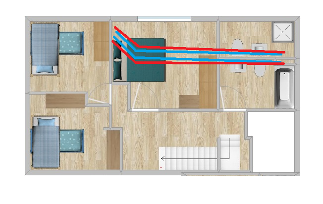

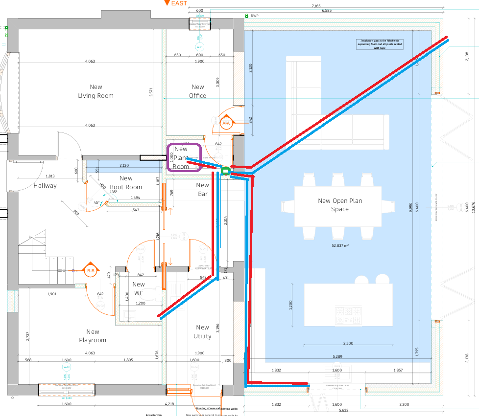

Posted
Sorry for the delayed response, ill kids :(
thanks @JohnMo & @Nickfromwales
Here are some sketches. I do not have a proper floor plan for first floor unfortunately.
I plan to feed my new cold water main (green square) into the plant room which is located at the centre of the ground floor, my house will be 10m wide x 11m deep on ground floor, and 10m wide x 6m deep on 1st floor. There is no plan to put in a hot circuit.
The plant room will also house my hot water cylinder, the purple square.
The approx run lengths, including verticals, to these rooms are as follows;
  1. Kitchen: 12m
    • Kitchen sink, dishwasher, fridge, outdoor taps (h&c)
  2. Outside rear wall: 12m
    • outdoor taps (h&c), shower, future hottub.
  3. Downstairs WC: 8m
    • Basin tap, toilet, future shower
  4. Utility room: 8m
    • Washing machine directly behind WC.
  5. Family bathroom: 8m
    • Basin tap, toilet, bath, shower
  6. En-suite: 8m
    • Basin tap, toilet, shower
Happy to consider individual pipes if a secondary manifold method is the wrong way to go. But it then takes me to 28 feeds + 1 for cylinder all within the plant room and approx 300m of pipe.

Posted
I would just keep it simple
One hot and one cold manifold in plant room. Then one of the two options below.
Option 1. Looks like a 5 port manifold for hot and cold. A single 15mm feed from manifold to each wet room, in hot and cold.  From 15mm pipe in wet rooms, teeing off to users - sink, toilet, shower etc. (this what I did and have seen no issues.
2.  Bigger manifold in plant room, with individual (suitable sized pipes) to each user in the house. So a mix of 10 and 15mm.

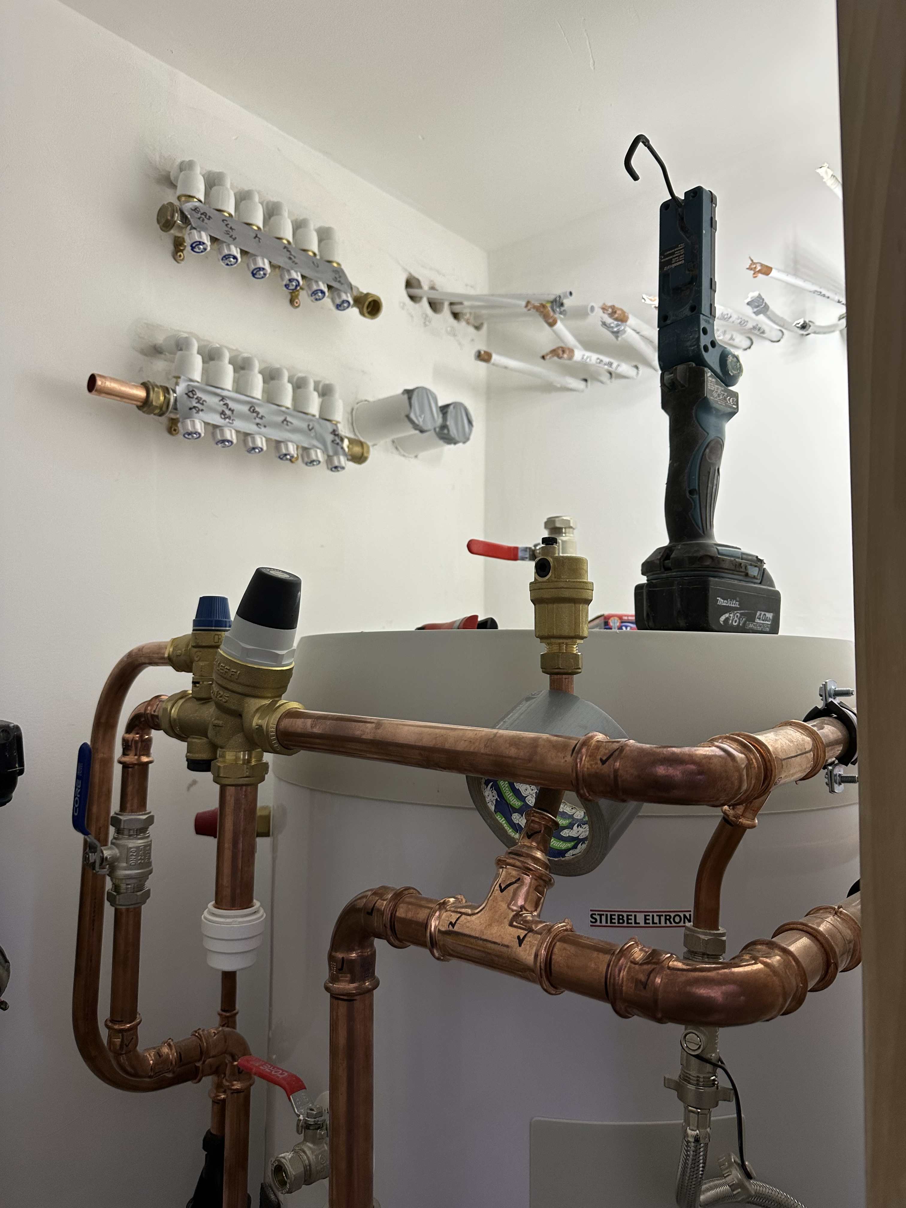

16 hours ago, Sunil237 said:
thanks for the help Nick, I'll be going with your recommendation and using Hep2o throughout. I'll be using the first manifolds I shared which are Hep2o and then just branching off once in each room with smaller diameter pipes. I figured that the secondary manifolds were probably going to cause more pain than help once the plumber gets into the actually practical fitting!
IMG_1871.thumb.jpeg.d355008fd66bc556cb09ce40014e9564.jpegIMG_1872.thumb.jpeg.29499a27315dcac4a90f741011263e46.jpegIMG_1879.thumb.jpeg.80cd8863f985f1ae2a24ded38c76ae25.jpeg
Some pics of my current project for example 👍

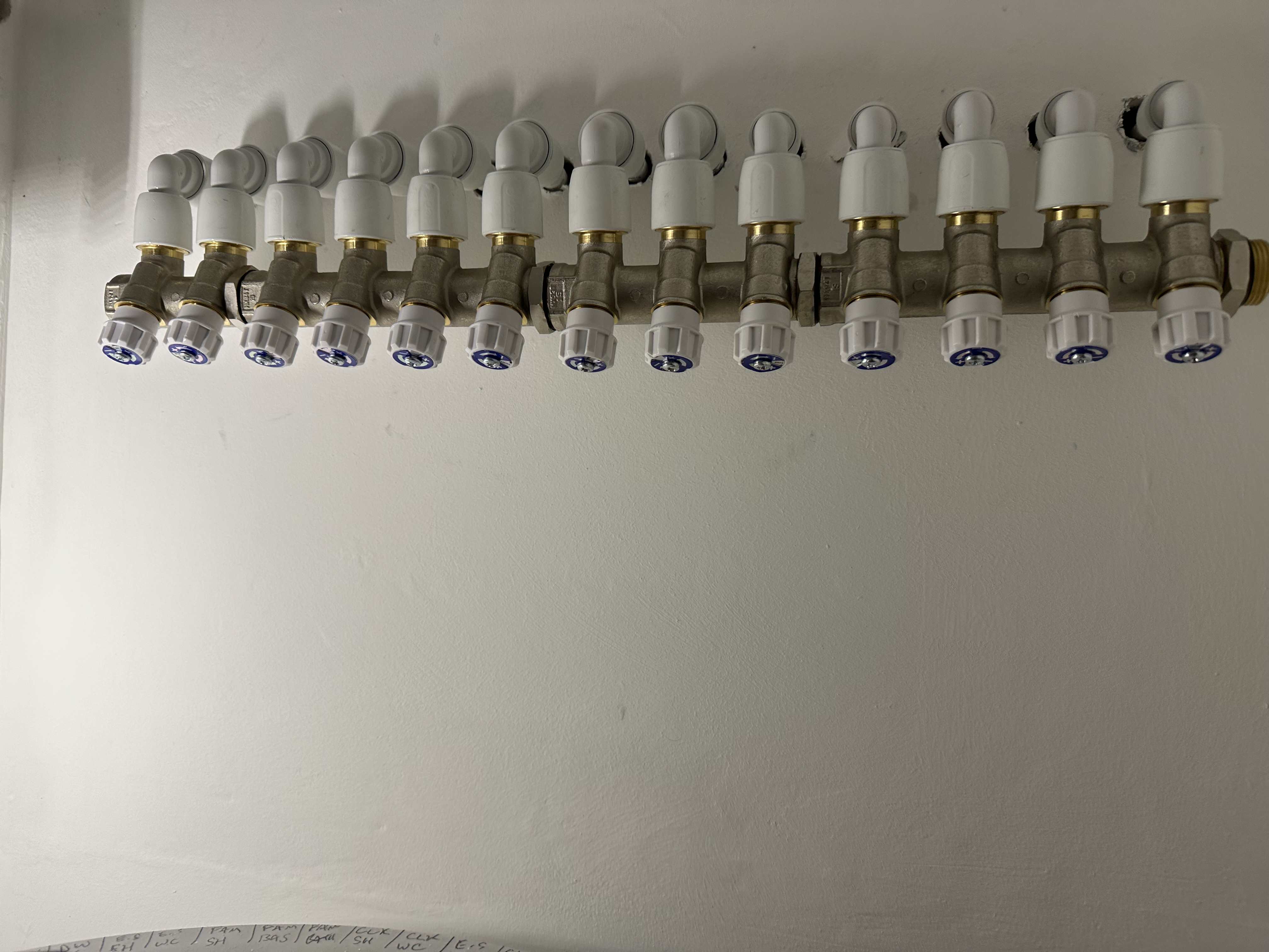

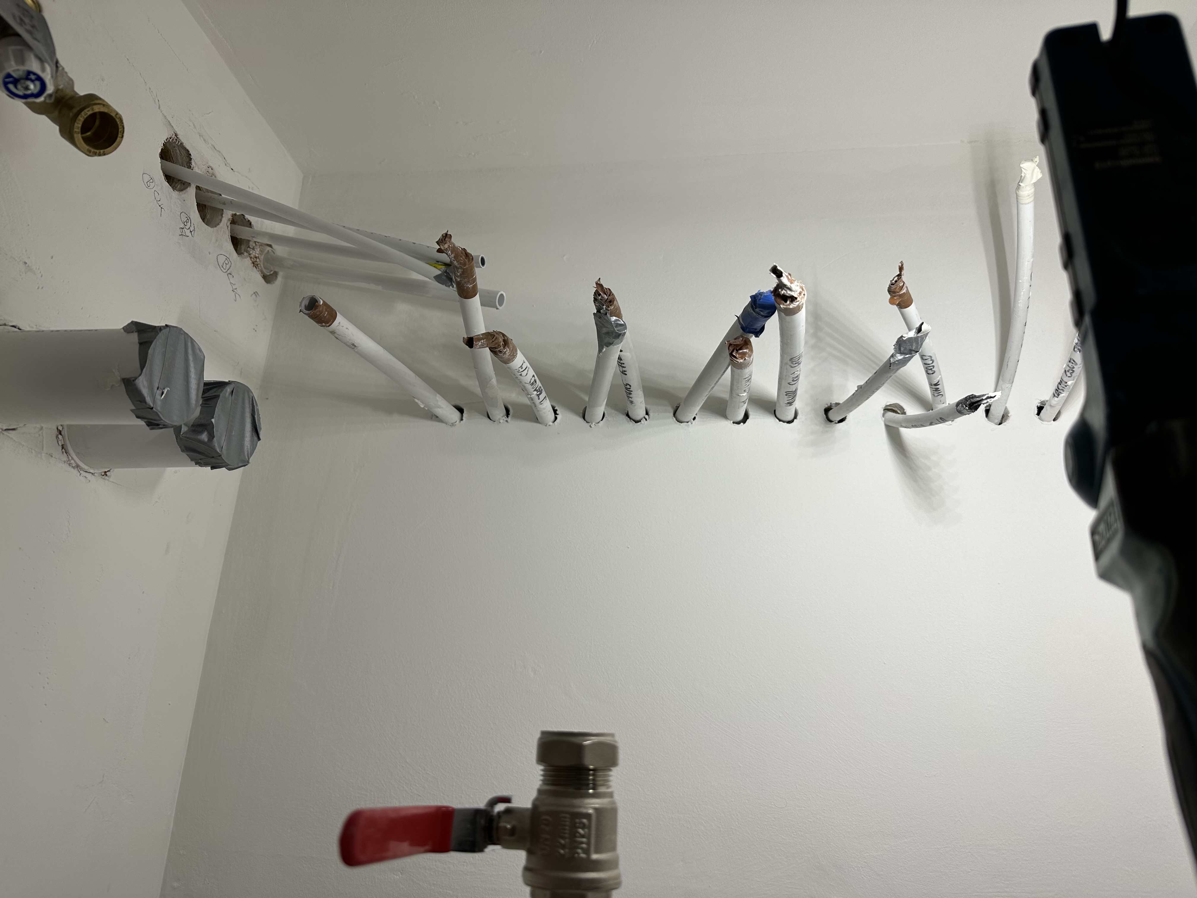

Posted
Thank you @Nickfromwales @torre and @JohnMo
We've completed first fix and I'm super pleased with my water set up ☺️
As I have a joist in the room I can actually box off the pipework, keeping it fairly neat.
I used hep2o manifolds with built in isolation, and regular branching at each room.
The plumber wasn't so convinced that the manifold system will help any but did like that we could isolate the outdoor taps in winter.
I used 22mm and 15mm hep 90 degree bends which the plumber found more useful than he thought they would be.
The manifold bracket looks to have worked great! I see others used Munson clips but I bought the manifold mount just to try.
I realise I've gone against advise here and have 22mm for the hot! Things just got done and I didn't catch on until a bit too late
My components
15mm manifold (2 port, available in 2,3 &4)
22mm manifold (single port)
Manifold mount
15 & 22mm 90 degree bends
3/4 iron to 22m compression 90degree
manifold cap
My plumber changed the end fittings over

Posted
Looks good! The pipe bends (formers) do help get the pipe to go nicely into the fittings after a change in direction.
Every day is a school day, as I didn’t know they made those brackets :/ did the last one ‘stood off’ with Munson rings / bases / and threaded bar.
Thanks for that, I’ll defo look into those from now on, just frustrating that every merchant I’ve purchased from for the last 10+ years have never had these displayed for sale or in the “people who bought this also bought…….” section.

Glad to return some help 😅
My plumber said the bracket fit nicely on the 15mm manifold, but he had to use longer screws for the bracket holding on the 22mm manifold as it wasn't designed for that size
