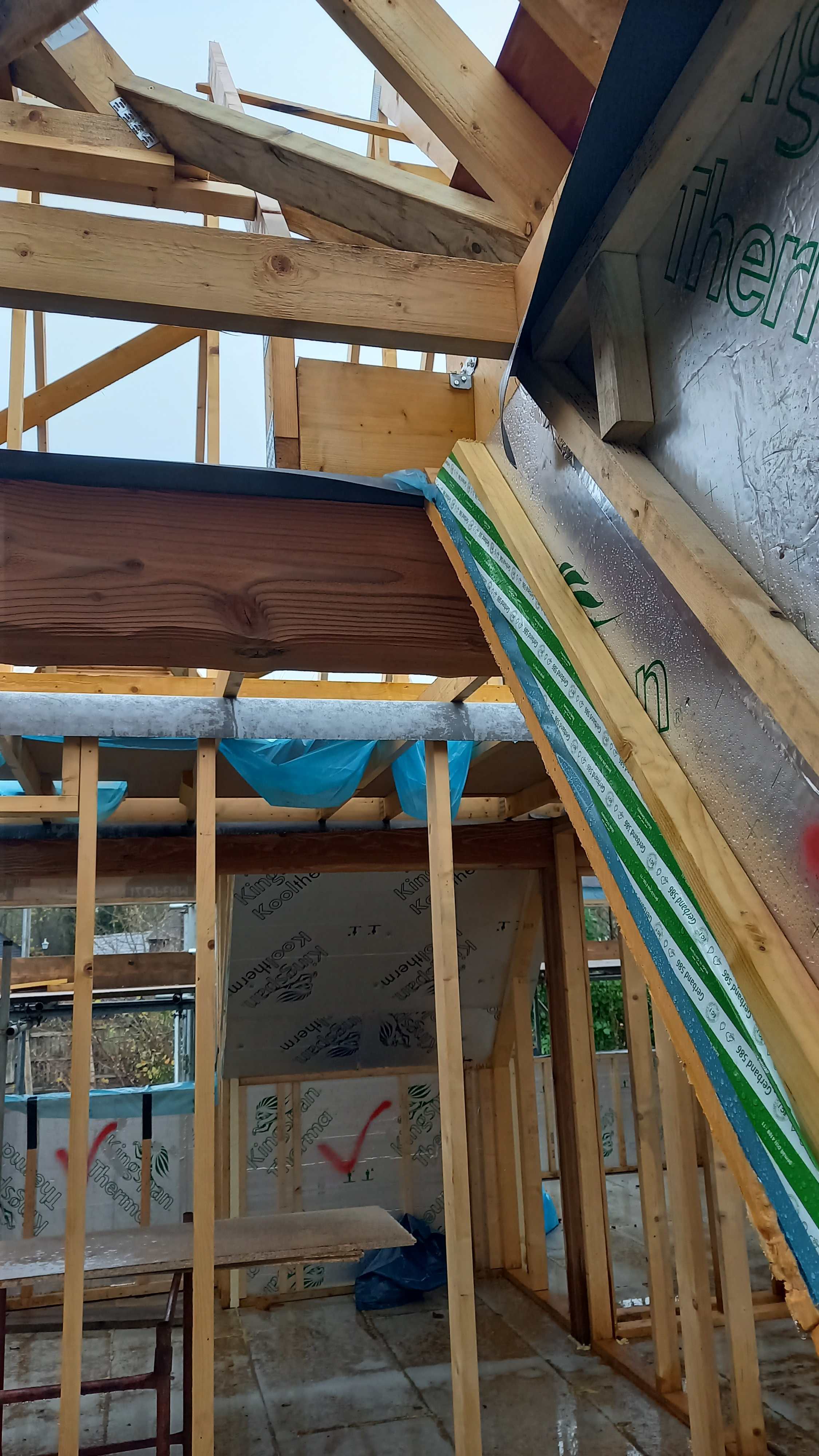

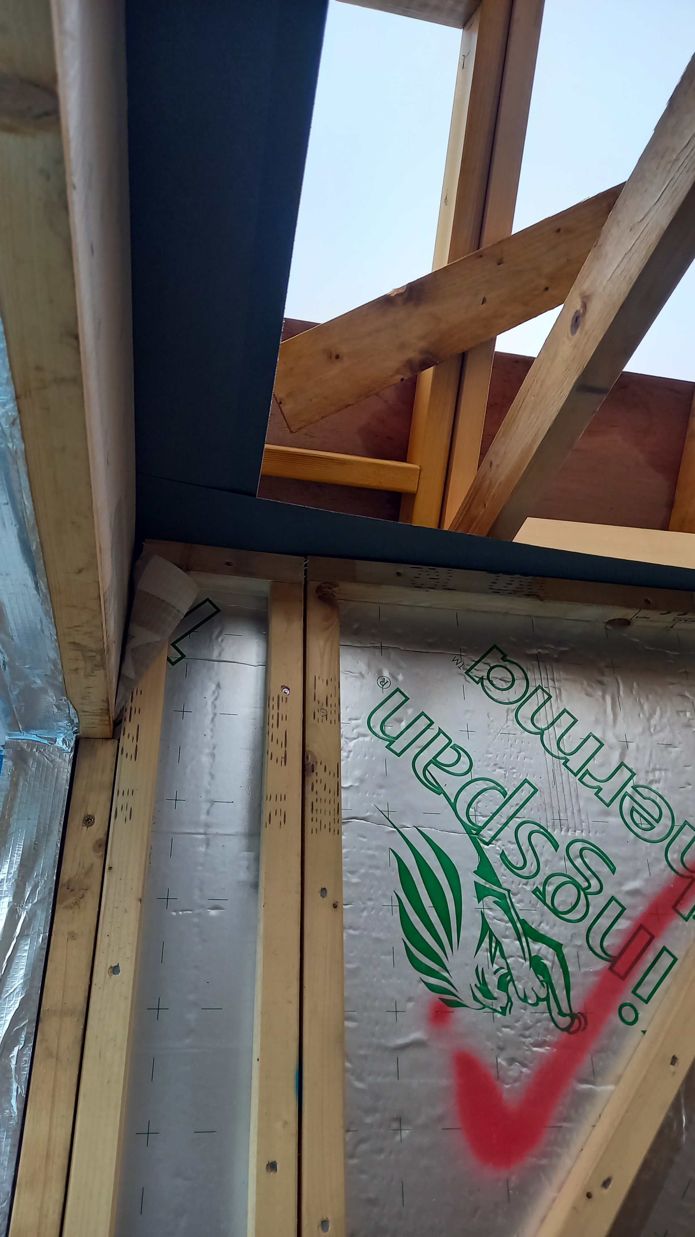

Post and beam Posted Monday at 14:38 Share Posted Monday at 14:38 The TF frame erectors have left airtightness membrane visible at the tops of the studwork and feature beams on the first floor. I conclude that the loft space is not regarded as part of the airtight envelope. I do not understand what i need to do next to maintain this envelope. I could of course tape membrane to the existing across the entire ceiling prior to the plasterboard being installed. This does not seem to be the correct approach though, i guess i have misunderstood something. #a: because the lighting installations would subsequently breach this everywhere and render it useless. What have i misunderstood please? Link to comment Share on other sites More sharing options...

Post and beam Posted yesterday at 15:53 Author Share Posted yesterday at 15:53 Not sure if this is very clear, #1 shows the membrane above one of the beams. This is first floor ceiling. And #2 , the dark shadowy bit, Is the membrane above the studwork that makes up the first floor ceiling. So the perimeter of the first floor ceiling is a continuation of the airtight boundary from below. As stated previously, i could tape to, and continue this membrane across the whole first floor ceiling. No idea if this is the usual practice. But every light pendant would breach it and render useless. My TF frame company are very off hand now and just say ' this is for others'. Perhaps the usual thing is to box out the light pendant locations within the ceiling timbers, carry the membrane to these apertures leaving a smaller area to deal with after the lights are fitted. Any and all practical solutions or experience gratefully taken on board. keith Link to comment Share on other sites More sharing options...
Russell griffiths Posted yesterday at 17:36 Share Posted yesterday at 17:36 You probably need to do a bit of this and a bit of that. your airtight layer needs to be continuous if those beams are on display can you not continue the airtight layer above the beams. do you have a layer of plasterboard sitting on top of those beams. a sketch of what you have is probably a better idea. you might need to build some boxes around the light fixtures. Link to comment Share on other sites More sharing options...
Post and beam Posted 21 hours ago Author Share Posted 21 hours ago The beams will be on show yes. Yes of course the airtight layer needs to continue above the beams. There will be a plasterboard ceiling . The question is.... It appears that the TF design calls for a boundary at the point between the plasteboard ceiling and the horizontals of the roof trusses. (Rather than the upper limits of the roof) so is the usual practice to box around the light fittings? Link to comment Share on other sites More sharing options...
Russell griffiths Posted 10 hours ago Share Posted 10 hours ago Usual practice is to have a service batten and fit low profile lights, there are lots that fit in a 40mm void. but every build is a bit different. you might need to build boxes. you could paint them with an airtight paint, so you only need to tape to the edges. Link to comment Share on other sites More sharing options...

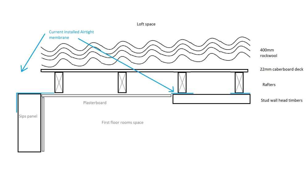

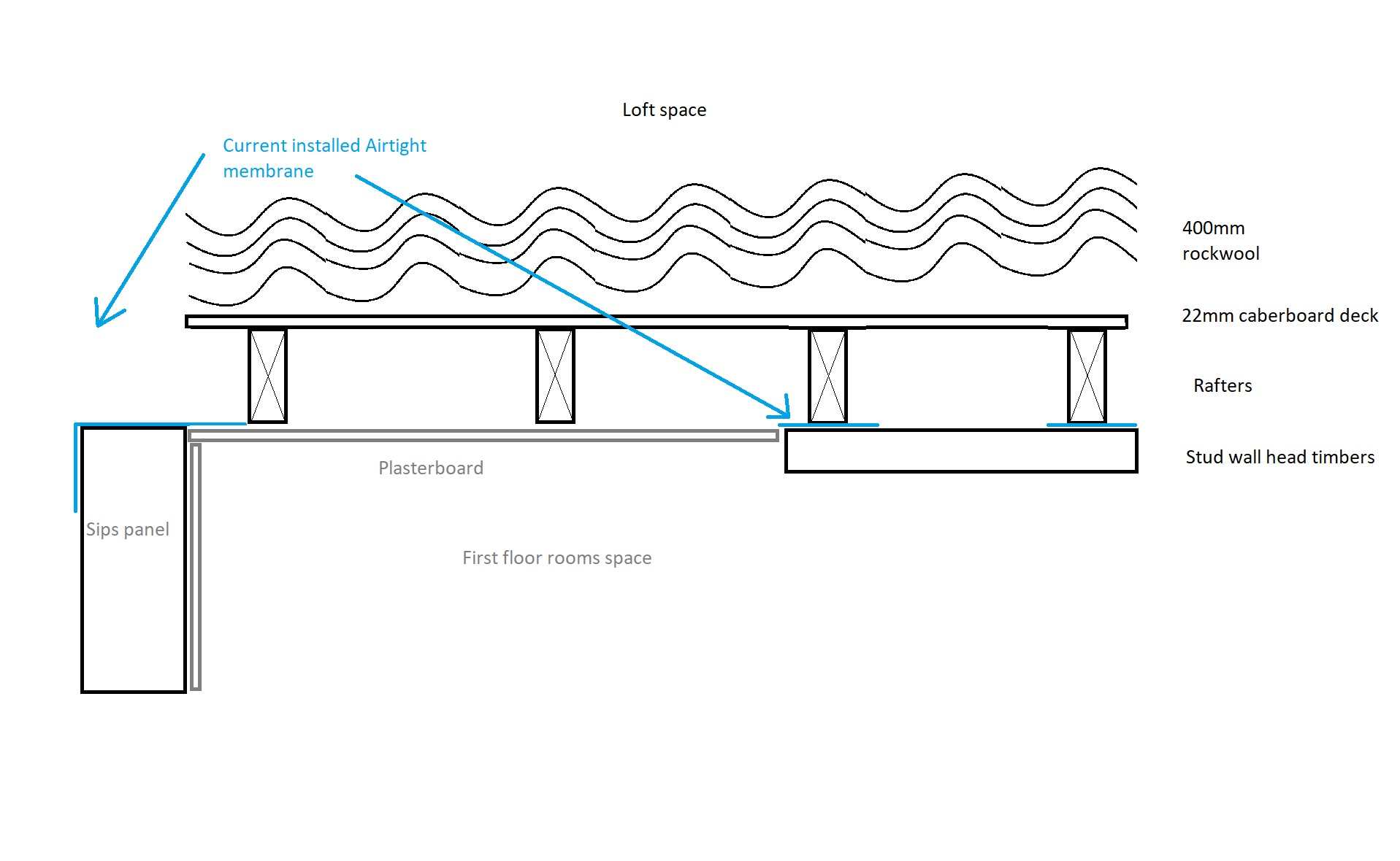

Post and beam Posted 7 hours ago Author Share Posted 7 hours ago My effort to diagram what i have. I have seen descriptions of 'warm roof' that look closer to this than a cold roof design. Notice there is no insulation between the rafters here. Its all above, laid on the deck. Link to comment Share on other sites More sharing options...
Post and beam Posted 5 hours ago Author Share Posted 5 hours ago Having just watched this video, apologies , i tried to just insert a link. At minute 2:15 i now believe i was correct and i do in fact have a warm roof design. This is getting confusing . Link to comment Share on other sites More sharing options...
