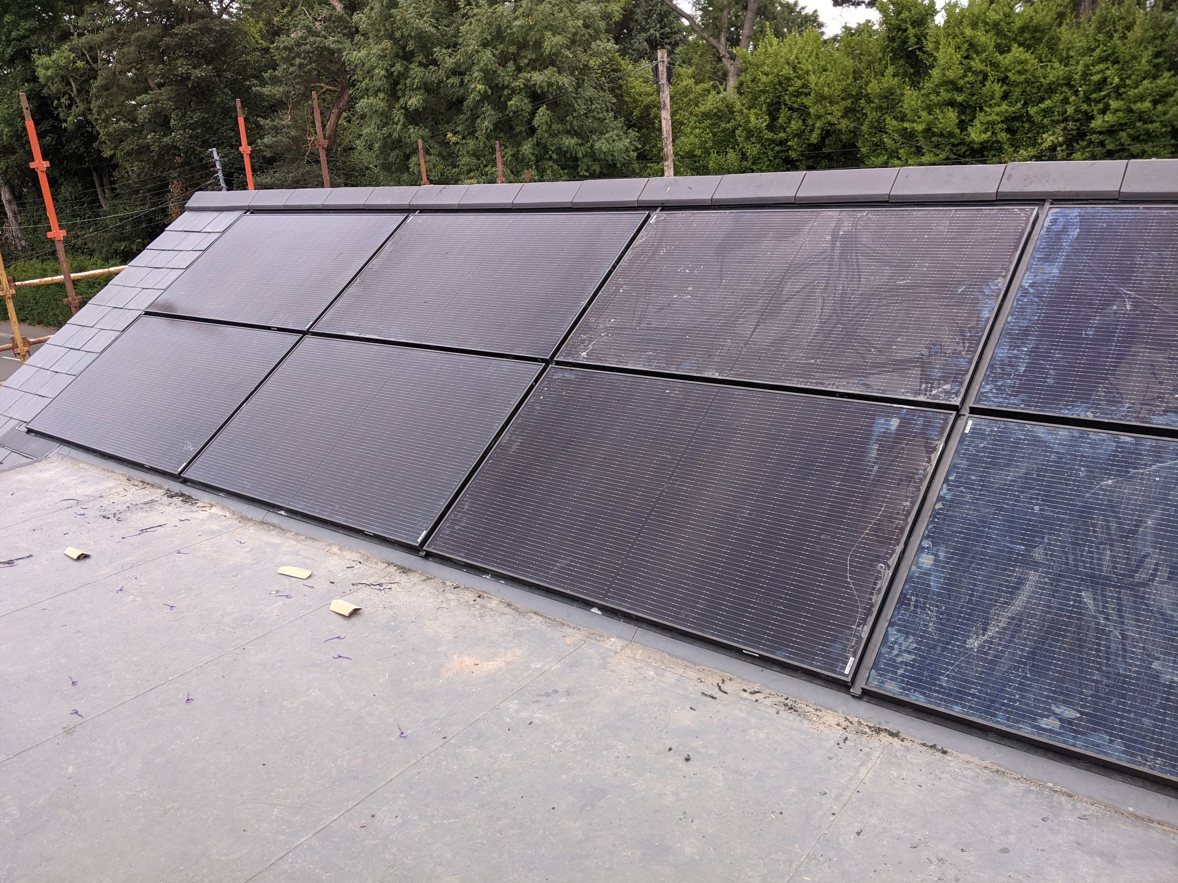

Conor Posted November 26, 2024 Posted November 26, 2024 (edited) MCS comment is for on-roof systems, presumably. The manufacturer instructions trump other guidelines anyway. I ran ours right from the ridge down to the flat roof valley. At ridge I ran the GSE trays up and under the ridge flashing, and at the bottom I had an aluminium upstand made to go under the flat roof covering and under the GSE tray. I'd avoid the flexible GSE flashing for your gutter, use rigid instead. Remember you can lay you panels in landscape. I don't quite follow your pattern. You don't need anything other than what comes with the GSE kit. Just extra 100mm battens for the fixing points, as per instructions. Edited November 26, 2024 by Conor 1

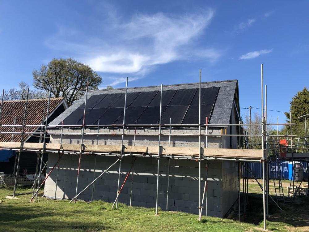

Nick Laslett Posted November 26, 2024 Posted November 26, 2024 I agree with @Conor, just follow GSE installation instructions. I self installed my panels on GSE trays down to the gutter, my MCS certified electrician had no issues with what I had done. GSE have wind loading tables to assist installation.

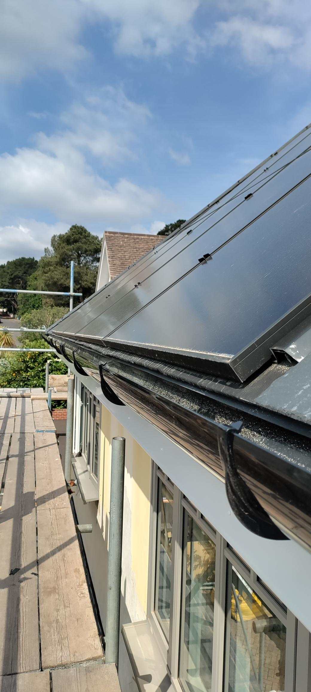

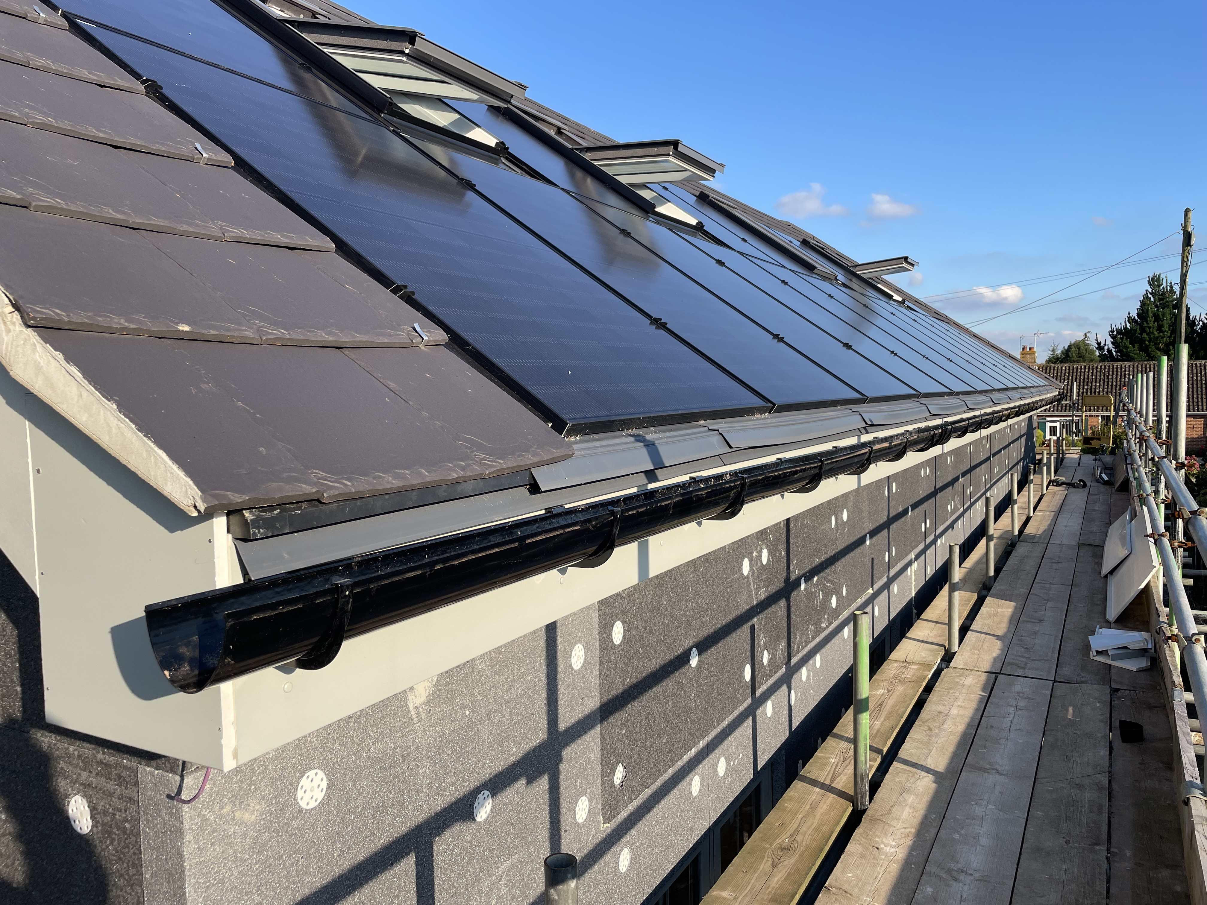

sgt_woulds Posted November 26, 2024 Posted November 26, 2024 Don't forget to check that your clamps will fall within the clamping zones specified by the panel manufacturer too. Clamps outside these zones may invalidate any warranty and may stress the cells/glass, and the frame may not provide the necessary uplift resistance. Not all solar panels can be clamped on the short sides - best to check. One thing to factor in when installing direct to the gutter - water rushes quicker down non-stick glass than other roofing materials and a large PV array can cause undersized gutters to overflow. Based on my own experience - and pessimism about future weather patterns - I would recommend deep flow gutters in general but certainly in this scenario.

Greeners Posted November 26, 2024 Author Posted November 26, 2024 (edited) Quote I'd avoid the flexible GSE flashing for your gutter, use rigid instead. @Conor your alu trim looks good @Liam Jones said he used a double eaves tray arrangement and it looked like a clean finish Edited November 26, 2024 by Greeners
Greeners Posted November 26, 2024 Author Posted November 26, 2024 @sgt_woulds your comment about deep flow gutters - it's great to have this kind of real world input, thanks
Greeners Posted November 26, 2024 Author Posted November 26, 2024 Thanks @LiamJones that's great to see the detail of the double eaves tray and deep flow gutter, looks like an excellent solution. I see you have EWI fitted - that's the next and last-ish of the big projects for me. Part of the roof refurb was to accommodate deeper soffits. I have lots of questions on this, but one thing at a time! 1

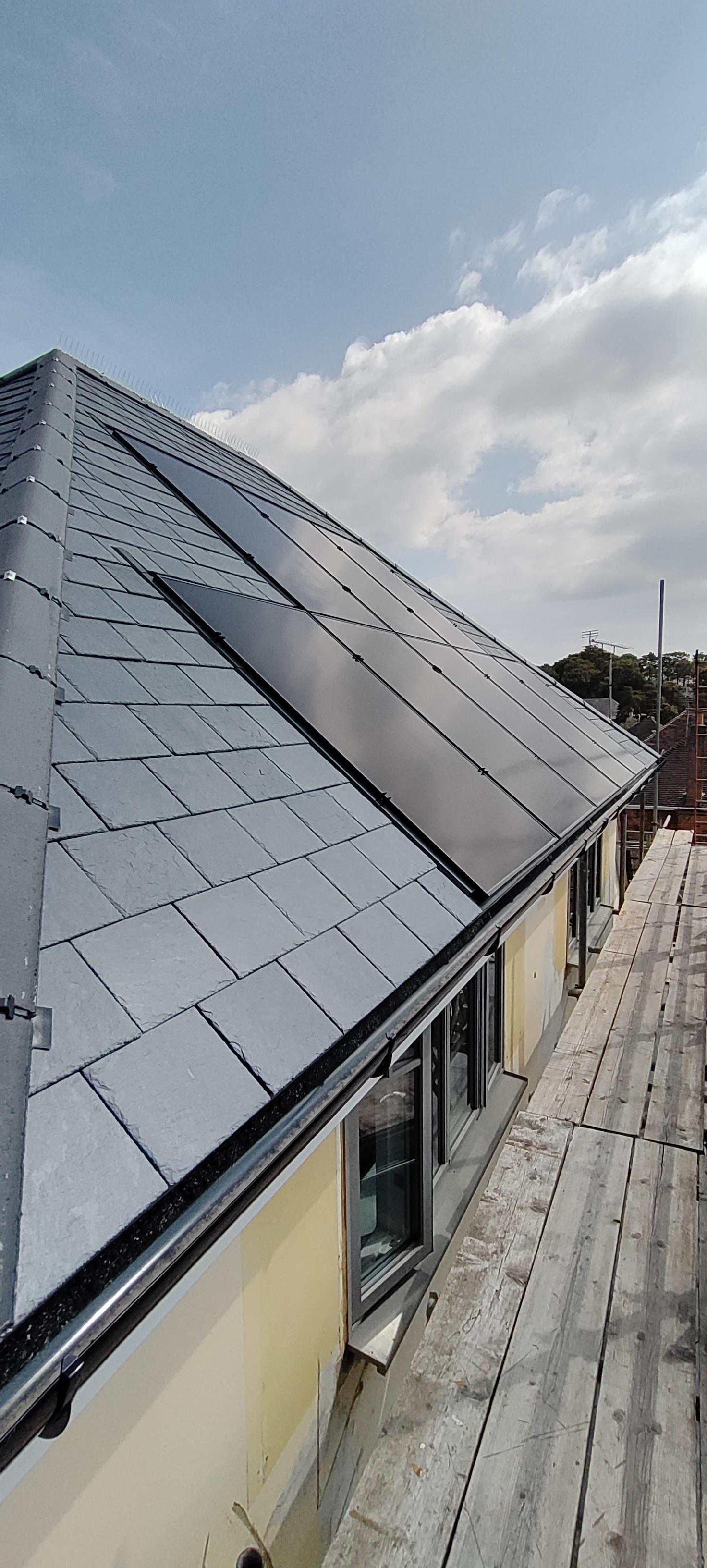

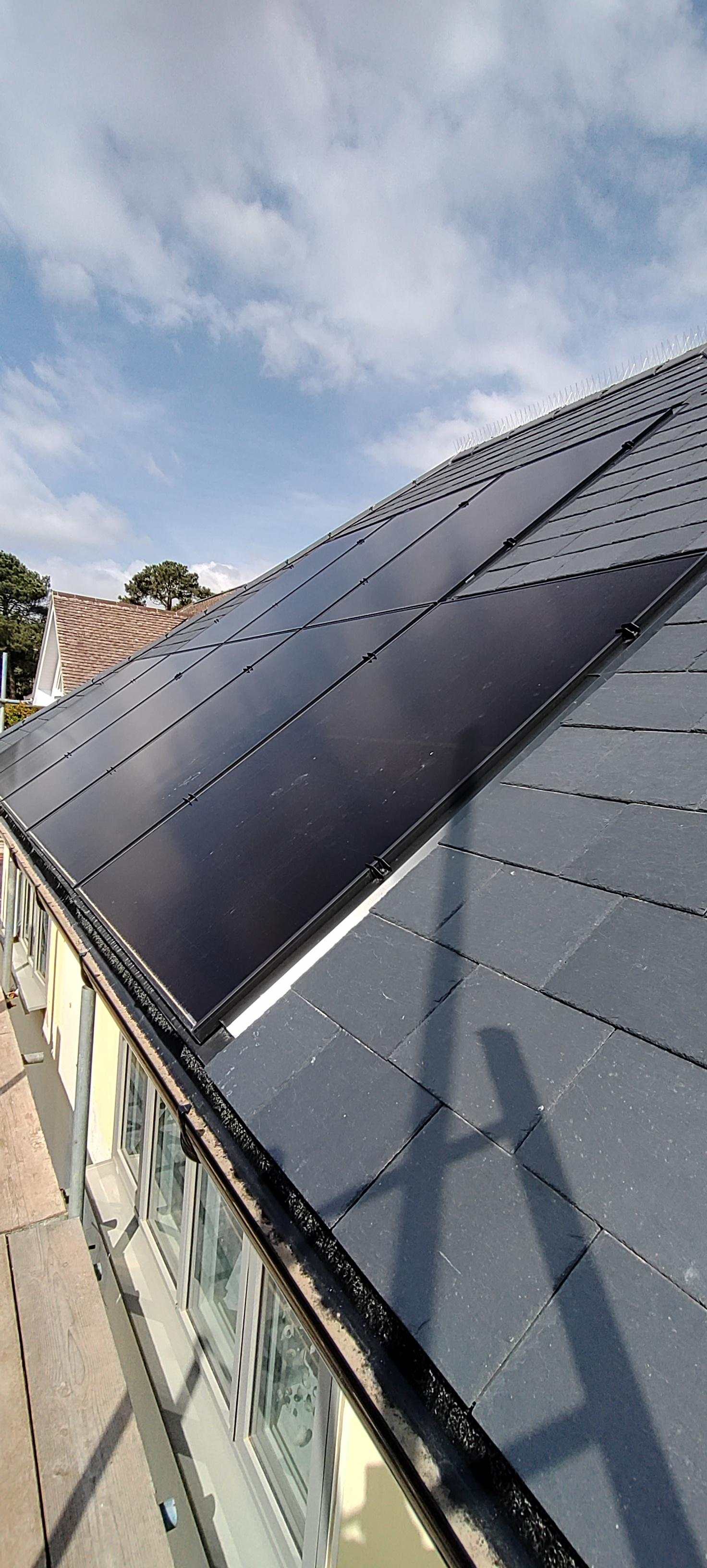

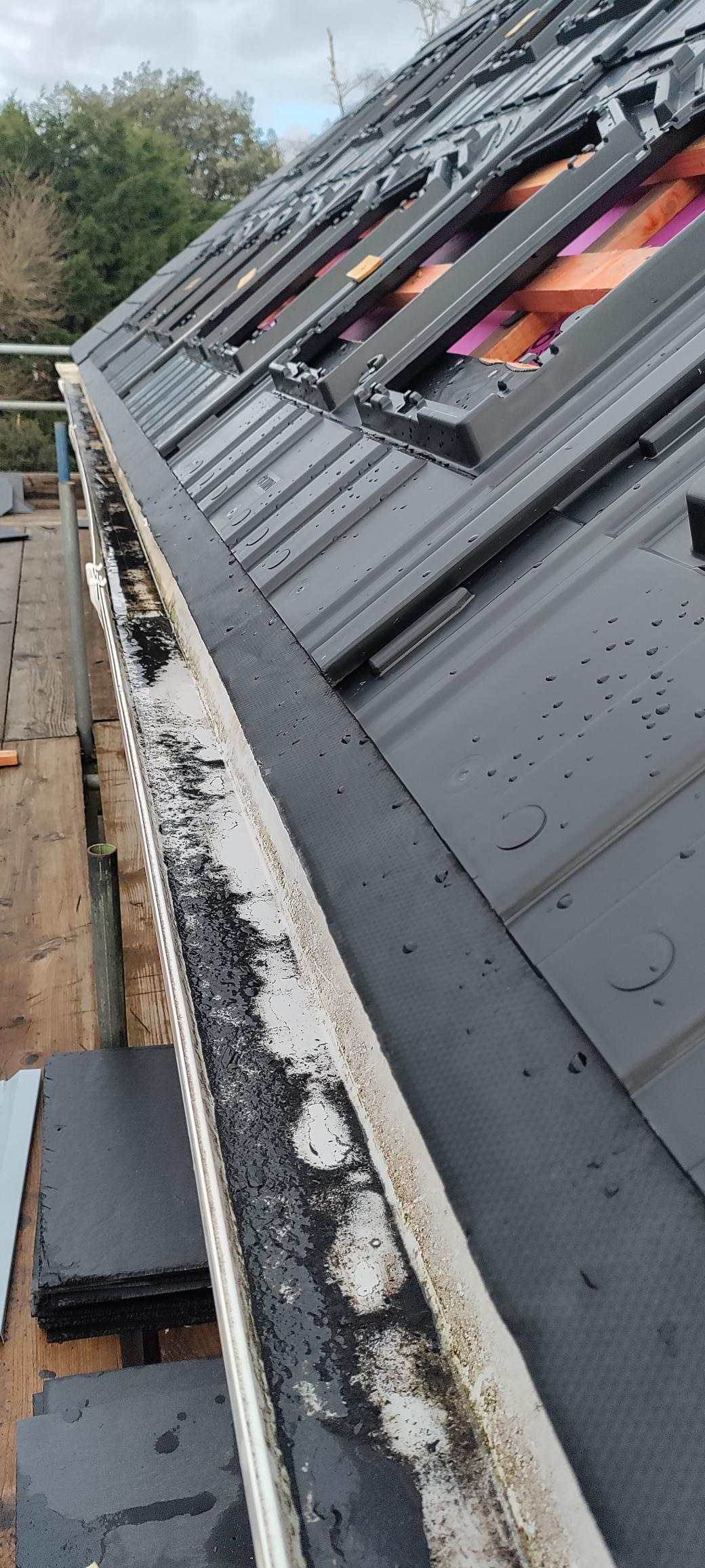

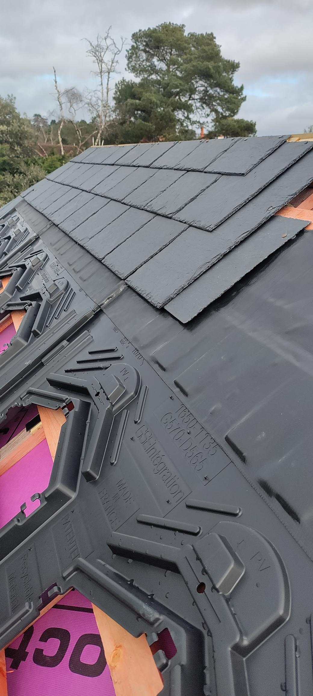

Greeners Posted May 23, 2025 Author Posted May 23, 2025 Quick update with photos. The panels are self installed and the inverter will be wired up by an electrician with the right ticket. The local DNO asked for some paperwork for the inverter I chose, but apart from that, it was surprisingly plain sailing to get the G99 thanks to a lot of advice on here. Thanks to all who helped in the planning / head scratching phase! 2

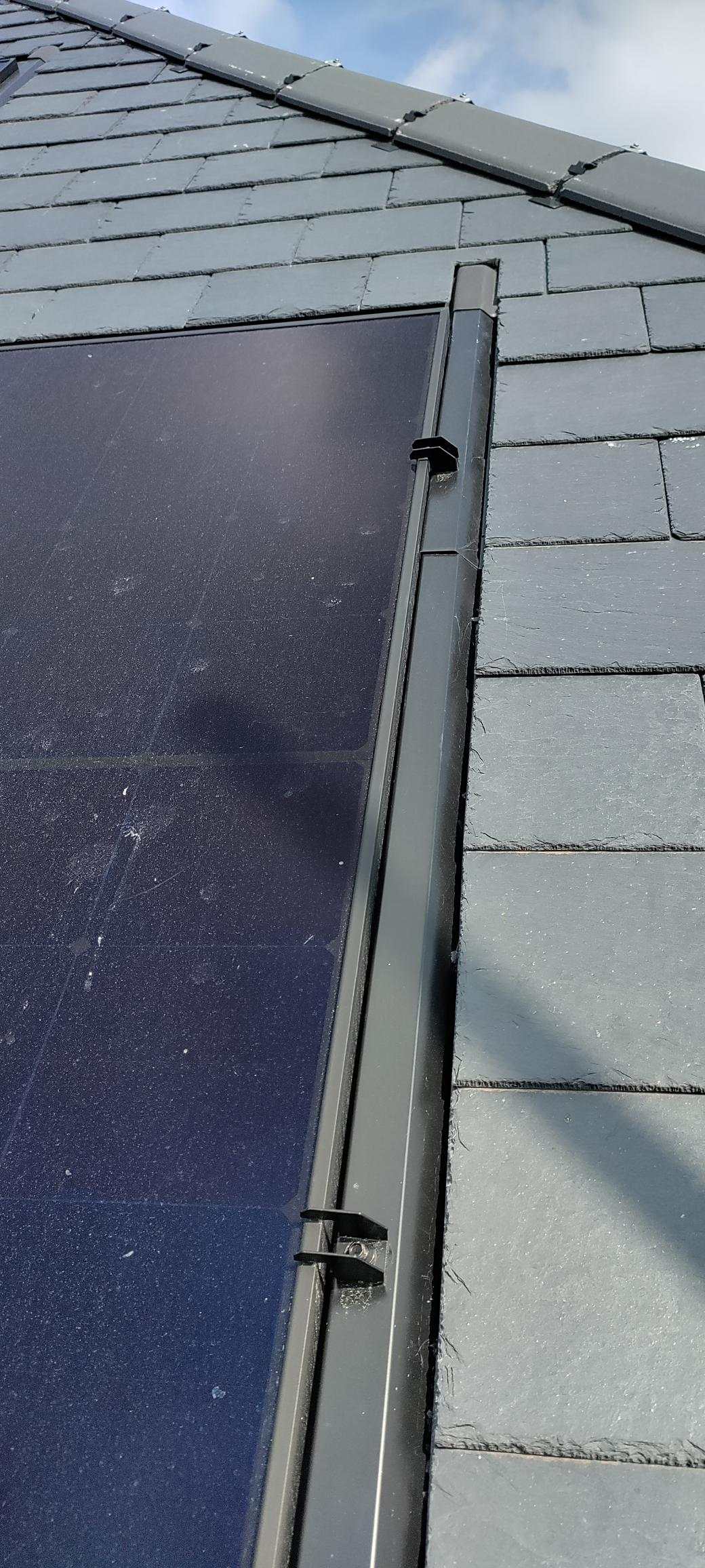

LiamJones Posted May 23, 2025 Posted May 23, 2025 Looking very smart, what eaves detail did you use in the end? And what the detail above the top corner of the array? Lead flashing that was too high, so cut the tile round it?

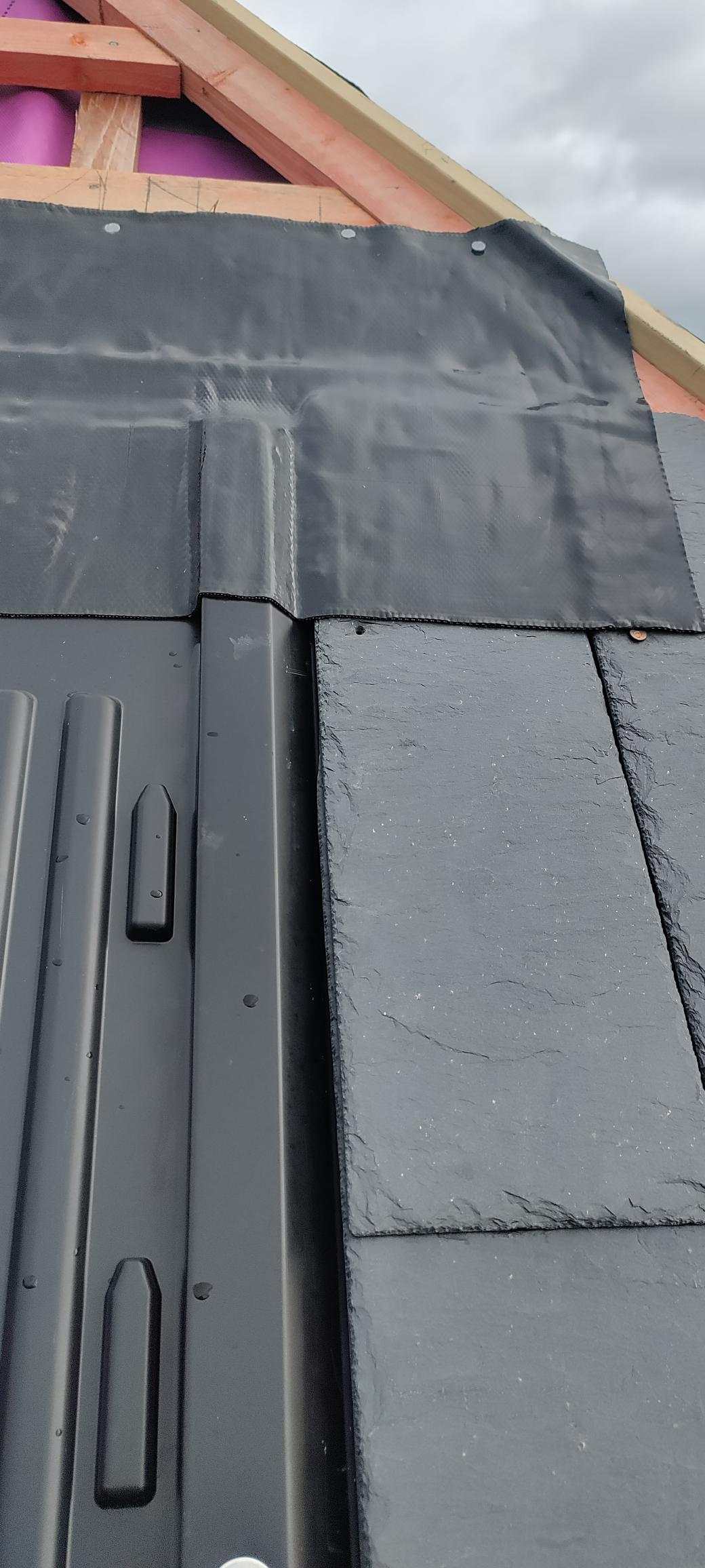

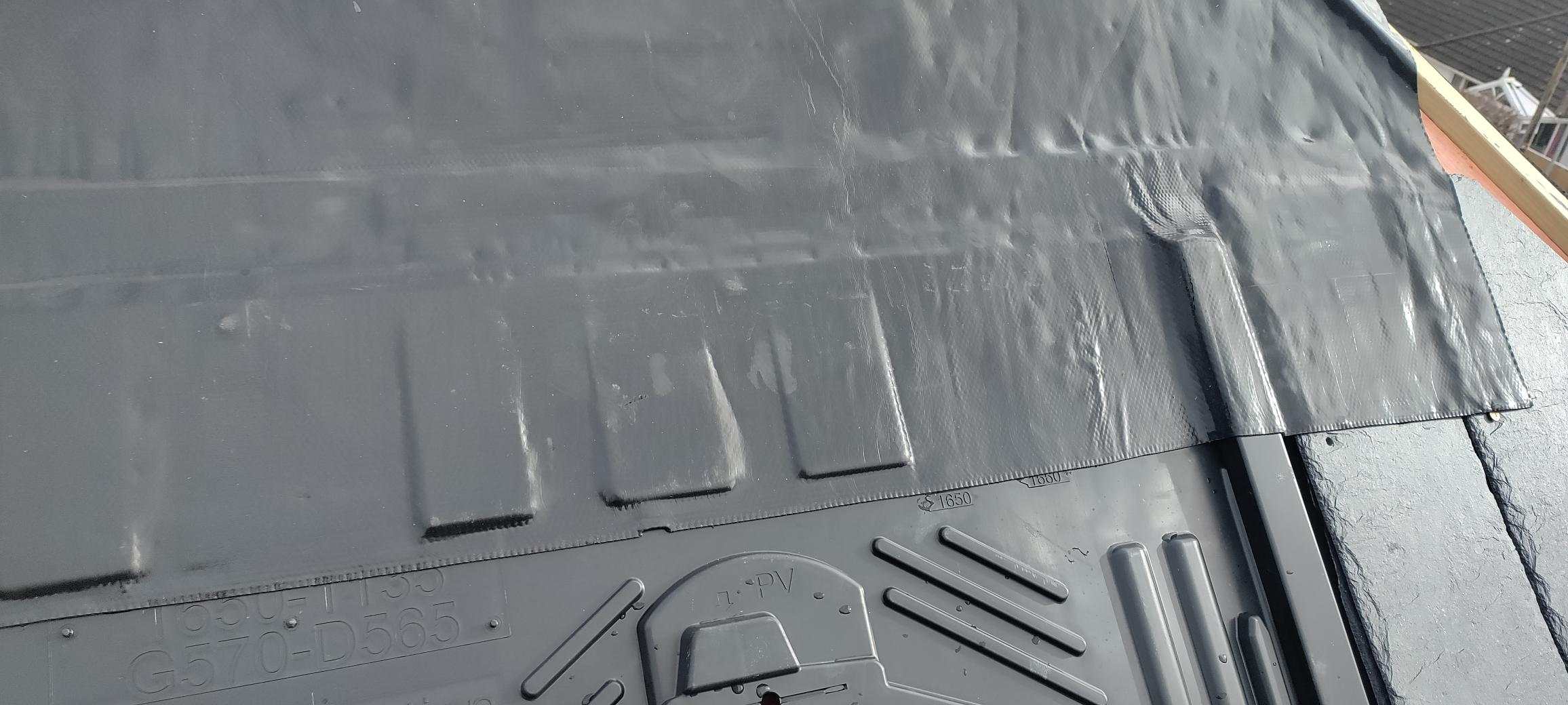

Greeners Posted May 30, 2025 Author Posted May 30, 2025 (edited) Thanks! On the eaves tray we put a soldier course of slates to create the edge, then laid the lead replacement flashing over. The top corner cut around was what happened when I went out and left the roofer to do his thing - he felt that keeping tight to the tray and losing the aluminium flashing on the sides would look best. Same on the top edge hence the cut around to keep the slate edge close to the panel. I was a bit surprised to begin with but, I think it looks quite good now. We'll see how well the single slate on the edge stays in position long term. I'm getting voltage through the pv but they're not grid connected yet, waiting for EWI to hang the inverter on outside. Edited May 30, 2025 by Greeners Incorrect image display 1
