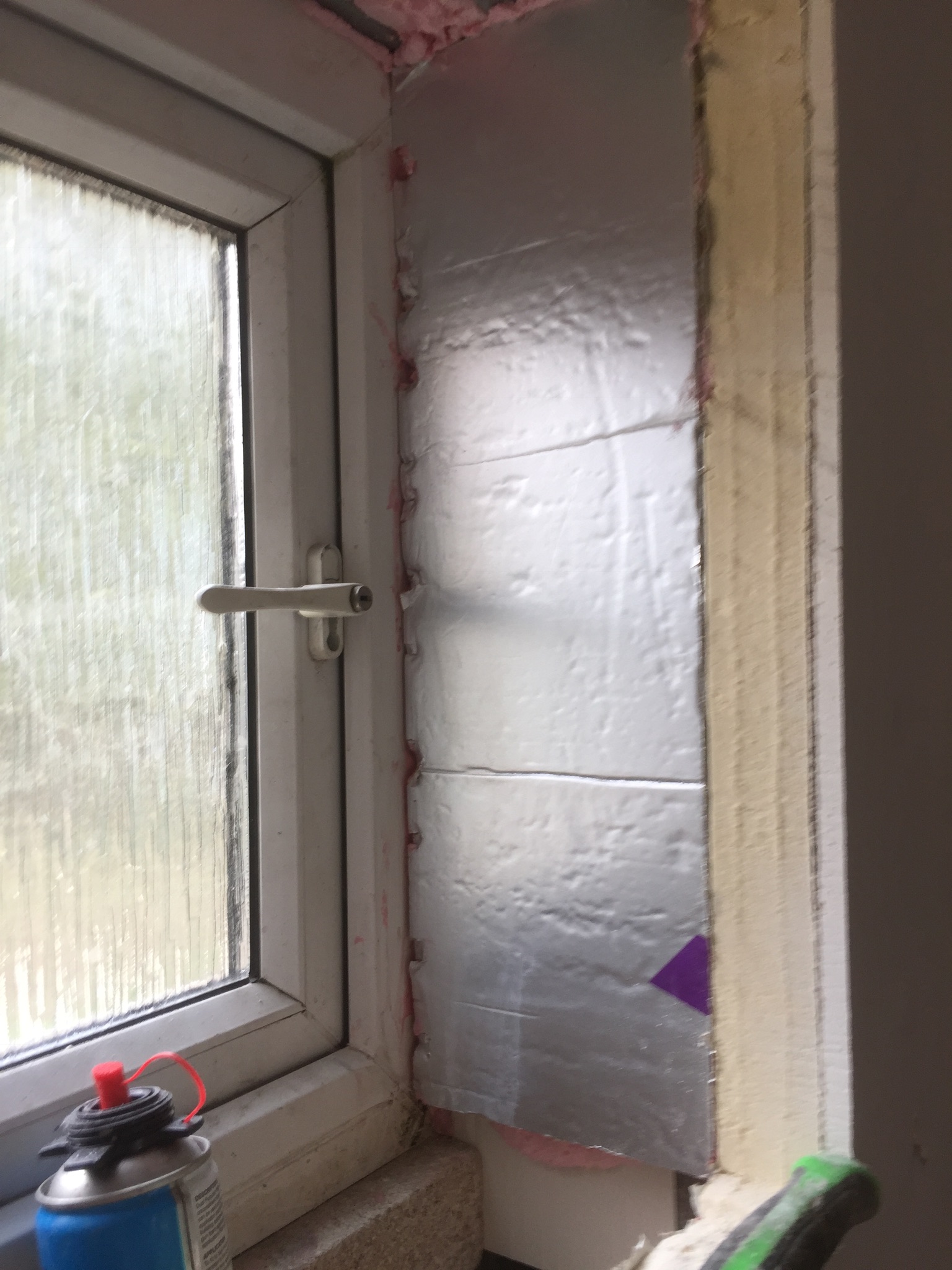

For belt n braces I've lined the reveals with 25mm cellotex too ;)  This job has IWI ( 62.5mm thermal PB ) so I wanted to be double sure there was no significant shift in 'temperature' in the window or door reveals. That just gets PB bonded on then for which I use the foam and bracing to keep it flat whilst it cures.
