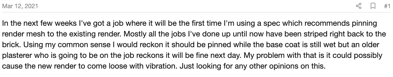

tvrulesme Posted November 22, 2024 Posted November 22, 2024 Apologies in advance for the dumb question. I'm getting a wall rendered over existing and one of the people quoting suggested pinning render mesh to the existing render. Stupidly, I forgot to ask him what this meant so now I'm curious. What pins are used and how are they applied?

tvrulesme Posted November 22, 2024 Author Posted November 22, 2024 On 22/11/2024 at 17:47, Redbeard said: I'd do your first pass with a toothed trowel - 10mm for me- , 'float' the mesh on the ridges - just a light 'tack', then a further coat with a plain trowel which fills the troughs and, hopefully, hides the mesh. If the mesh 'ghosts' through apply a further thin coat. Expand Thanks, but this is just regular mesh in render. Question here was about pinning. Saw this on another forum which seems to suggest it's a mechanical thing if vibration is a concern but can't see this clarified anywhere
Redbeard Posted November 24, 2024 Posted November 24, 2024 OK, so ask the contractor who quoted for 'pinning' what he means by it, and what his justification is for suggesting it and move on from there. @Mr Punter assumed it was the 'pink fabric mesh, and I followed as if it was. Does your contractor mean steel mesh, in which case we're talking about a different 'animal', and pinning may be relevant. Can't comment more till we know more.
