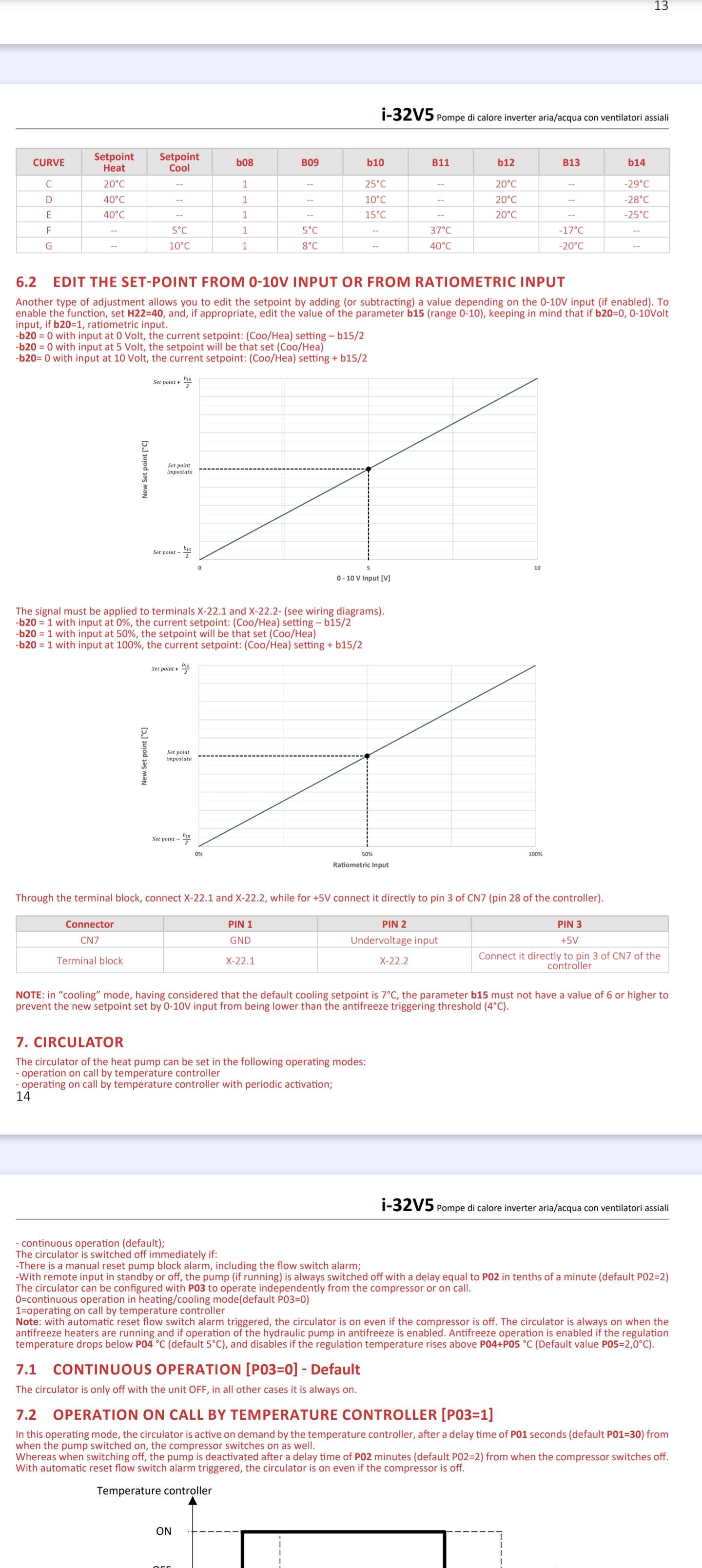

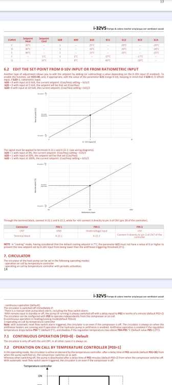

JohnMo Posted November 21, 2024 Share Posted November 21, 2024 33 minutes ago, ReedRichards said: There is no standard equivalent to OpenTherm for heat pumps and (I think) only one obscure heat pump that has OpenTherm compatibility A lot of heat pumps can be operated via 0-10v and ratiometric thermostats. So mine if connected will alter flow temp via a settable curve similar to weather compensation. So in effect I could have weather compensation plus have a variation of flow temp based on thermostat output. Pressure mine would not be the only one, as nearly all A2A are controlled in a similar way. Link to comment Share on other sites More sharing options...
