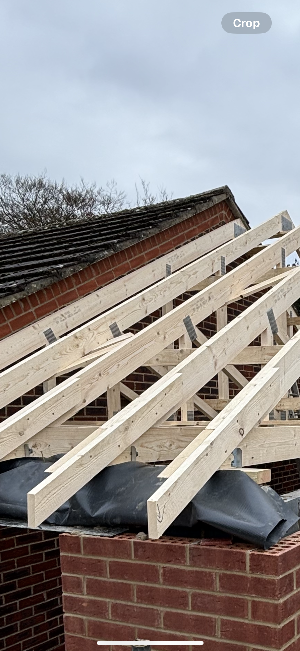

lambinh0 Posted November 18, 2024 Posted November 18, 2024 Does anyone know how I would go about fitting the stepped flashing on this roof? Can I just run straight diagonal flashings into the diagonal mortar line? any suggestions would be much appreciated
Canski Posted November 18, 2024 Posted November 18, 2024 Yes but there’s not enough room for a 75mm upstand by the time your tiles and lath are on. You will need to go up as far as the top of the brick on edge.
Russell griffiths Posted November 19, 2024 Posted November 19, 2024 By the time it’s tiled and a flashing installed you won’t be able to see any brickwork, that will all be lead. tiles need to come off original roof and new flashing dressed under the cloaking and cement fillet. then re lay original verge tiles on original roof.
