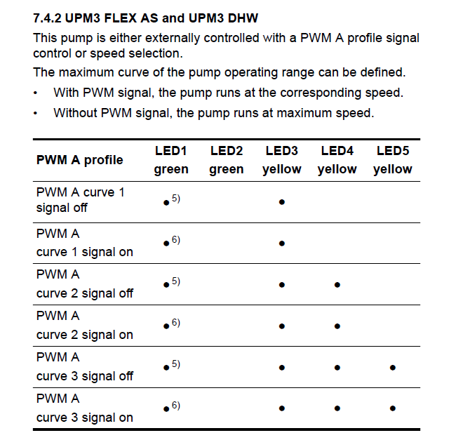

sirpatchuk Posted November 20, 2024 Author Share Posted November 20, 2024 (edited) On 19/11/2024 at 10:58, John Carroll said: Can you identify which pump is serving the CH (rads only) by just requesing rads only on and then take a photo of the front of the pump showing its LEDs, which should show what head the pump is producing. ok… turns out only one pump feeds both the ufh and radiators.. just had this email from the installer; The system has two pumps, one of the pumps feeds the hot water to the low-loss or the hot water tank. The second pump is after the low loss which feeds both the radiators and the UFH. This pump feeding the UFH and the radiators is on its highest setting Edited November 20, 2024 by sirpatchuk Link to comment Share on other sites More sharing options...
John Carroll Posted November 20, 2024 Share Posted November 20, 2024 Unless this pump has a external (PWM) signal then it will only run at the highest speed, a 7M head. This will more than likely cause noisy operation IMO especially when coupled with Evohome control which continually throttles the motorized rad valves, don't know what the cure for this is. Link to comment Share on other sites More sharing options...
sirpatchuk Posted November 20, 2024 Author Share Posted November 20, 2024 We are using normal trvs, not the digital evo home ones. can it be setup so there is a pump for the ufh and a pump for the upstairs radiators? Would that change anything? Link to comment Share on other sites More sharing options...
marshian Posted November 20, 2024 Share Posted November 20, 2024 1 hour ago, sirpatchuk said: We are using normal trvs, not the digital evo home ones. can it be setup so there is a pump for the ufh and a pump for the upstairs radiators? Would that change anything? Why not try turning the pump speed down? I would be surprised in the system needs a pump running flat out unless it's a really big system with a lot of rads and UFH I've got 13 rads no UFH and I have a smaller pump running on min speed (out of 3) - I can run it faster but the temp drop on each rad gets narrower and system noise increases as TRV's start to restrict flows In fact I'd actually try the slowest speed and work up from there if the house room temps started to nose dive (it's currently a good environment to do this exercise) I'd gradually increase pump speeds until control was there Link to comment Share on other sites More sharing options...
John Carroll Posted November 20, 2024 Share Posted November 20, 2024 It states above, "Without PWM signal, the pump runs at maximum speed" so if there isn't another cable plugged into the pump PWM socket and it looks like there isnt, then that pump will be running at a 7M head so can't be set to one of its other heads down to 4 or 5M?. These UPM type pumps seem popular with UFH systems, wonder why, as all the normal type can run in all the different modes/settings. most don't have this PWM socket but its very rarely needed. Link to comment Share on other sites More sharing options...
marshian Posted November 21, 2024 Share Posted November 21, 2024 10 hours ago, John Carroll said: It states above, "Without PWM signal, the pump runs at maximum speed" so if there isn't another cable plugged into the pump PWM socket and it looks like there isnt, then that pump will be running at a 7M head so can't be set to one of its other heads down to 4 or 5M?. These UPM type pumps seem popular with UFH systems, wonder why, as all the normal type can run in all the different modes/settings. most don't have this PWM socket but its very rarely needed. I don't read that the same way - sorry I read that as without PWM the pump can be run at one of 4 speeds Link to comment Share on other sites More sharing options...
John Carroll Posted November 21, 2024 Share Posted November 21, 2024 That makes sense, I think those settings are 4M,5M,6M&7M, so try the 4 or 5m curve. Link to comment Share on other sites More sharing options...
marshian Posted November 21, 2024 Share Posted November 21, 2024 54 minutes ago, John Carroll said: That makes sense, I think those settings are 4M,5M,6M&7M, so try the 4 or 5m curve. I'd be starting at the slowest speed possible and seeing how the system responded If the rad circuit has been balanced using the lockshields for a pump set to max you might have to allow a little bit more flow thro the rads but it may not be necessary - I can run my pump on 1 or 2 with no re-balancing required - only difference is the difference between flow and return on each rad drops with an increase in pump speed. Link to comment Share on other sites More sharing options...
