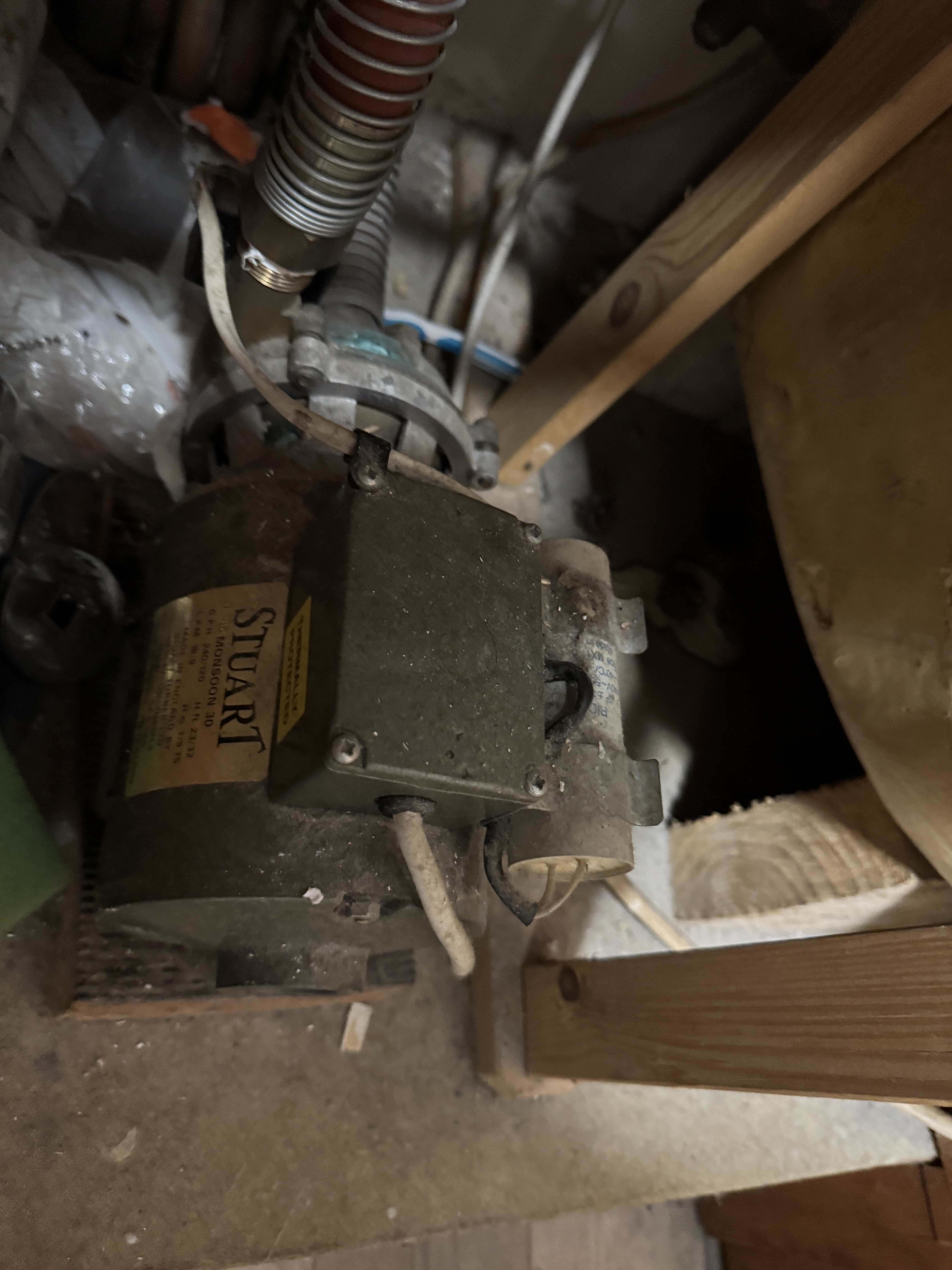

AliG Posted November 12, 2024 Author Share Posted November 12, 2024 Yes, I will run taps when I am there tomorrow to see if I can get an idea of what is going on. I don't understand why there appears to be pump next to the tank and the shower is also pumped. The tank pump did look ancient in the one flat we saw last week. I'll try and get a picture of it. I also noticed that the electric shower seemed to be a new addition as new pipes had been knocked through the wall to it from the cupboard behind. Maybe the tank pump gave out and this was the solution. We could conceivably have six months before my daughter has to move into the place so plenty of time to do it up. It is extremely well located and I suspect that a lot of buyers wouldn't have the time or inclination to renovate so I could get my money back on the renovation as well as having a nicer place to live. There is a reason we live in a brand new house we built ourselves! Link to comment Share on other sites More sharing options...

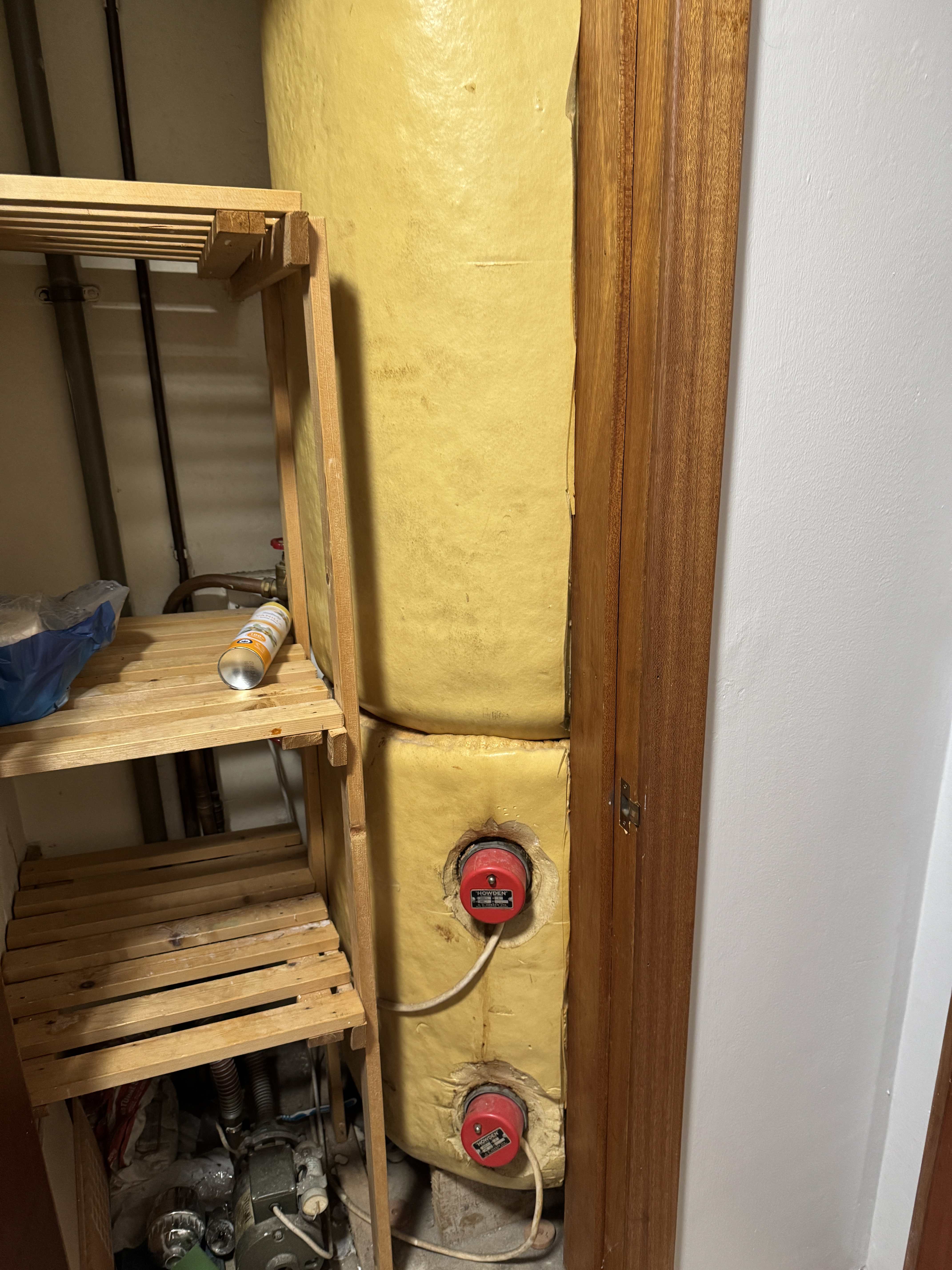

AliG Posted November 13, 2024 Author Share Posted November 13, 2024 Been to see the flats again. What I thought was a big hot water tank was actually two tanks. Hot water below and cold water above. The pump kicks in when you use a hot tap and gives good hot water pressure. I assume that the electric shower if necessary due to the small size of the hot tank. There was good cold water pressure in the kitchen which presumably is connected to the mains and poor cold water pressure in the bathroom which is presumably connected to the cold tank. Should I be able to replace both tanks with a UVC connected direct to the mains and do away with the pump and electric shower? One flat had an e7 timer on the wall. The other just had a switch which said hot water and timers on the electric radiators which makes me think they have done away with e7. Link to comment Share on other sites More sharing options...
sharpener Posted November 13, 2024 Share Posted November 13, 2024 20 minutes ago, AliG said: What I thought was a big hot water tank was actually two tanks. Hot water below and cold water above. Fortic tank, common in flats before UVCs. Hence poor head (1 m if you are lucky) and need for shower pump. Replace with UVC, all sorted. Use E7 if you can get it back, otherwise you will need a smart meter and their ToU tariffs. 1 Link to comment Share on other sites More sharing options...
JohnMo Posted November 13, 2024 Share Posted November 13, 2024 41 minutes ago, AliG said: done away with e7 We are on E7 it's all done through the single smart meter, no second required, no dedicated circuits, so that could be what's happened also 1 Link to comment Share on other sites More sharing options...
