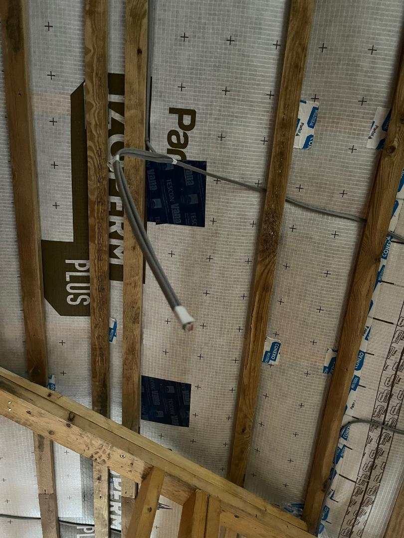

markharro Posted November 9, 2024 Share Posted November 9, 2024 I was helping our joiner plasterboard some ceilings and I was asking him how you deal with stray screws that might hit a cable for lights/smoke detectors etc. He said it best to get the electrician to test the cabling before the ceilings are skimmed. Problem - our electrician is so busy it may be hard for him to find time to do this before the ceilings are fininished. So, is it possible to test myself without buying expensive testing kit? Is it easy? How is it done. I suspect @ProDave will have the answers!? thanks Link to comment Share on other sites More sharing options...

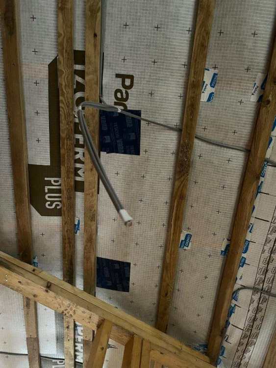

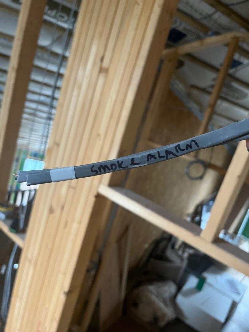

markharro Posted November 10, 2024 Author Share Posted November 10, 2024 Ah thanks...so does that mean that I only need to connect at the one end of the cable run? It sounds like it from what you say? If so that's a whole lot easier than I'd imagined. Also @ProDave can I ask what I do with these doubled cable ends on the photos.....one for smoke detector and other for lights. Just do the procedure on both cable? Link to comment Share on other sites More sharing options...

ProDave Posted November 10, 2024 Share Posted November 10, 2024 2 minutes ago, markharro said: Ah thanks...so does that mean that I only need to connect at the one end of the cable run? It sounds like it from what you say? If so that's a whole lot easier than I'd imagined. Also @ProDave can I ask what I do with these doubled cable ends on the photos.....one for smoke detector and other for lights. Just do the procedure on both cable? Yes test both cables individually Link to comment Share on other sites More sharing options...
