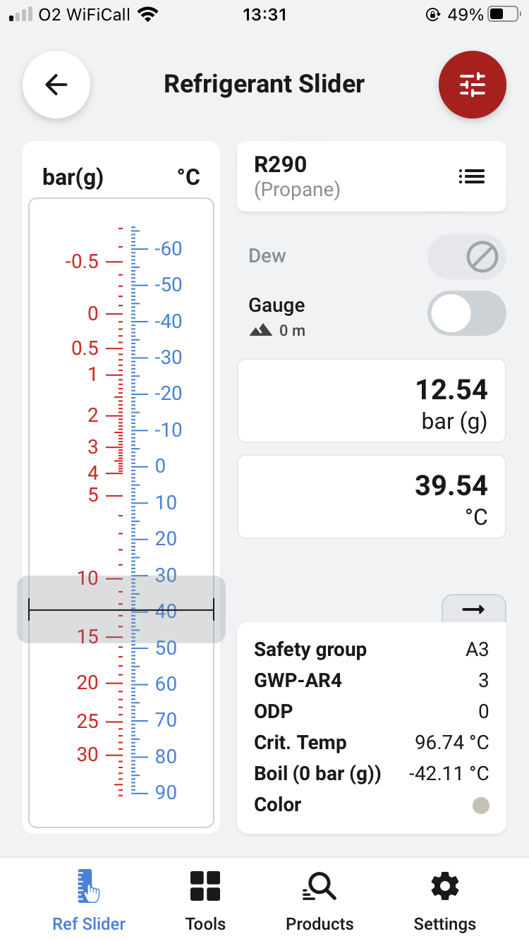

jpadie Posted November 7, 2024 Share Posted November 7, 2024 Hello all I have a small mini-split R290 heat pump in Surrey. No heat being expelled at the indoor unit but the larger hose leading from the outdoor unit is warming. Probably to c 35C - I will measure today. I don't often use the heat pump after commissioning before the Summer (it worked then) but have needed some heat the last few days! I'm not sure what the pressures should be with R290. Compressor off I am measuring 5bar at ambient 9C. Compressor on after 5 mins, the pressure is 5.2bar. After 60 minutes the pressure increases to 8.3 bar. the vendor support has been less than marvellous and ducks the questions about target pressures, recharge steps (i.e. into vacuum or not) etc. the total charge is 0.32Kg for a 4.5m hose run (each way). can anyone help with the diagnostics? My guess is low charge as one of the flare joints is greasy (the propane odorant perhaps) - however the flare joint is supposed not to be torqued up too heavily and it is pretty tight (no movement with a. 10" wrench and moderate force). and if this is a low charge scenario can anyone help with target pressures at ambient and other info useful for recharging? I could vent the propane and recharge based on weight of propane but that seems unnecessarily wasteful. lastly (for a non HVAC engineer) I'd appreciate some guidance on how to "unleak" flare joints! These are factory made joints by the way. thanks in advance Justin Link to comment Share on other sites More sharing options...
RobLe Posted November 7, 2024 Share Posted November 7, 2024 I suggest to liberally spray suspect joints with a water/washing up liquid mix. If there is a leak, you generally get a bubble forming. Our R290 system generally runs at around 13bar (hot), 3bar(cold) - of course the actual values depend on the temperatures involved - the temperatures should be slightly above the saturated values in the snip below at the measured pressures - the compressor in and out always has gas in it, never liquid. Snip from a handy free danfoss ‘ref tools’ app. My gut feeling from what you’ve said though is that the compressor is suspect or the metering device is too open - I would expect pressure post compressor(guess that’s what you measured- normally you would measure both ports simultaneously, and also temperatures at the compressor) to increase rapidly after switch on. 5bar at 9C ambient is I think the expected pressure….I am at the limit of my knowledge I’m afraid though. I assume you know r290=propane…. so don’t even think of getting a spark / flame anywhere near it. Link to comment Share on other sites More sharing options...
jpadie Posted November 7, 2024 Author Share Posted November 7, 2024 thanks for that. v. interesting. when you say 13bar (hot) does this mean when the heat pump is set to heat mode? If so then the pressures I am seeing look more or less what would be expected. I will have a look at the compressor again but from memory the inlet valve has no service port at which I could test, so outlet pressure was all I had. appreciate that propane is flammable. the concentration has to be quite specific though: above/below the range it is not ordinarily flammable. from you last para do I take it that there's not likely to be awt wrong with the indoor unit? the outdoor unit is warming the discharge hose. feels like high 30sC cheers! Link to comment Share on other sites More sharing options...

jpadie Posted November 10, 2024 Author Share Posted November 10, 2024 Thank you. I'm never really sure what those saturation charts mean nor how to use them. Is the relationship with the temperature of the gas or the temperature of the compressor? I assume it is the gas (ie ambient temperature when everything is off). It's also not clear to me whether this is like r12a and needs to be recharged via the circulation pressure rather than into a vacuum. It may not matter much given the boiling point is so low. I did try adding some r12a (isobutane +propane) using the same method as I use for that refrigerant (compressor on). However this just refilled the can! The vendor is unhelpful. Link to comment Share on other sites More sharing options...
RobLe Posted November 10, 2024 Share Posted November 10, 2024 When propane is cold and/or compressed, it will be a liquid. When it’s hot and or at low pressure it will be a gas. The chart shows the transition from gas to liquid, which is at a certain pressure at every temperature. Tbh it’s all quite non intuitive, but that phase transition is where most of the energy is stored enabling heatpumps to operate. Generally heatpumps are refilled at the cold low pressure side, when they are on, so that the low pressure there allows the fluid to be pushed into the system. Link to comment Share on other sites More sharing options...
