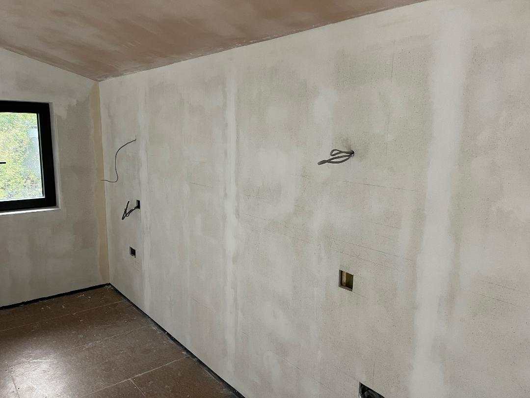

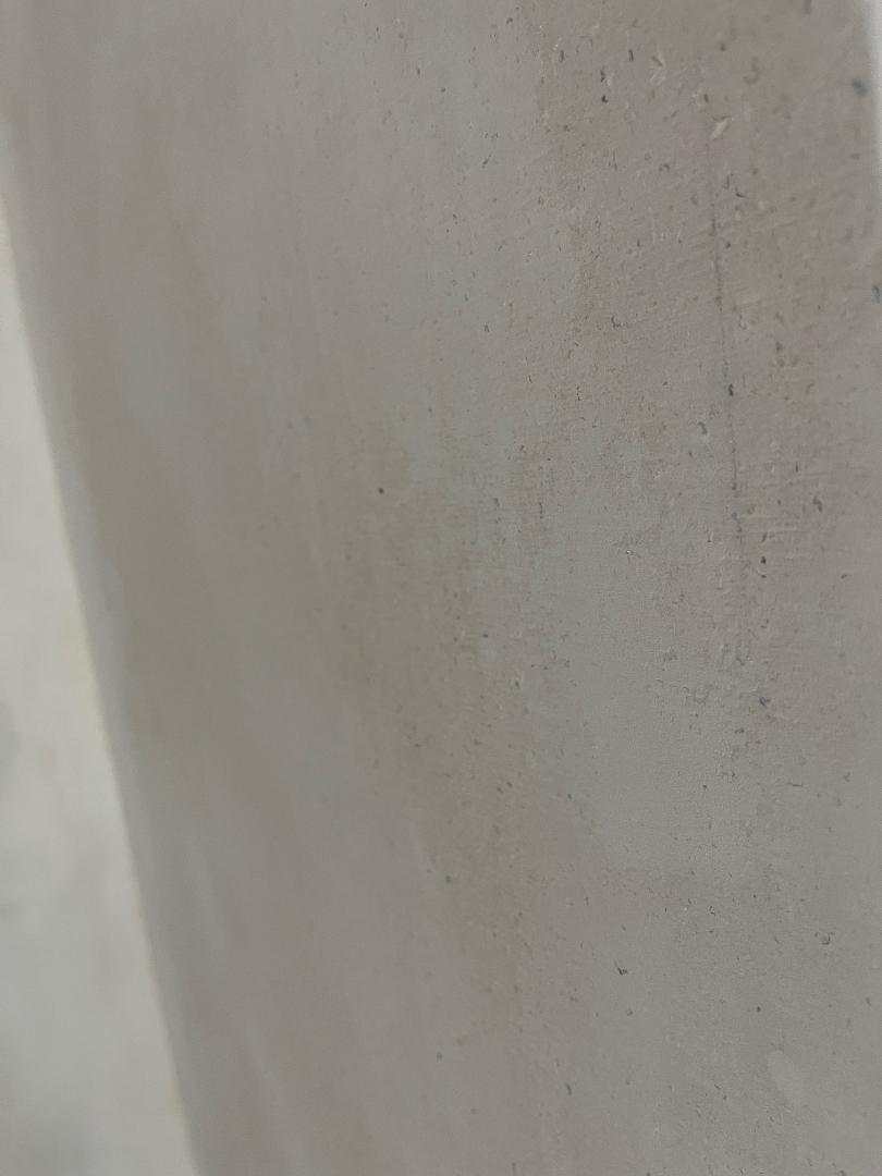

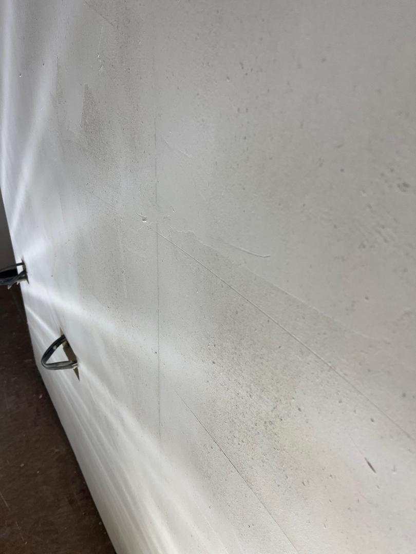

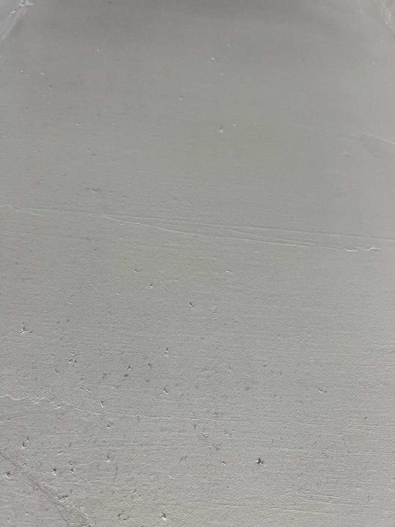

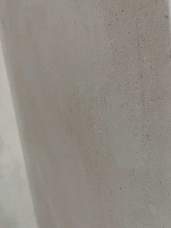

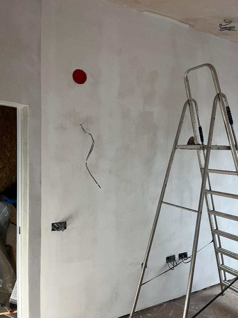

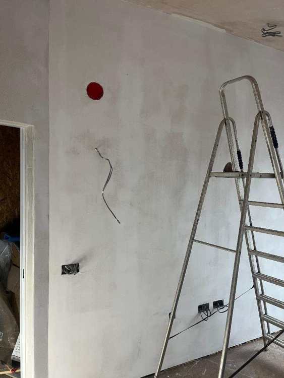

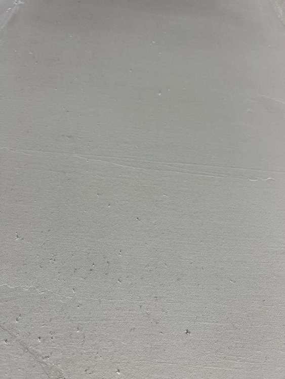

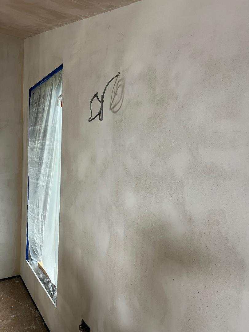

So ok @Nickfromwales you were right...finishing Fermacell is a complete PITA. However I have perserved and got the first room slathered in the FST (or almost). Its been quite a learning curve and I still dont know if what I have done is going to be any good but thank god its almost time for painting....

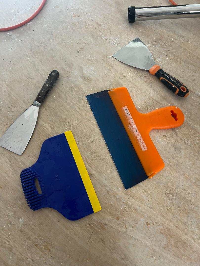

So, @Nick Laslett I wondered if you could have a quick look at my photos and (hopefully) confirm all looks in order? I have been variously trying the official Fermacell speader (orange handle) and the black rubber flexible blade. I find with the rigid Fermacell tool its very easy to scrape the FST pretty much right off the board leaving hardly any product left. It also leaves lines often despite being advertised not to (or maybe my bad technique). So I have been largely using the rubber thing as I find that easier.
But overall the appearance is "patchy" - its better when sanded but I thought I had better check that this is going to be ok once painted? Cheers
@markharro
You’re a man of conviction, I salute you.
Get 2 coats of high-opacity Matt emulsion on these and come back….to yourself.
The proof, is in the pudding.
Please let it be sticky toffee with custard….
