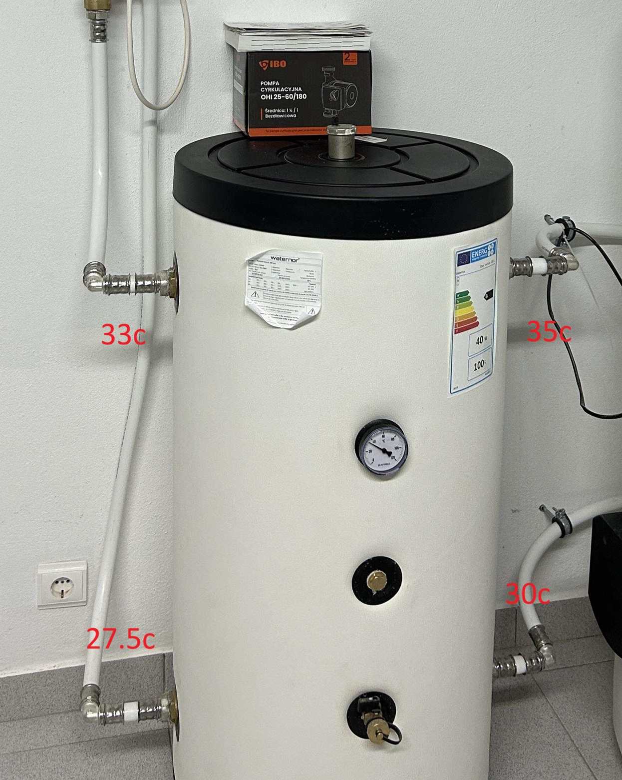

IanR Posted November 2, 2024 Share Posted November 2, 2024 (edited) 3 hours ago, Wingover said: So I checked when the system was running and here is a picture with the temps next to each port. I guess the incoming temp is not going directly to the floor manifold The gauge in the pocket 2/3 up looks close to me measuring at 35°C, although both the gauge and the laser temp gun will likely have a ±1°C tolerance so can't be relied on to compare between the two. You'll need to measure a few times to get a feel for what is going on, the temps are dynamic as the ASHP comes on and off and you're wanting 0.1° accuracy which isn't achievable with consumer devices. It would be nicer to see the temps across the top, and those at the bottom within 1° of each other. If after multiple readings, at different times, you are still seeing a similar result are you could try to slow the emitter pump down and are you able to limit the flow rate of the ASHP? Not sure if it's a setting available on all HPs, but I can turn mine down (on space heating only) to make it run slower for longer. I set mine up with a data logger and DS18B20 sensors and some times the traces would show the flow temp to the emitters higher than the flow from the ASHP, which isn't possible - the accuracy of the readings I need are not within the capability of the DS18B20's. After about 10 different sets of readings, each running for a couple of hours mine averaged out with the emitter side being within 0.5°C of the ASHP, except just as the ASHP stopped or started. Is it cold enough that the emitter circuit is running continuously (my own heating isn't on yet), are the measurements you have taken are at a reasonably steady state? Edited November 2, 2024 by IanR Link to comment Share on other sites More sharing options...
Wingover Posted November 2, 2024 Author Share Posted November 2, 2024 The picture is from a different time I just used it to put the temps on so you can see. The plastic gauge showed 31c when I took the measurements. It is not as cold so I will wait until all zones are on and take several measurements at that time. I can choose on the ASHP to run it's own pump (not the one by the buffer tank) on several different modes. 1. Delta T 2. Automatic flow 3. Capacity adjustment from 10% to 100% Link to comment Share on other sites More sharing options...
