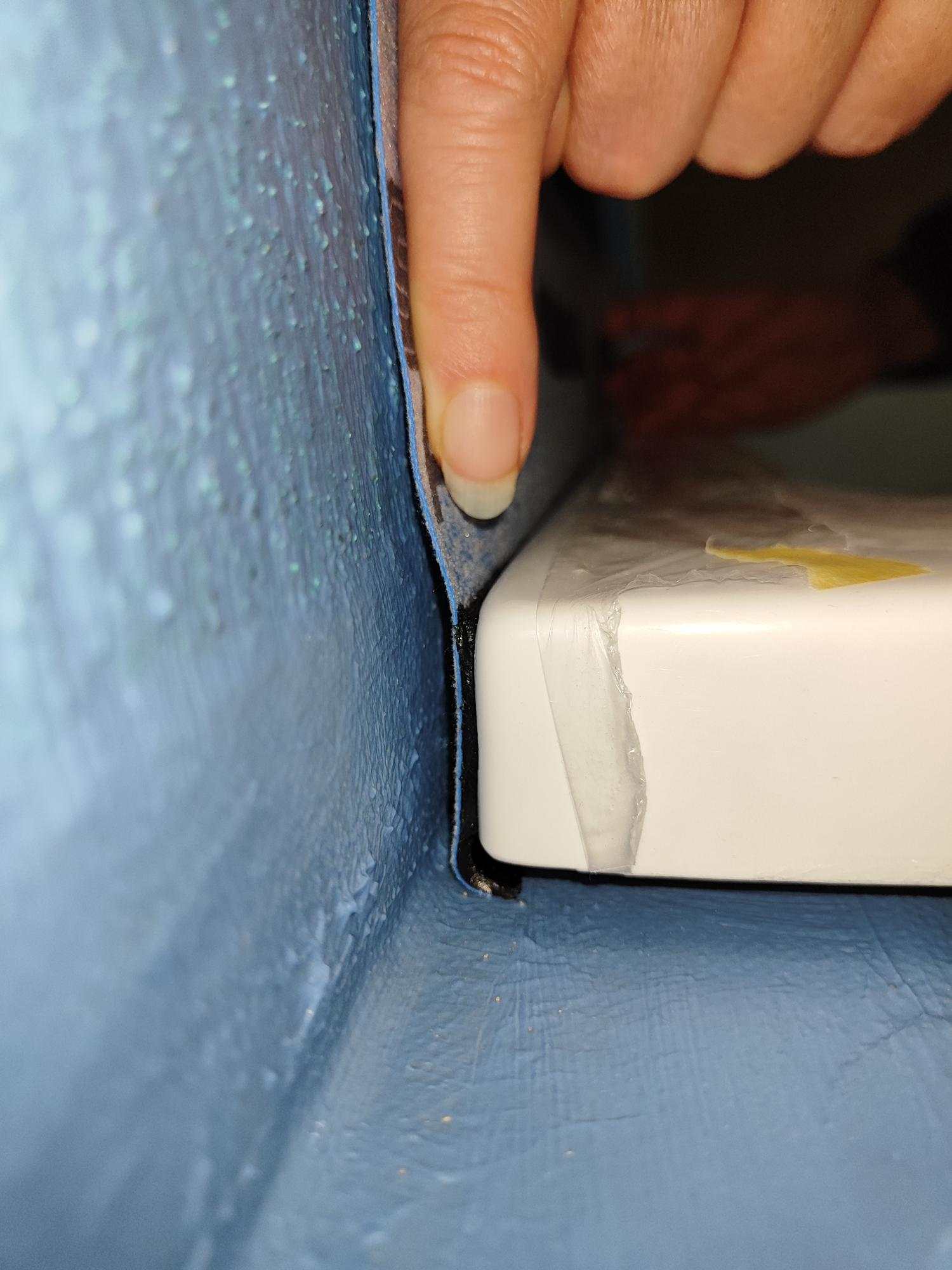

MortarThePoint Posted October 31, 2024 Posted October 31, 2024 I've fitted Classi Plus tape to the edge of the bath against the wall. The wall has a slight bulge in the middle so at the ends of the bath there is an approx 3-4mm gap (image below). The Classi tape itself is thicker than I'd like, but that's what it is. My main question is can the tiler build out the wall here to compensate? @nod is that standard stuff or am I facing a problem?
Nickfromwales Posted October 31, 2024 Posted October 31, 2024 You (tiler) can build that out with cementitious flexible tile adhesive, no problem at all. Just dub the low areas out in a few sets to get the wall spot on for a nice even finish, and a good consistent line across the bath edge (so you can’t see that the wall bellies basically). Do not use acrylic/ready mixed stuff there whatever you do! 1
