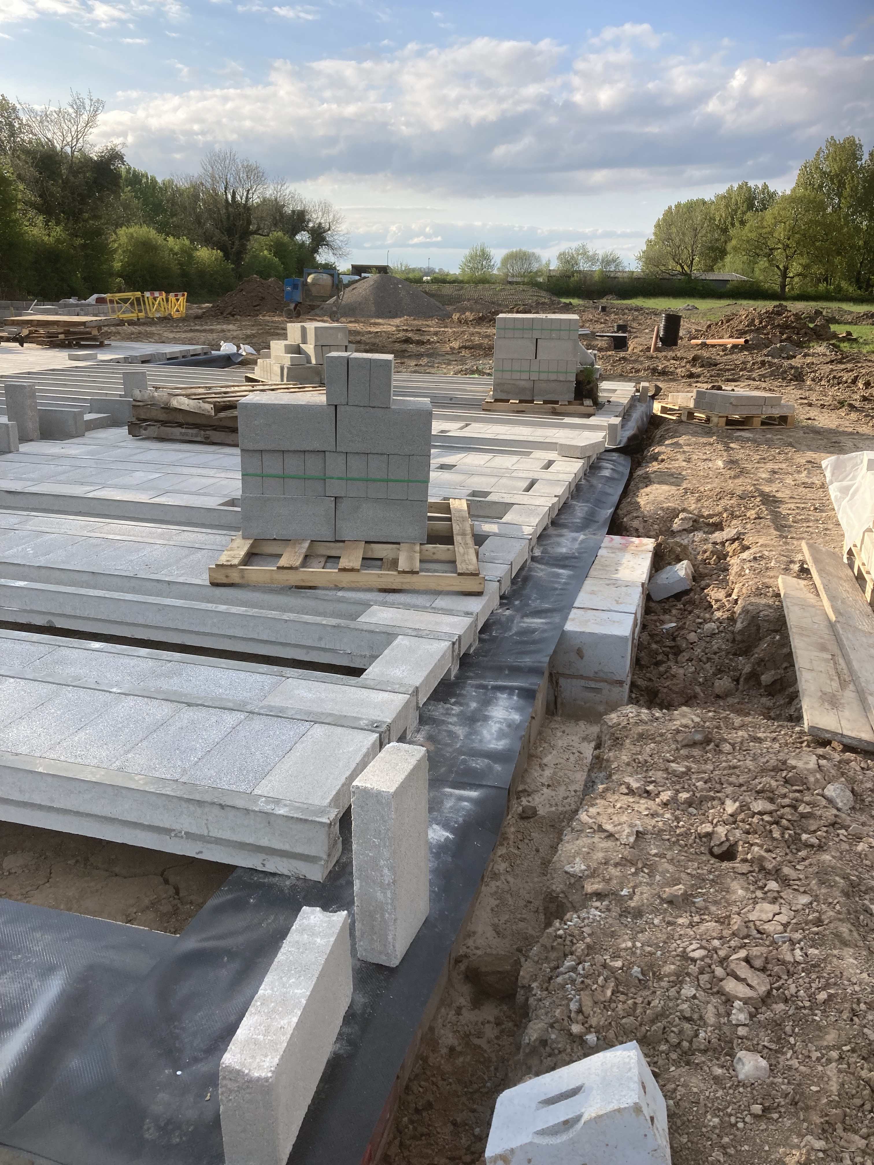

So to be clear, you're going from under the beams, then turn up vertically to protect the ends of the beams, then coming back in over the top of the first block thats laid onto the beam and block floor? Which on my sketch would be from A to C? 100 under the beam, 150 beam, 225 block, 100 back into the coursing, Total, 600 minimum.

Exactly 600 dpc I did the same on our previous build Belt and braces
Are you running the 600 dpc the full perimeter, including where beams run parallel with the wall and the cut block end beds on to the slips?
The photo looks like you do. I just can't see any overlap at the corners, it looks like one sheet which it can't be.
