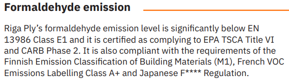

Effectively being in Europe means we are currently only governed by EN 13986 and so most products only state that they are E1 and, quite reasonably, that's all most suppliers understand. There is a chance of finding M1 compliance stated which is one of the tightest limits globally. Some manufacturer's (e.g. Riga) clearly set out the various standards that they meet in a more global context. For example here is an extract from Riga birch ply:

  • Birch: Riga Ply (meets F4), Wisa may be good but documentation not so clear
