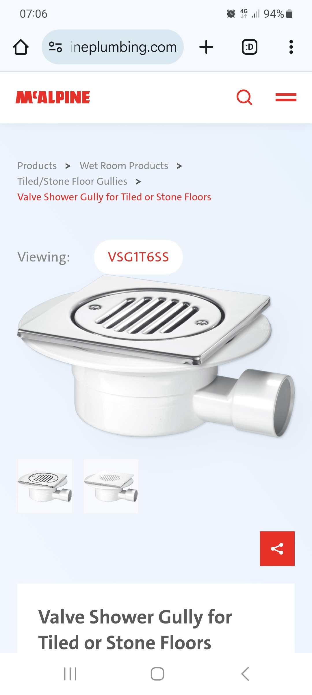

I have a wooden house
There is a lot of plumbing in the "utility cupboard" that could, in principle, go wrong. (water pump gubbins, mechancial, de-ironing and softening filters, washing machine, general plumbing etc)
I'm toying with the idea of a "tray" with floor drain in it, dropping through the floor to a hepvo trap that just drops into the (vented) crawlspace.
In principle this will never see water. In practice it'll probably get the contents of a mechanical water filter spilled down it occasionally but that's about it.
Do they stay dry / sealed from an airtightness perspective in this application? It's likely that it would be under negative pressure (suck from house, stack effect to roof) rather than positive.
Ditto for the fridge freezer (power cut defrost don't destroy the wood floor) potentially; though that can probably just be a deep enough tray given the limited volume of water in a freezer.
Madness because?

I've fitted one of these Mcalpine waterless waste in to the floor, I've not tanked the room as it was a bit of a late decision but I figured anything would be better than nothing. You can buy replacement seal units that slot and lock in if there ever was a problem.

Thanks folks; this sounds like a goer. 🙂

I've found a nice metal roof shop locally. Copper / brass / zinc sheet and all the gubbins to work with it. I'll fold up a "tray" in zinc to sit inside in the base of the cupboard; and drain through a waterless trap. This will be more robust to e.g. dropping a screwdriver/spanner on it during servicing work than lino over a soft floor (likely to pinhole) and should catch drips from filter servicing / the odd bit of condensation from water filters in summer etc.
Cutting THROUGH the floor isn't an option as it's the aitrightness layer. Trimming a capillary break under the metal near to the doors might not be daft though - good shout and a job for the tracksaw 🙂
