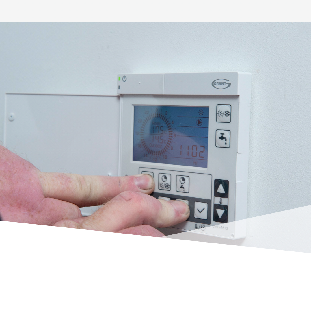

Chinkoa Posted October 12, 2024 Author Share Posted October 12, 2024 Rads , onto thermostat. Got weather compensation. It's a grant airflow 17 5 kw. Has to be oversize. Going through instructions. Hw. Set at 60c by installers, now set at 50c Working through other manuals. I don't connect very well with written instruction, never have. Prefer to see someone do it then it falls into place forever. Link to comment Share on other sites More sharing options...
PhilT Posted October 13, 2024 Share Posted October 13, 2024 House size (eg floor area)? Are you saying peak heat loss is 5kW (at what ambient temp?) but the heat pump is a 17kW? Hot water set to 60 continuous will cost you a lot of electricity. Mine is set to 42, for 2 people, timed to heat once a day at 2pm. We only take short showers. If the flow temp is fixed at 50 then it's not set to Weather Compensation. There may be some useful YouTube videos on that model possibly? Link to comment Share on other sites More sharing options...
Beelbeebub Posted October 13, 2024 Share Posted October 13, 2024 Welcome. As the others have said, what is your setup? The Grant units are pretty good but they are setup from the factory to act like oil/gas boilers so they are more familiar for installers. In particular they tend not to use weather compensation but just set a fixed flow temperature for your UFH/rads and control the temp by turning on and off via a standard thermostat. This can really hit the efficency. There are ways of setting the system to be more efficient. Do you have the white control unit? Link to comment Share on other sites More sharing options...

Chinkoa Posted October 13, 2024 Author Share Posted October 13, 2024 42 minutes ago, Beelbeebub said: Welcome. As the others have said, what is your setup? The Grant units are pretty good but they are setup from the factory to act like oil/gas boilers so they are more familiar for installers. In particular they tend not to use weather compensation but just set a fixed flow temperature for your UFH/rads and control the temp by turning on and off via a standard thermostat. This can really hit the efficency. There are ways of setting the system to be more efficient. Do you have the white control unit? Link to comment Share on other sites More sharing options...
Chinkoa Posted October 13, 2024 Author Share Posted October 13, 2024 Yes I have the same white controller. what settings do you suggest change and how? Link to comment Share on other sites More sharing options...
Beelbeebub Posted October 13, 2024 Share Posted October 13, 2024 (edited) Need to work out what setting you have now before any changes. Did they swap radiators, put in new pipework? How warm do they get? Have you got Underfloor? How warm do those radiators get? Is it always the same? Is your HP running continuously or starting and stopping all the time? One thing to note is you will not be able to generate enough electricity to power your HP through the winter. You will be paying for some electricity. If things go well, the extra you pay for electricity will be less than you would have paid for LPG. Edited October 13, 2024 by Beelbeebub Link to comment Share on other sites More sharing options...

sharpener Posted October 13, 2024 Share Posted October 13, 2024 22 hours ago, Chinkoa said: Rads , onto thermostat. Got weather compensation. It's a grant airflow 17.5 kw. Has to be oversize. Going through instructions. Hw. Set at 60c by installers, now set at 50c There were some extra line breaks, it makes more sense with them removed as above. Yes making sure you are on WC would be the first priority, keep reducing the curve by 0.1 each day until you are too cold and then back one step. No one has mentioned ToU tariffs. If you change to something like Octopus Cosy then yr 23.2 kWh batteries can be charged fully at cheap rate 3x in every 24 hours and will most likely have the endurance to bridge the HP across the peak rate window 1600 to 1900h (or maybe you can program it to be set back or off at those times). u If you have a big enough HW tank also set this to heat up only during off-peak rate. Grant are often installed as S-plan so make sure the heating is off while the HW is on, or your htg flow temp will be unnecessarily high. If you are not on Octopus already there is a discount code which you can spilt with half going to support this forum, I forget the details but one of the mods will be along to tell you shortly(!). Link to comment Share on other sites More sharing options...
Beelbeebub Posted October 13, 2024 Share Posted October 13, 2024 I assume you have an unvented hot water cylinder. The grant system (assuming they have installed as per instructions) uses a totally seperate anti legionella system basically a timer and immersion you set to go off once a week. So you can set the hot water temp to as low as provides enough water at a hot enough temp for you. The next thing is to check if weather comp is active. It might not be if your installer was not on the ball. The easiest way to check is to feel the rads. Are they warm to the touch, and does that vary? Ie on a cold night are they warmer than a mild day? Do you have a single thermostat or one of each room? Link to comment Share on other sites More sharing options...
Chinkoa Posted October 15, 2024 Author Share Posted October 15, 2024 On 13/10/2024 at 12:57, sharpener said: There were some extra line breaks, it makes more sense with them removed as above. Yes making sure you are on WC would be the first priority, keep reducing the curve by 0.1 each day until you are too cold and then back one step. No one has mentioned ToU tariffs. If you change to something like Octopus Cosy then yr 23.2 kWh batteries can be charged fully at cheap rate 3x in every 24 hours and will most likely have the endurance to bridge the HP across the peak rate window 1600 to 1900h (or maybe you can program it to be set back or off at those times). u If you have a big enough HW tank also set this to heat up only during off-peak rate. Grant are often installed as S-plan so make sure the heating is off while the HW is on, or your htg flow temp will be unnecessarily high. If you are not on Octopus already there is a discount code which you can spilt with half going to support this forum, I forget the details but one of the mods will be along to tell you shortly(!). I am with Octopus. GB Green and cosy. 17.47p/kw unit rate and 19.95p/day standing charge. that seem a good tariff to be on. I will look at WC. Link to comment Share on other sites More sharing options...
Chinkoa Posted October 15, 2024 Author Share Posted October 15, 2024 On 13/10/2024 at 13:16, Beelbeebub said: I assume you have an unvented hot water cylinder. The grant system (assuming they have installed as per instructions) uses a totally seperate anti legionella system basically a timer and immersion you set to go off once a week. So you can set the hot water temp to as low as provides enough water at a hot enough temp for you. The next thing is to check if weather comp is active. It might not be if your installer was not on the ball. The easiest way to check is to feel the rads. Are they warm to the touch, and does that vary? Ie on a cold night are they warmer than a mild day? Do you have a single thermostat or one of each room? Yes radiators are warmer at night. Single thermostat in the Hall. Trvs on all Rads but one as you would expect. Link to comment Share on other sites More sharing options...
