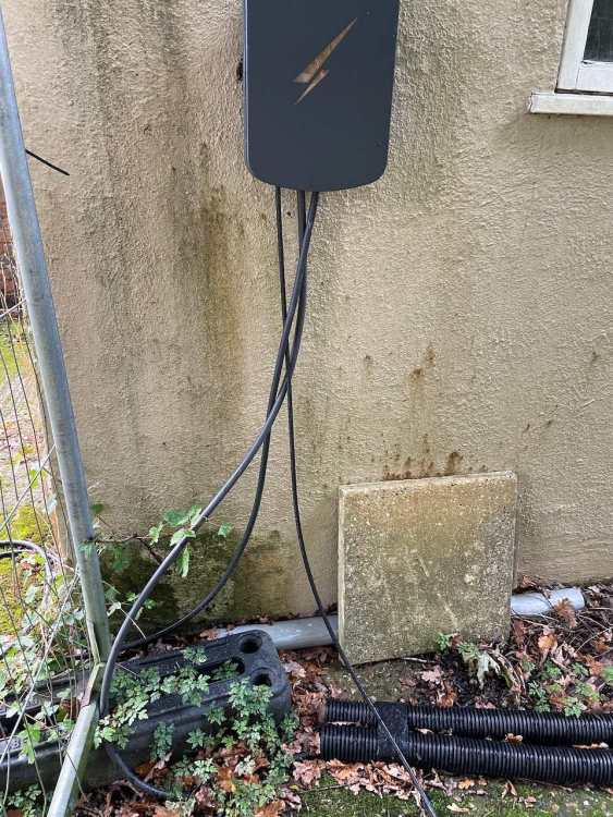

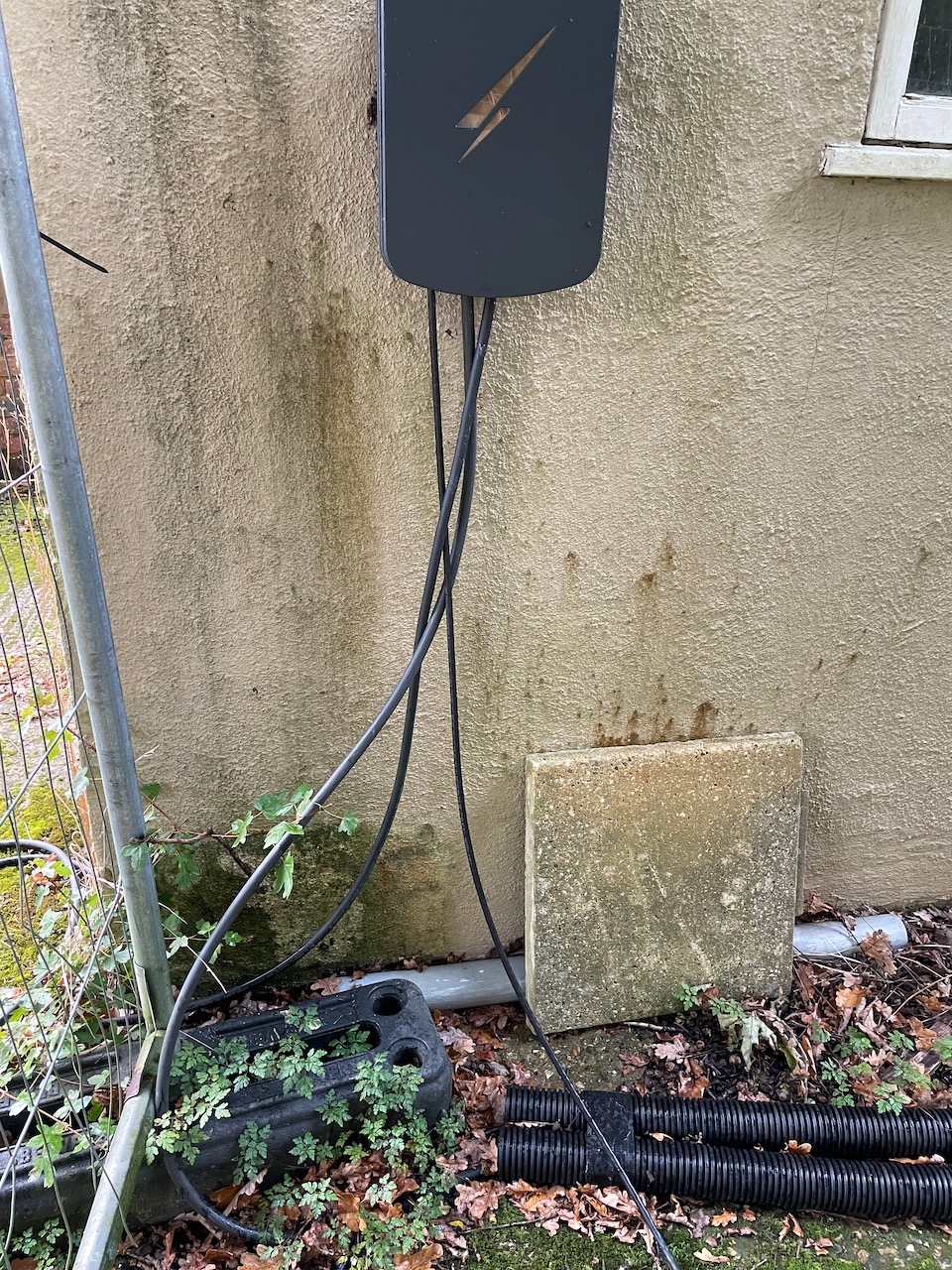

Thorfun Posted October 12, 2024 Share Posted October 12, 2024 I fitted our EV charger to the old property but running electrics from the new property so I could charge from the solar PV on the new house. I ran 2 x ducts buried in the ground and then fed an SWA cable and a bury-able Cat5e cable. hopefully you can see them coming out of the ducts. eventually those ducts and SWA were supposed to feed a new chicken house but those plans have been knocked on the head so I'll probably just end up burying the ducts and pulling the cables back through for use elsewhere. The Cat5e cable is connected to a CT clamp that tells my charger when enough solar is being exported and then sent the excess to the car. the charger also has a max current limit so that if the total draw of the house and car ever got above a certain amount the charger would throttle the charge to avoid tripping the main fuse. some chargers have wireless CT clamps though so you can get around it but for the cost of a network cable just run one (or two) or a duct so you can pull as many as you need at a later date. Link to comment Share on other sites More sharing options...
