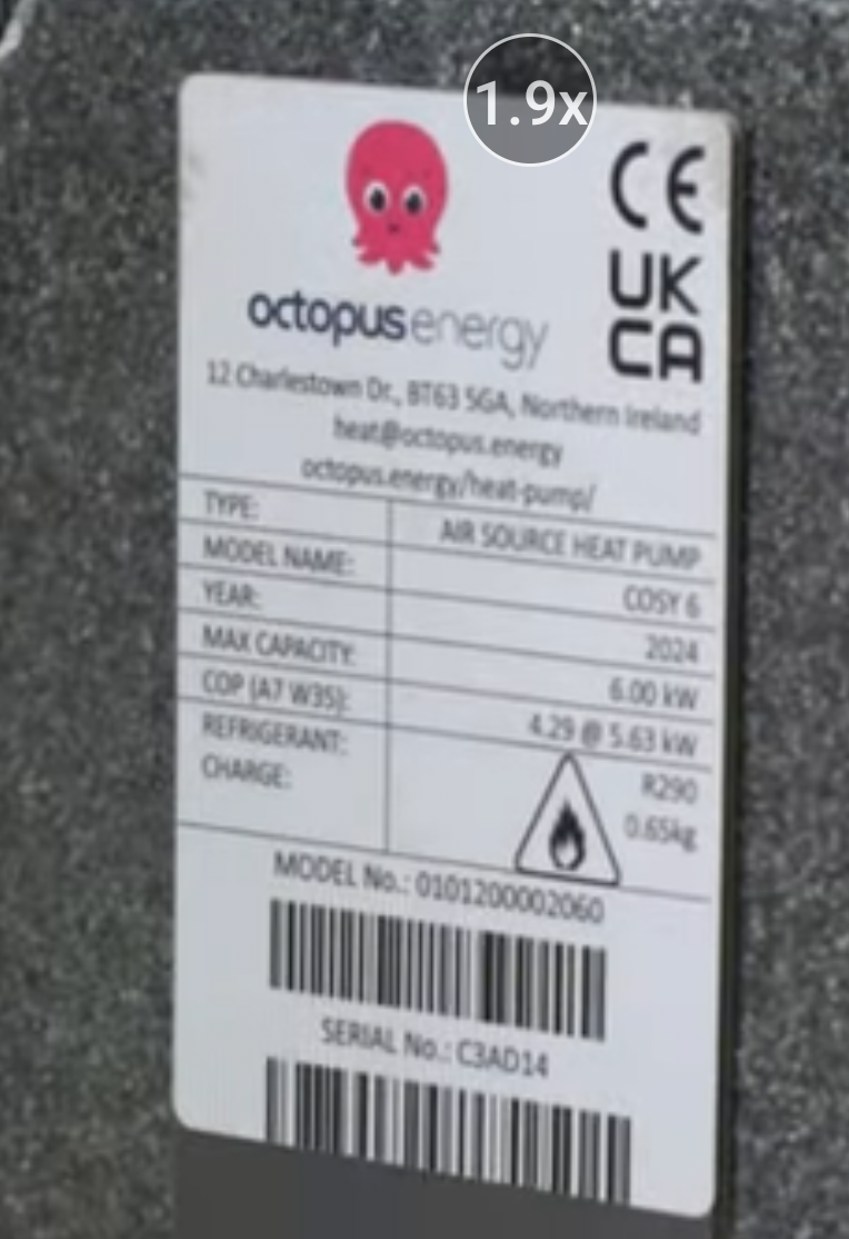

Beelbeebub Posted October 8, 2024 Share Posted October 8, 2024 Screenshot from a video The A7W35 performance of 5.6kw with a CoP of 4.29 doesn't seem very impressive. For example the Grant r290 unit is rated at 4.99 at 4KW for the smallest and 4.95 at 7.6kw. If the Octopus unit was very small and compact it migbt be forgivable but it seems pretty, err, "portly" to be honest. Maybe it is very quiet. It is notable the Octopus unit uses 600g of refrigerant which is the same as thr grant 4kw unit. So maybe the Octopus unit is working harder so sacrificing CoP if it was derated to 4kw maybe it would perform like the Grant unit. I wonder what the noise levels are like. Link to comment Share on other sites More sharing options...
PhilT Posted October 9, 2024 Share Posted October 9, 2024 The MCS tests also record a poor performance for this unit compared to most other models Link to comment Share on other sites More sharing options...
Beelbeebub Posted October 9, 2024 Author Share Posted October 9, 2024 The refrigerant to air heat exchanger seems smaller than comparable units, partly because of the design of the case. Most "box" units have an L shaped coil to get extra area. Then all the gubbins off to one side. The Octopus one is just a square heat exchanger with the gubbins infront/below. I'm thinking there is probably a really good reason that almost every aircon/heatpump outside unit uses this offset box configuration. Link to comment Share on other sites More sharing options...
