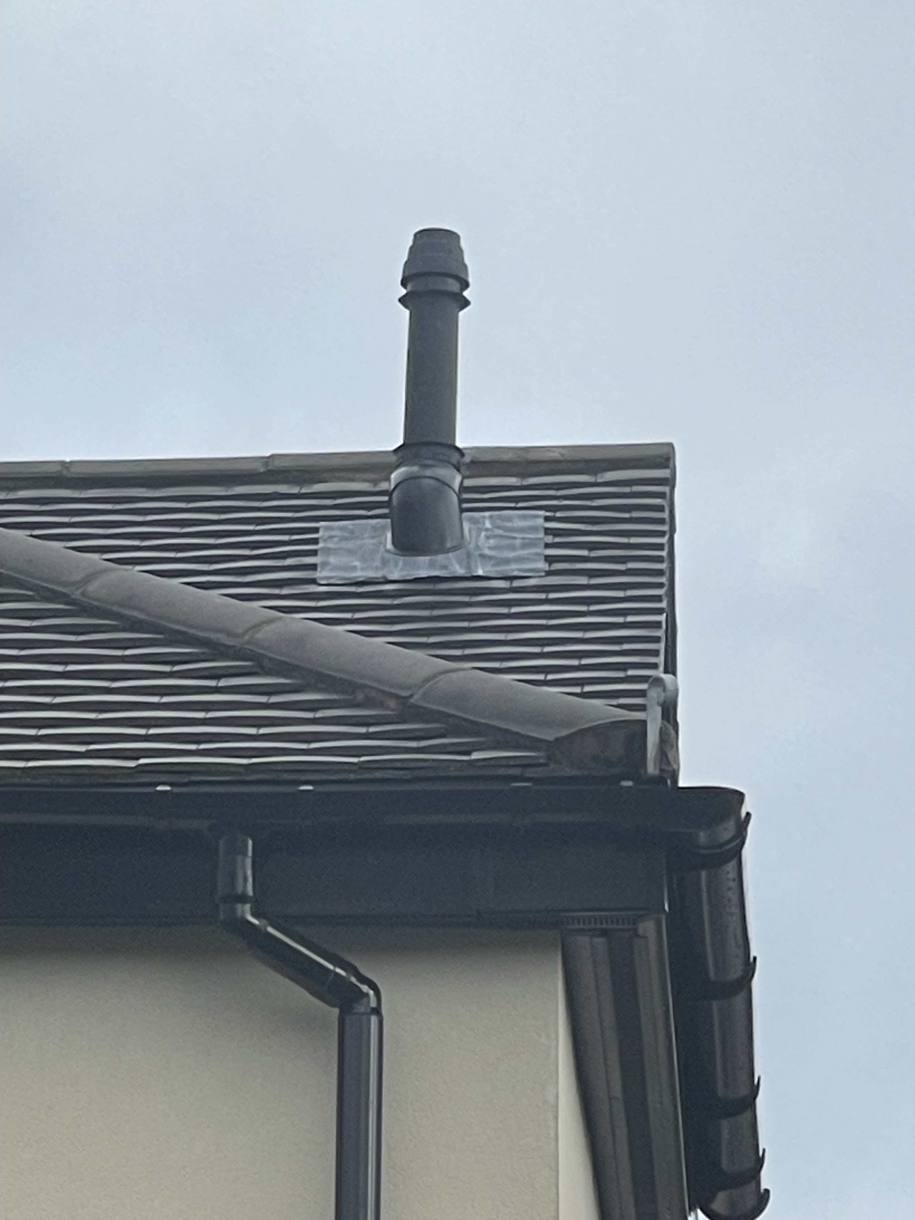

Lofty718 Posted September 26, 2024 Posted September 26, 2024 Does this flue flashing look right? all other examples I have seen it's much more integrated/tiled in, they are getting water dripping in through the felt
ProDave Posted September 26, 2024 Posted September 26, 2024 Sorry not right at all. Here is mine, different sort of flue but you get the idea how it should be.
Mr Punter Posted September 26, 2024 Posted September 26, 2024 The top half of the flashing should be under the tiles, not over them.
