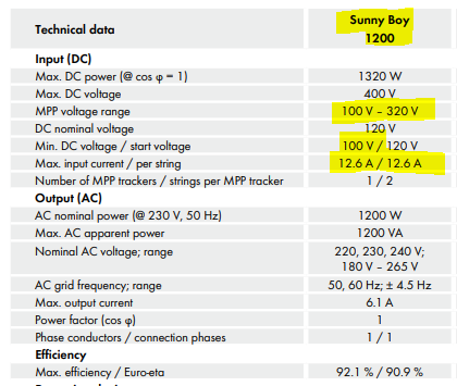

dave1967 Posted November 25, 2024 Author Share Posted November 25, 2024 Evening Got the new panels 6 x dmarc 410w Now have another problem as they may not have enough voltage to kick start my 2 sunnyboy inverters. Didn't kick in between 3 and 4 on a dull day. Is a new inverter the answer? Link to comment Share on other sites More sharing options...
SteamyTea Posted November 25, 2024 Share Posted November 25, 2024 (edited) 5 minutes ago, dave1967 said: Is a new inverter the answer? Which SMAs you got? Why have you got 2 of them? Edited November 25, 2024 by SteamyTea Link to comment Share on other sites More sharing options...
dave1967 Posted November 25, 2024 Author Share Posted November 25, 2024 Hi Got 2 1200s. No idea why. Maybe because old array of 10 had a few panels lower down and partly shaded. I now have a row of 6 just below the ridge. Link to comment Share on other sites More sharing options...
dave1967 Posted November 25, 2024 Author Share Posted November 25, 2024 System was already installed. So pleasant unknown surprise when we bought at auction and it was on 2011 tariff. Link to comment Share on other sites More sharing options...
sgt_woulds Posted November 26, 2024 Share Posted November 26, 2024 The panels, string design, voltage and amperage would have been designed to match the inverter specifications. What panels did you have before? What were they rated at? How many panels in a string? (presumably 5 each but not necessarily) What is your string voltage and amperage now? Is the polarity correct? A string of six panels should have an open circuit voltage of 120 - 225 v and 10-15 Amp depending upon panel specs which should be fine on one of your SB1200's. These things are bullet proof, but keep the other one as a spare. Who has installed the panels? What are their qualifications? Are the clamps within the clamping zones of the panels? Have you run uplift and dead weight calculations to ensure the correct number of fixings and screw sizes to work with your roof timbers? Distance from roof edges and ridge? If the installation was poor before, did the original installers properly assess the roof structure? Most times not. [Back in those early cowboy days we turned down installs on some roofs rather than risk roof damage or panels flying off. Often the homeowner would call back later to say company 'XYZ' had fitted 'twice as many panels' as we had recommended but had gone out of business. We had quite a good business fixing all the badly installed panels during the solar crash...] Who is connecting the panels to the inverters? What connectors are they using? Are they original manufacturer or 'generic compatible' with the original connectors, (MC3 or MC4 depending upon the age of the inverter). NEVER mix and match connector types - there are plenty of examples of fires caused by incompatible 'compatibles'. What size cables? Are they double insulated and how do they enter the roof space, (are they mechanically protected, or just run under a tile? Link to comment Share on other sites More sharing options...
dave1967 Posted November 26, 2024 Author Share Posted November 26, 2024 The issue is i have 3 panels on each inverter so the installer said they are not getting to required start up voltage. So i need more panel or a new single inverter. No idea if this is correct. Link to comment Share on other sites More sharing options...
sgt_woulds Posted November 26, 2024 Share Posted November 26, 2024 Yes. Who designed this system for you? Is the 'installer' a MCS competent person? If not, what are their qualifications for installing panels and working with high voltage DC? Why did they not check the requirements before connecting to the inverters? Link to comment Share on other sites More sharing options...
sgt_woulds Posted November 26, 2024 Share Posted November 26, 2024 You don't necessarily need a new inverter or more panels. 6 panels should fire up a single SB1200. Whether it will make the most efficient use of the panels, who can say. For maximum returns, a PV system should be designed, not just thrown together. Link to comment Share on other sites More sharing options...
dave1967 Posted November 26, 2024 Author Share Posted November 26, 2024 If i connect them all to 1 inverter will have 2 sets of 3 in parallel so still only 109volts and not enough for inverter to kick in. Link to comment Share on other sites More sharing options...
sgt_woulds Posted November 26, 2024 Share Posted November 26, 2024 If it were my panel on my roof I'd connect the two strings in series, then connect to one inverter. I'd have a bit of extra inefficiency from the additional cable length, but if I couldn't get on the roof to re-string it'd be the easiest option. However, I'm stating ON RECORD that I DO NOT recommend that you do this. It appears neither you nor your installer are competent enough to install panels or connect high-voltage DC to a grid-connected inverter. My recommendation is to have a suitable qualified PV installer commission the system for you. Link to comment Share on other sites More sharing options...
