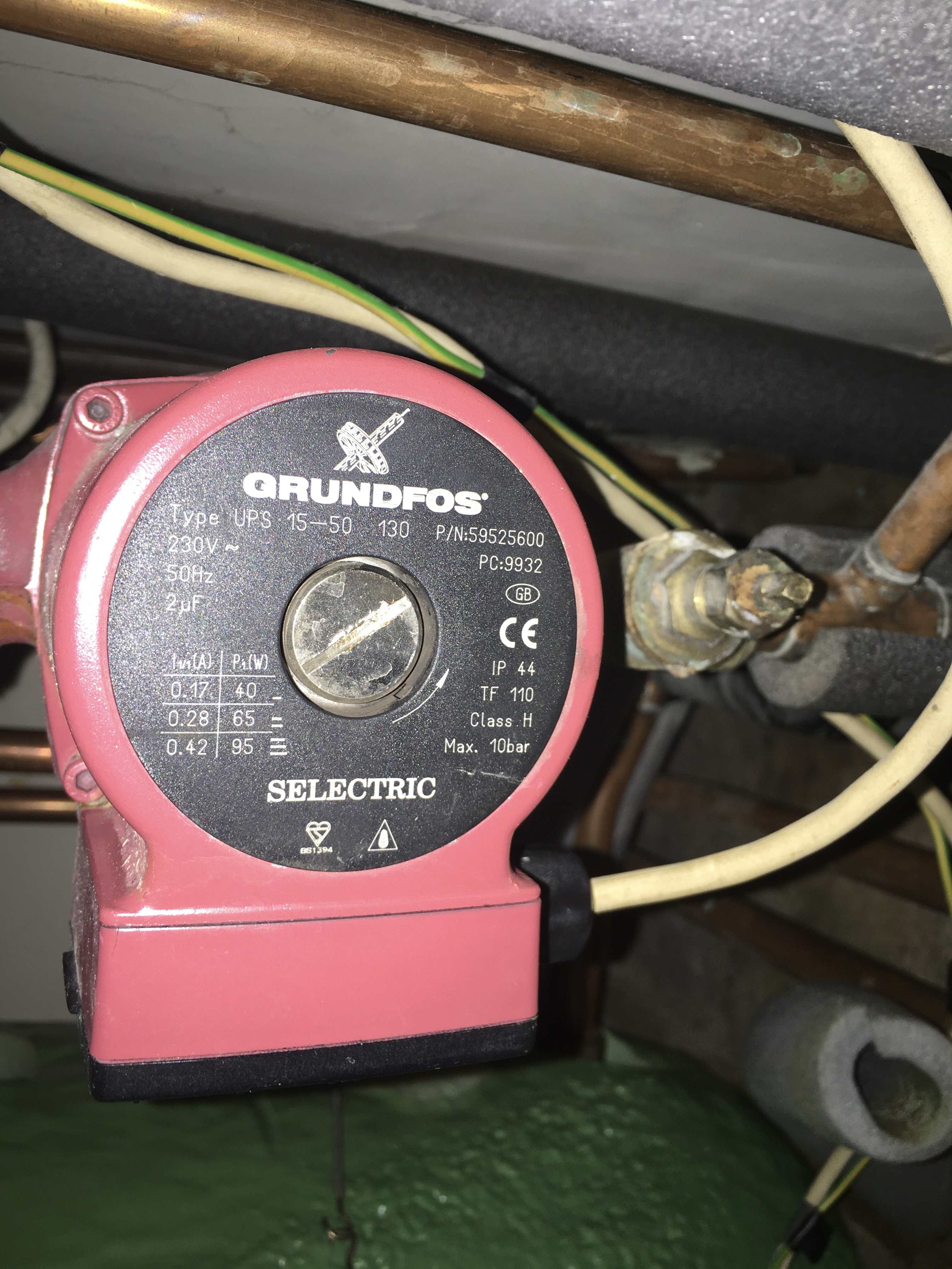

John Carroll Posted March 4, 2025 Posted March 4, 2025 (edited) What is the exact model of your old Grundfos??. If it is a A rated pump (or not) we can then compare the various modes/settings with the DAB. What model/setting was/is the Dab Evosta3? on to give you 14W, 3.0M, 0.5ms/hr According to its pump curves, the Evosta3 in CP2 (constant pressure) mode will give a flow rate of 0.5m3/h at @ 3.0M head but requires 16W, in CC2 (fixed speed) mode it will only flow 0.2m3/hr @ 14W and also 3.0M, a bit strange. Edited March 4, 2025 by John Carroll

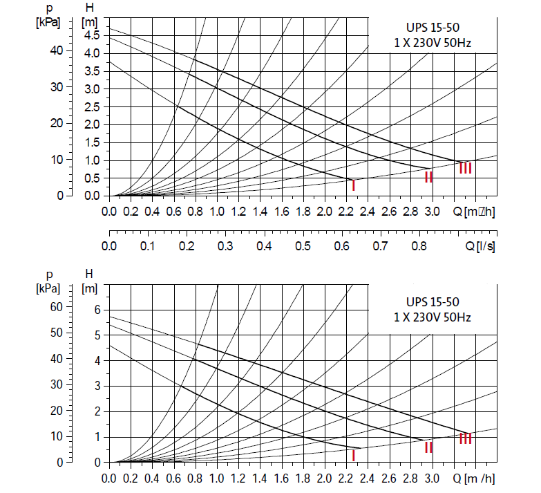

John Carroll Posted March 5, 2025 Posted March 5, 2025 (edited) When you say (Evosta3?) speeds 1&2, which mode are you in, both CP2 & PP2 will have similar outputs at both settings but FS (fixed speed) 2 will draw ~ 21W at a flowrate of 0.5m3/hr and will draw 9W closed valve power. The Selectric, if I have the correct pump curves will circulate 0.48m3/hr @ 2.76M speed1, 0.55m3/hr @ 3.63M speed2 and 0.59m3/hr @ 4.18m speed 3, all close if using a evosta benchmark of 0.5m3/hr @ 3.0M. Selectric 5M Edited March 5, 2025 by John Carroll

John Carroll Posted March 5, 2025 Posted March 5, 2025 (edited) 5 hours ago, marshian said: I'm running the Evosta 3 pump on Constant Differential Pressure - data from pump display on speeds 1 & 2 posted earlier That's really interesting and if I can summarise "for the cheap seats" (Me) Effectively order in terms of flow is Evosta3 Speed 1 - 0.3 m3/hr Grundfos Speed 1 - 0.48 m3/hr Evosta3 Speed 2 - 0.5 m3/hr Grundfos Speed 2 - 0.55 m3/hr Does explain why system doesn't like Evosta3 speed 1 and why I feel Evosta3 Speed 2 is a little noisier (system noise) than my old Grundfos was and sort of validates my want /need for the old pump from a noise perspective Please note - the noise aspect is me being really (expletive deleted)ing picky and to be honest from an energy usage perspective I should probably go back to the Evosta3 on speed 2 as I could run that pump for 4 hours (15 w) for the same consumption as the Grundfos chews thro (58 w) I'm pretty sure the consumption would be ~40w on speed 1 if it worked but as it doesn't and I don't know why My gut tells me I need a setting between speed 1 and speed 2 on the Evosta3 Thanks for you input @John Carroll Try PP2 which may by my calcs may give a flowrate of just less than 0.4m3/hr at 1.9M. Edited March 5, 2025 by John Carroll

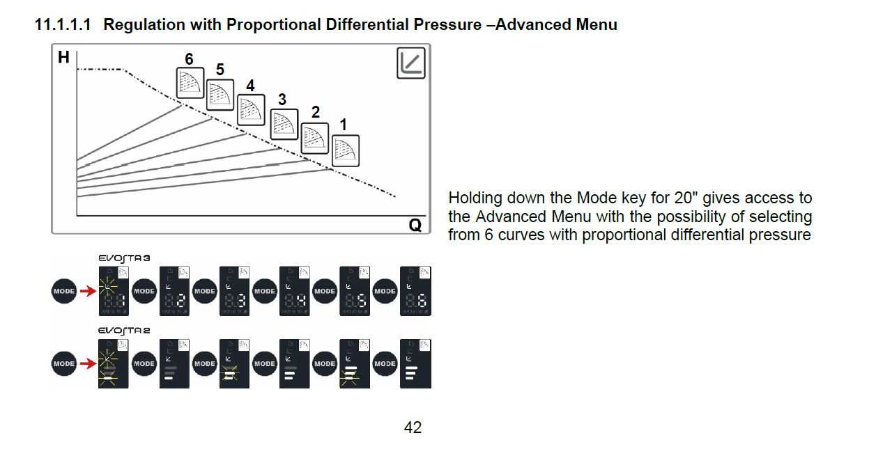

marshian Posted March 5, 2025 Author Posted March 5, 2025 9 minutes ago, John Carroll said: Try PP2 which may by my calcs may give a flowrate of just less than 0.4m3/hr at 1.9M. Hmm - I’ll need to check the destuctions but from memory that mode has 6 settings not 3 - accessed by a long 20 sec press - I was going to try that if the grundfos pump turned out to be a bust (which it did) but at least I now know why I favoured the old pump on speed 1 and why I have to run the new pump on 2 rather than 1 thank you @John Carroll
marshian Posted March 5, 2025 Author Posted March 5, 2025 50 minutes ago, marshian said: Hmm - I’ll need to check the destuctions but from memory that mode has 6 settings not 3 - accessed by a long 20 sec press - I was going to try that if the grundfos pump turned out to be a bust (which it did) but at least I now know why I favoured the old pump on speed 1 and why I have to run the new pump on 2 rather than 1 thank you @John Carroll Yep I think I was right Couldn't find pump curves for these settings but I'm going to assume that it gives a finer level of step than the std 3 positions
John Carroll Posted March 5, 2025 Posted March 5, 2025 2 hours ago, marshian said: Yep I think I was right Couldn't find pump curves for these settings but I'm going to assume that it gives a finer level of step than the std 3 positions DAB Evosta-2-3-Installation-and-Operation-Manual_UK.pdfDAB Evosta-2-3-Installation-and-Operation-Manual_UK.pdf The standard (3) PP settings are the ones I'm looking at, you have to press the setting button for 20 secs or so i think to get the advanced (6) PP settings. You can see by my trusty spreadsheet that it looks like PP2 will give a flowrate of 0.4m3/hr ish @ 1.95M Dab Evosta3 PP2.xlsx
marshian Posted March 5, 2025 Author Posted March 5, 2025 4 minutes ago, John Carroll said: DAB Evosta-2-3-Installation-and-Operation-Manual_UK.pdfDAB Evosta-2-3-Installation-and-Operation-Manual_UK.pdf 3.42 MB · 4 downloads The standard (3) PP settings are the ones I'm looking at, you have to press the setting button for 20 secs or so i think to get the advanced (6) PP settings. You can see by my trusty spreadsheet that it looks like PP2 will give a flowrate of 0.4m3/hr ish @ 1.95M Dab Evosta3 PP2.xlsx 18.13 kB · 0 downloads Yep I get that you are using the std 3 settings I'm just musing that 0.4m3/hr might be a smidge lower than the old grundfos - now that might be perfect but and on the basis that the six settings might give a finer control 1 of 3 = 1 of 6 2 of 3 = 3 of 6 3 of 3 = 6 of 6 Then maybe 4 of 6 closer to the 0.48 of the old grundfos pump 1
John Carroll Posted March 5, 2025 Posted March 5, 2025 Where can/do you see the max/min settings for all the 6 PP settings?, the manual only shows the 3 standard PP settings data?. Anyway if you can see it somewhere just change the settings in the spreadsheet.
marshian Posted March 5, 2025 Author Posted March 5, 2025 Just now, John Carroll said: Where can/do you see the max/min settings for all the 6 PP settings?, the manual only shows the 3 standard PP settings data?. Anyway if you can see it somewhere just change the settings in the spreadsheet. They aren't specified in the manual - I'm taking an educated punt Not difficult to establish the settings - the pump will tell me what they are Just need to start it on the lowest of the 6 and give 5 mins between each change to stabilise the pump
John Carroll Posted March 5, 2025 Posted March 5, 2025 6 minutes ago, marshian said: They aren't specified in the manual - I'm taking an educated punt Not difficult to establish the settings - the pump will tell me what they are Just need to start it on the lowest of the 6 and give 5 mins between each change to stabilise the pump Very good, on any PP setting, does the Evosta3 show the actual pump head?. (as well as the flowrate & power). I have the Rolls Royce of PP & CP settings on my Wilo Yonos Pico where the settings can be incrementally changed in 0.1M steps to give almost infinite "control" but the head is only displayed while its being changed, no big deal really but nice to have displayed if available.
marshian Posted March 5, 2025 Author Posted March 5, 2025 4 minutes ago, John Carroll said: Very good, on any PP setting, does the Evosta3 show the actual pump head?. (as well as the flowrate & power). I have the Rolls Royce of PP & CP settings on my Wilo Yonos Pico where the settings can be incrementally changed in 0.1M steps to give almost infinite "control" but the head is only displayed while its being changed, no big deal really but nice to have displayed if available. Yes regardless of the mode selected - all three parameters are displayed 1
marshian Posted March 7, 2025 Author Posted March 7, 2025 DAB pump swapped back in On PP setting (3 speed selection) CH Proportional differential pressure regulation Speed Watts Head (m) m3/Hr 1 6.5 1.3 0.4 2 9.3 1.9 0.5 3 17.0 3.4 0.5 On PP setting with the optional 6 speed selection CH Proportional differential pressure regulation Speed Watts Head (m) m3/Hr 1 6.5 1.3 0.4 2 8.5 1.7 0.4 3 9.5 1.9 0.5 4 10.0 2.0 0.5 5 11.0 2.2 0.5 6 17.0 3.4 0.5 I've set it to PP2 (of 6) Sitting in the living room all I can hear is the wall clock ticking...............
