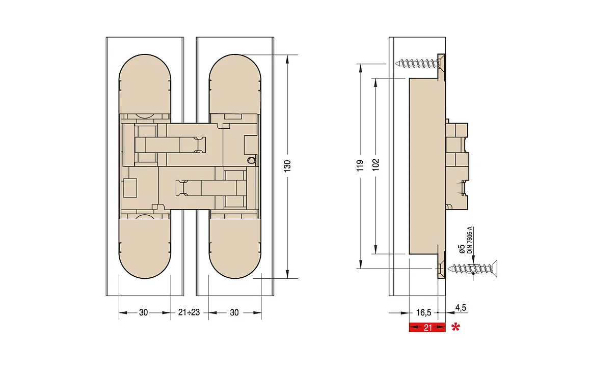

The other thing is that we are thinking of having flush doors using this sort of hinge - https://www.carlislebrass.com/ceam-3d-concealed-hinge-1266
It look like quite a deep hole needs to be routed for a hinge like this - would that be an issue with a chipboard door?
No. Doors typically have a solid lipping on the sides, top, and bottom. The thickness of the lipping generally depends on the quality of the door - my XL Joinery doors have 20mm solid oak lippings. The hinges you mention would screw into the solid oak lipping as per the diagram below.
