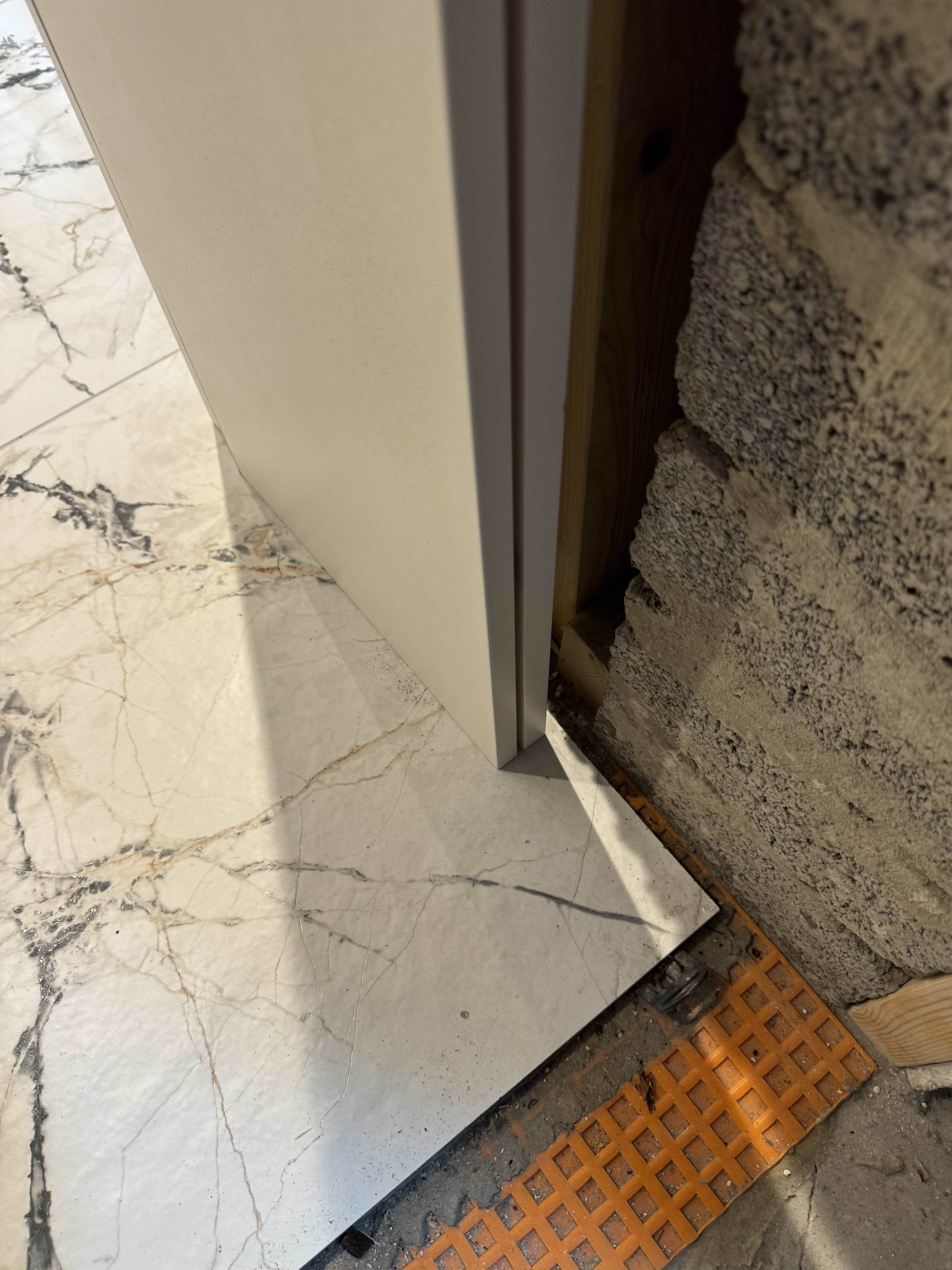

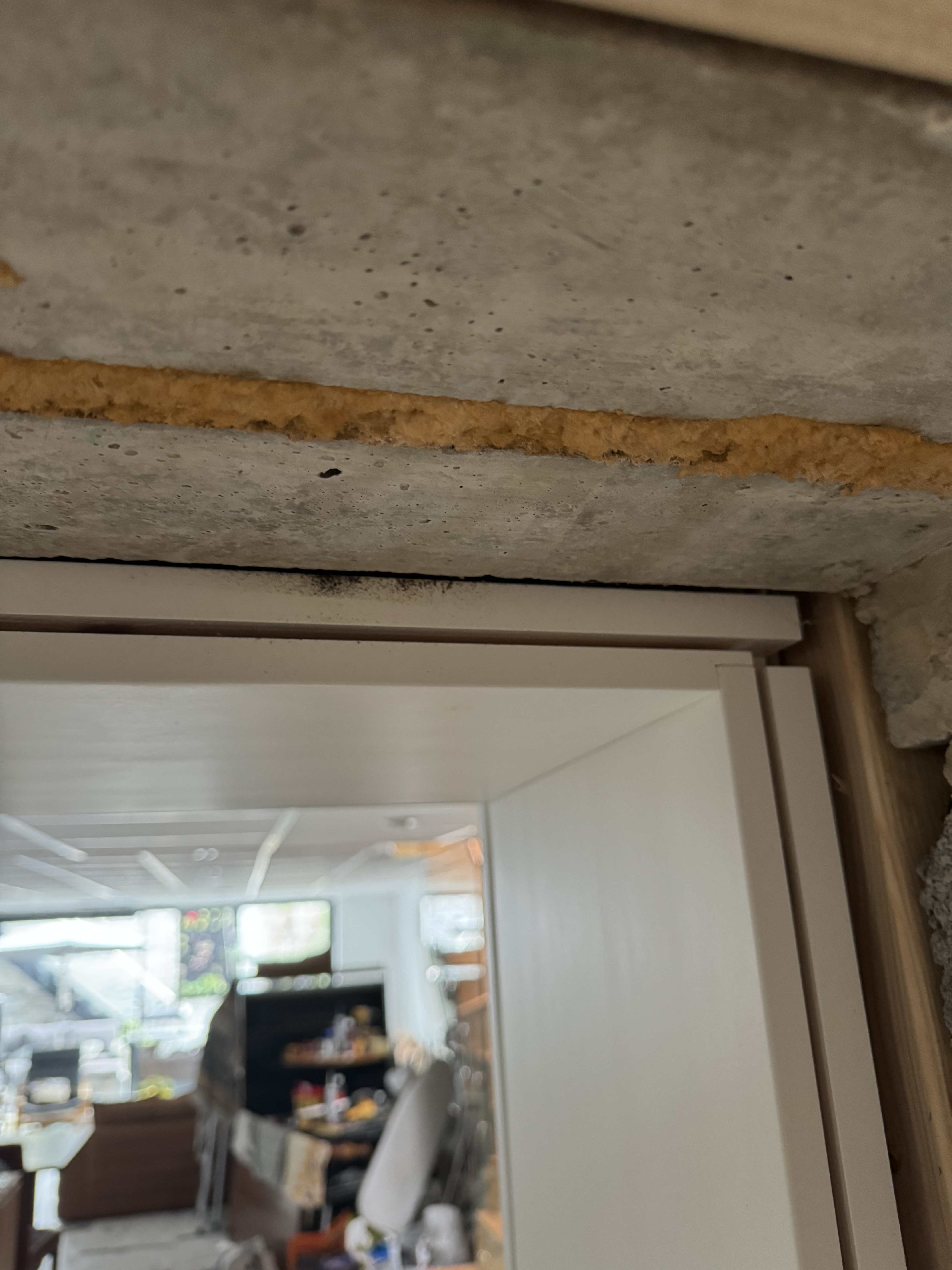

Pocster Posted September 12, 2024 Posted September 12, 2024 Custom door frame . Left and right 50mm of play Top though no play . Company and myself measured via FaceTime so not sure who is liable ! Concrete lintel at the top so no joy there My options are only 1 that I can see . That header piece needs maybe 5mm sheared off it . I can’t take lining apart as glued . How can I sheer it ? Multi tool will take forever and be a right bodge !!

Pocster Posted September 12, 2024 Author Posted September 12, 2024 (edited) 1 minute ago, joe90 said: Can you not remove 5 mm from the bottom of the verticals? Door.? Nope because the door won’t fit . There’s zero play height wise . Plane the top whilst swearing ? Edited September 12, 2024 by Pocster
Pocster Posted September 12, 2024 Author Posted September 12, 2024 1 minute ago, joe90 said: Door The doors all nice and laminated even around the ends ( fire door ) no way I can do that and it looks good .

joe90 Posted September 12, 2024 Posted September 12, 2024 You could plane the 5mm off (electric planer) or use a concrete grinder on an angle grinder to remove 5mm from the lintel but this will make a real mess. Using an electric planer allows you to set depth of cut (max 3mm usually) so several cuts. How are you going to finish the ceiling next to the lintel? 1
Pocster Posted September 12, 2024 Author Posted September 12, 2024 17 minutes ago, joe90 said: How are you going to finish the ceiling next to the lintel? Don’t know yet haven’t made that bit up
