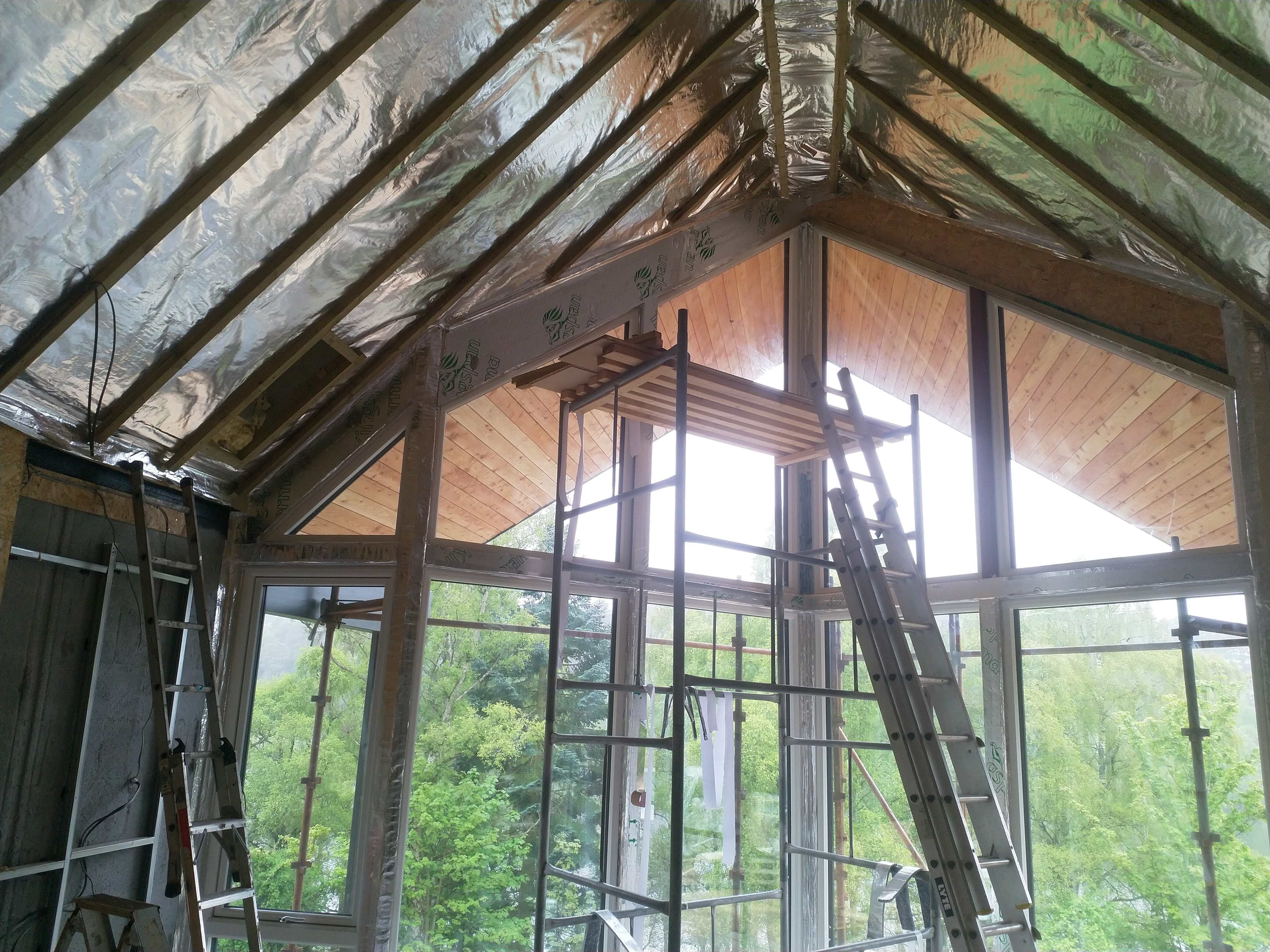

We weren't allowed timber battens and had to replace with metal U channel, in that area also. I would add 50mm steel battens (U channel) and then use 50mm Rockwool Flexi or similar, attach the plasterboard to U channel, do the same across the whole two walls - you can see them on the left hand wall.IMG_20210524_162456.thumb.jpg.866a0980691fac950a5a77e45f9c7e04.jpg

@JohnMo The stove crew did say to make sure there's no timber battens anywhere near the area. The planned plasterboard is 37.5mm (12.5 PB and 25 PIR. The 50 metal battens with plasterboard would bring us to 62.5, only 3cm more so might be worth it.
Remember PIR is more flammable than wood. If they don't want wood not due PIR will be any good either.
