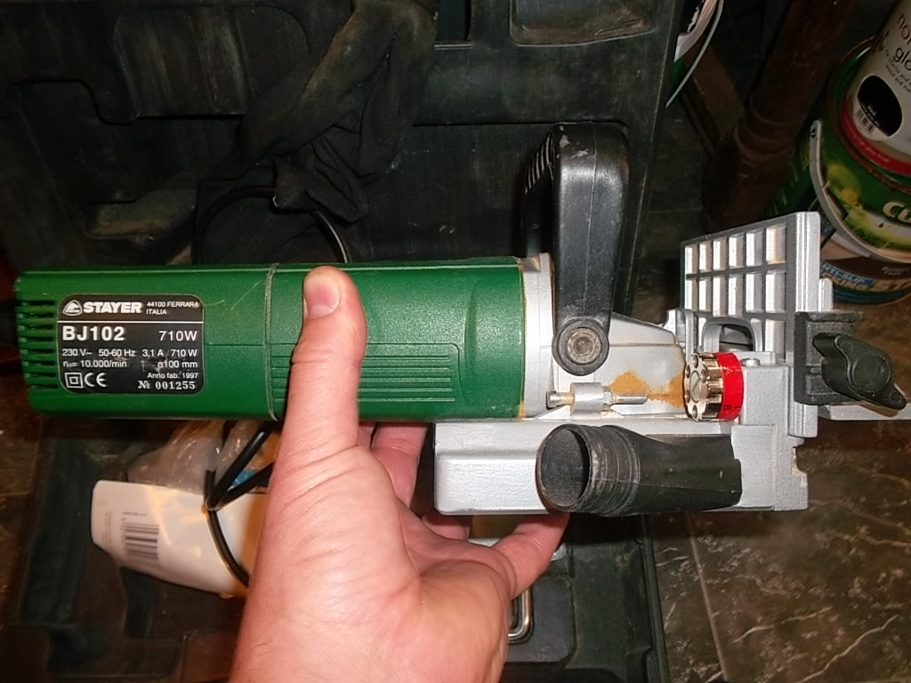

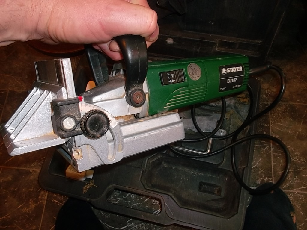

Onoff Posted June 13, 2016 Share Posted June 13, 2016 Asked my chippy mate if I could borrow his biscuit cutter and he said I could HAVE his "second" one (which he was given) as he doesn't really use it. Can't think of the make of his favoured one which I've used before but back then he mentioned me having this one I've now got. For him it's the fact it doesn't have a rack & pinion on the height adjustment . But STAYER, never heard of it and can't find out much about the make, any good? Link to comment Share on other sites More sharing options...
Nickfromwales Posted June 13, 2016 Share Posted June 13, 2016 It was free, who cares! http://stayer.es/en/ ? 1 Link to comment Share on other sites More sharing options...

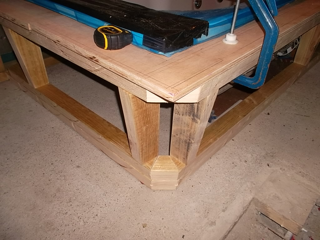

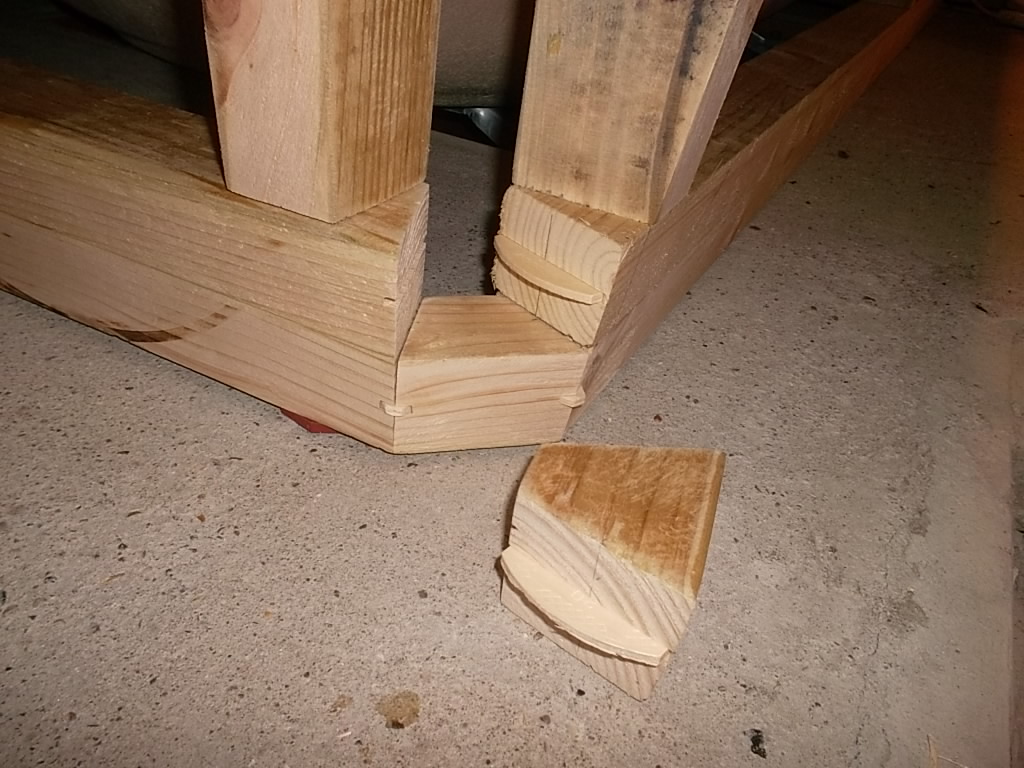

Onoff Posted June 13, 2016 Author Share Posted June 13, 2016 Seems to be doing it's job on the tapered bath carcass. All loose at the mo and unglued but getting there: Link to comment Share on other sites More sharing options...
