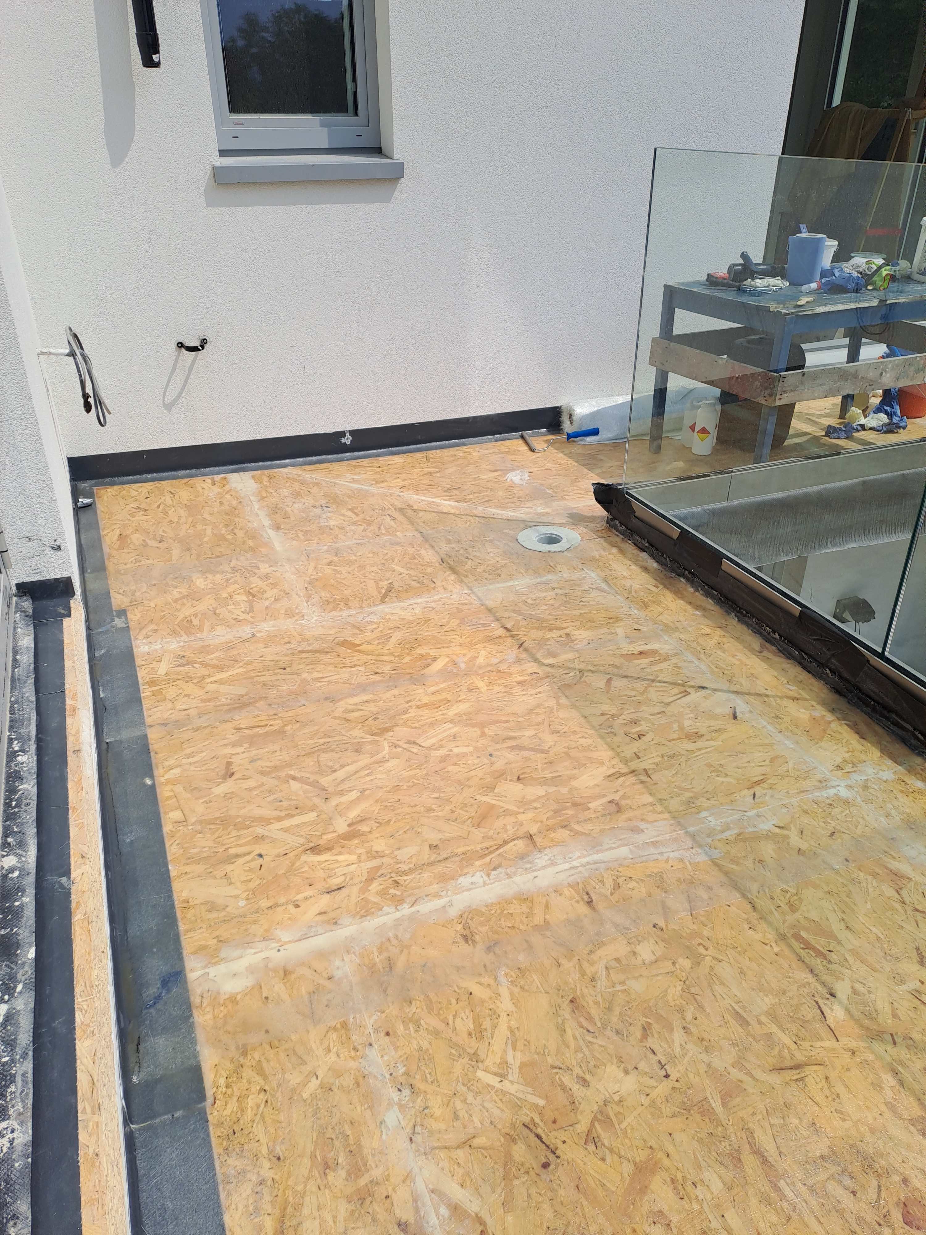

Our balcony was originally meant to be block and beam but the waterproofing detailing was far too complicated. B&B, screed, insulation, OSB, membrane, then paving. In the end I got the engineer to redesign in timber /steel and I simply did a fibreglass covering before paving on pedastals. Final build was 150x50mm C24 joists at 400mm CC (set in steel frame), 18mm OSB, then coverings. There's a bit of bounce from the 6m wide main steel, but just there to remind you you're not on the ground.
