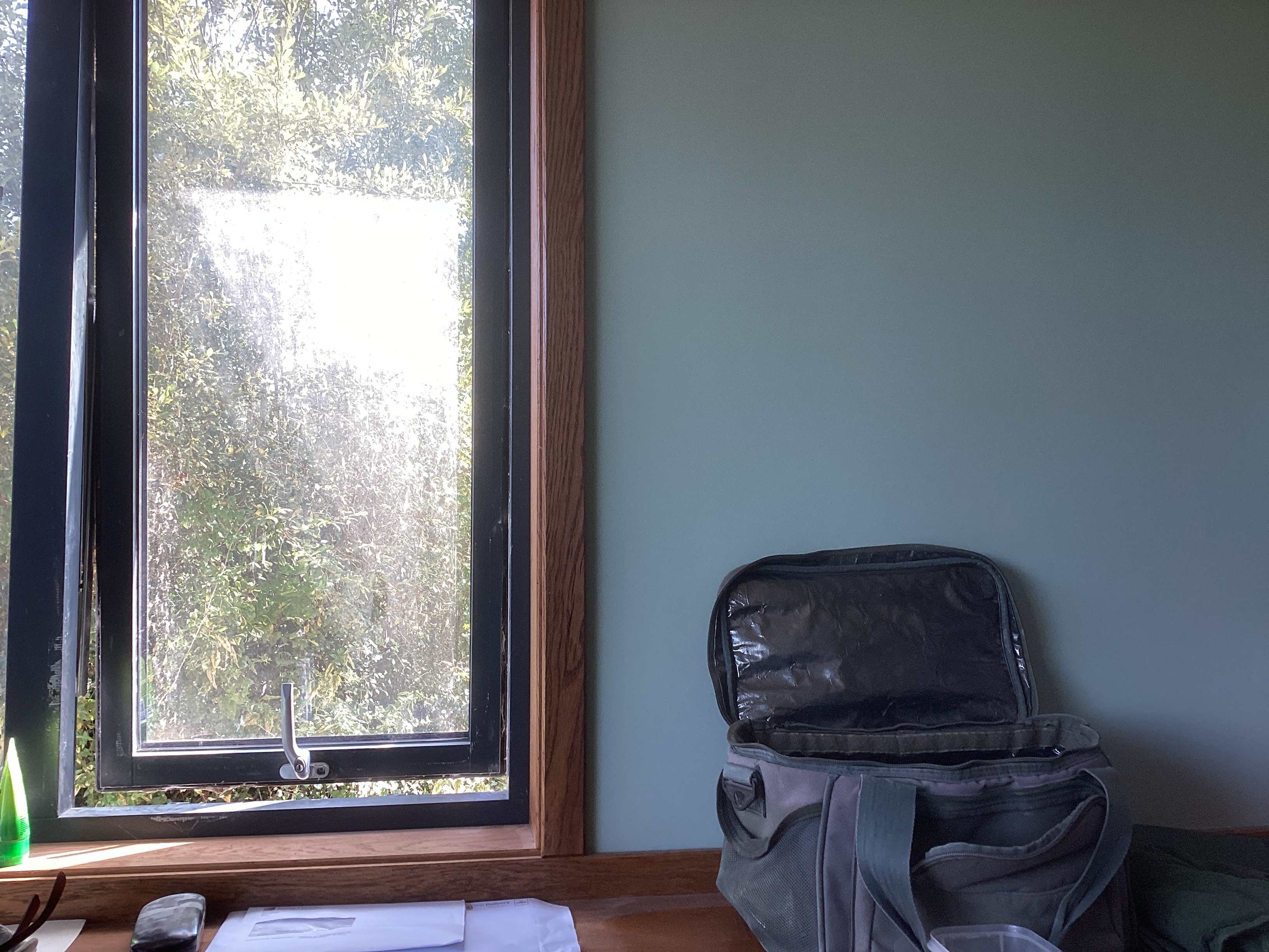

Sarah29 Posted August 30, 2024 Share Posted August 30, 2024 Hi- Could a thought please be offered on this. We are midway refurbishing an old property and we would like to have architrave around our window reveals coming down to meet an oversailing window board.....purely for aesthetics purposes. The plasterer wants to plasterboard/skim bead/skim the window reveals, which sounds sensible. But in this case, how would the architrave work....would it just be glued around the skim beaded window reveal? I've never seen it done like this before but it sounds reasonable unless I'm missing something? thanks! S Link to comment Share on other sites More sharing options...
nod Posted August 30, 2024 Share Posted August 30, 2024 You need to fix a timber lining around the reveal before plastering Then put the Arc on the same way as you would for a door Link to comment Share on other sites More sharing options...
Russell griffiths Posted August 30, 2024 Share Posted August 30, 2024 just use a good quality no nails type stuff, hold in place with a bit of masking, or stick a couple of pins in it if you have anything to nail to Link to comment Share on other sites More sharing options...
