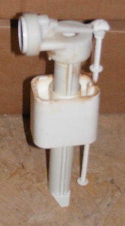

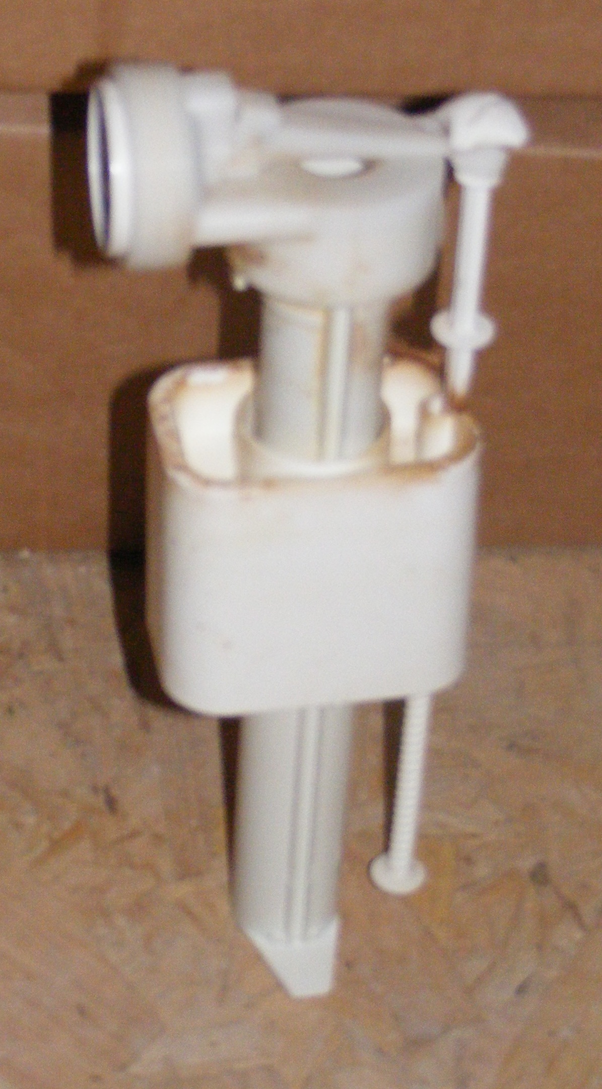

ProDave Posted November 2, 2017 Share Posted November 2, 2017 I need to replace this toilet cistern fill valve with an IDENTICAL one. It's from a Macdee concealed cistern. The only markings on the fill valve itself as a very poorly stamped name that I think might be Kiwa or similar It's leaking from a split in the plastic. I need to replace it with an identical one so it will screw onto the bit still attached to the cistern. It would be an extremely difficult job to replace that bit. This part has a male thread about 43mm diameter that screws onto the bit still attached to the cisterm. Link to comment Share on other sites More sharing options...
Onoff Posted November 2, 2017 Share Posted November 2, 2017 Cr@p photo there Dave! Is it one of these: http://www.toiletspares.co.uk/compact-inlet-valve.html 2 Link to comment Share on other sites More sharing options...
ProDave Posted November 2, 2017 Author Share Posted November 2, 2017 4 minutes ago, Onoff said: Cr@p photo there Dave! Is it one of these: http://www.toiletspares.co.uk/compact-inlet-valve.html Yes that looks to be the one. the Cistern originally came from BES but while they still list the cistern, they don't sell a spare fill valve. That one looks close enough to take a punt and buy one. Link to comment Share on other sites More sharing options...
Onoff Posted November 2, 2017 Share Posted November 2, 2017 (edited) I think it's a Macdee DVC100...now discontinued...I think. EDIT: So if you can find one...buy it! Edited November 2, 2017 by Onoff Link to comment Share on other sites More sharing options...

ProDave Posted November 2, 2017 Author Share Posted November 2, 2017 I have ordered the one that @Onoff linked to above. The issue is it must fit the fixed part that is there, otherwise I have a very awkward crawl through a very small gap to reach the pipe fitting to change the inlet piece. (the top access I left for this cistern was not as generous as it really should have been) Link to comment Share on other sites More sharing options...
Onoff Posted November 2, 2017 Share Posted November 2, 2017 5 minutes ago, ProDave said: I have ordered the one that @Onoff linked to above. The issue is it must fit the fixed part that is there, otherwise I have a very awkward crawl through a very small gap to reach the pipe fitting to change the inlet piece. (the top access I left for this cistern was not as generous as it really should have been) Only other place I've found so far, pricier though! https://www.cisternfittings.co.uk/macdee-compact--side-entry--inlet-float-valve-dvc100-8264-p.asp Link to comment Share on other sites More sharing options...
ProDave Posted November 6, 2017 Author Share Posted November 6, 2017 It arrived today. Fitted easilly and all working again. A big thank you to @Onoff Link to comment Share on other sites More sharing options...
