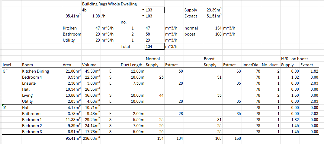

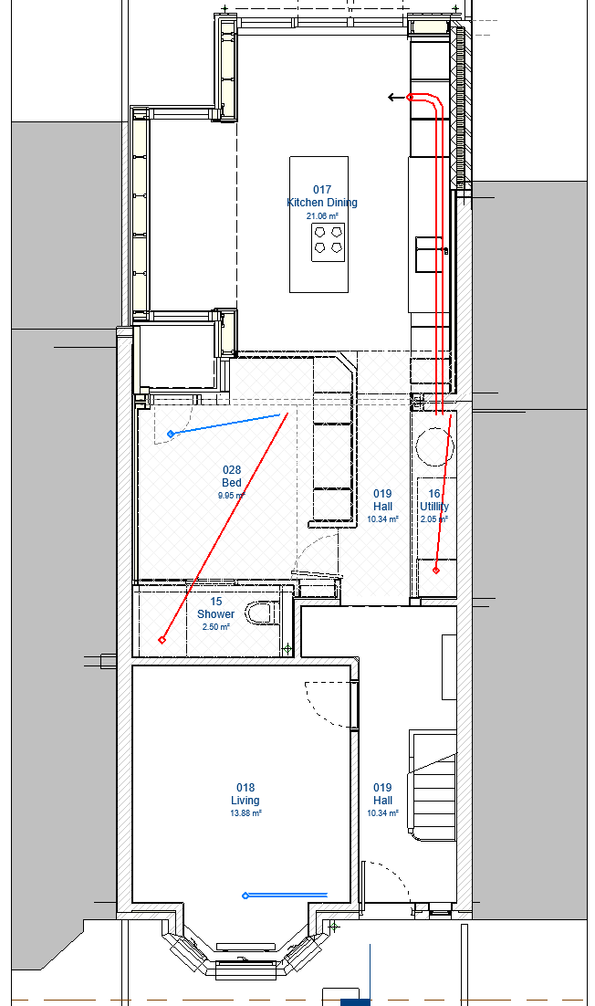

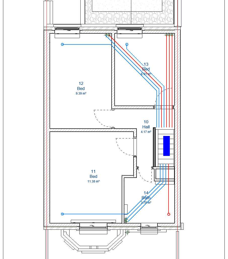

hoymp Posted August 28, 2024 Share Posted August 28, 2024 Hi all I am new here. Currently, I am extending and remodelling our terrace house. I have had a look at the design for an MVHR system see below my calculations I have based it on information that I have put together from looking on this forum Originally I had thought that I would use 75mm ducting. However, looking into it a bit more it might be better to use 90mm. if my calculations are correct then I would only need to double up the ducts to the Kitchen and Living room. I have looked at the most onerous duct (Kitchen) and have evaluated that the Pa over 12m with three bends and vent would be approximately 50. if anyone can see if I am going off track I would love to know. Below is the ducting and outlet for the ground floor. Red for extract, blue for supply Bellow ducting and outlet for the first floor Link to comment Share on other sites More sharing options...

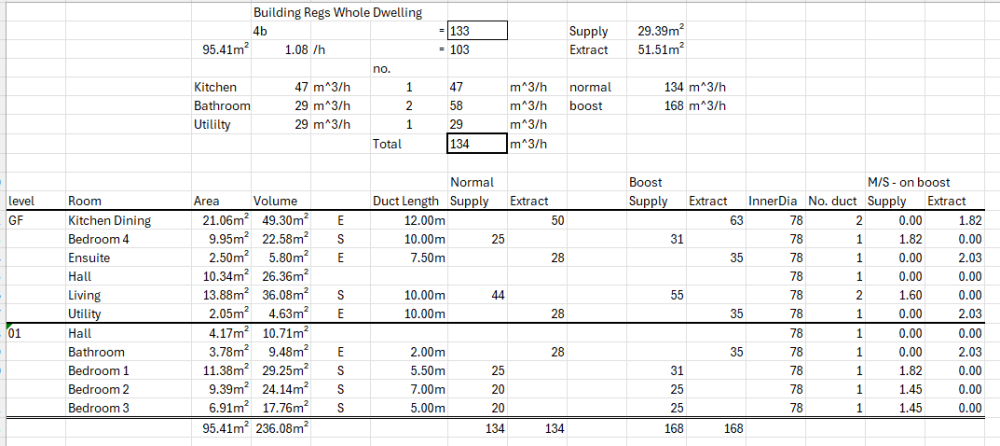

Sparrowhawk Posted August 29, 2024 Share Posted August 29, 2024 (edited) Welcome, it looks good and you have nice slow flow rates on boost. Slower than I'll have on boost at "design speeds" (not to be confused with this forum's idea of actual running speeds). You have a unit problem in column D of the spreadsheet, Volume needs ^3 not ^2. I'm not sure with J2 and J3 what those figures are? Are you planning to mount the MVHR above the stairs or in the loft? Good luck with getting the ducts coming out of it as you've drawn, I am fast coming round to the idea of home-made distribution box (as someone on this forum has done) to get the pipes out in the directions I need! Edit: Looking at your floor plans, which direction do the first floor joists run? Side to side? Edited August 29, 2024 by Sparrowhawk Link to comment Share on other sites More sharing options...

hoymp Posted August 29, 2024 Author Share Posted August 29, 2024 @Sparrowhawk Ah yes sloppy copying of cell format with the volume. J2 and 3 were me looking at the areas of the rooms with supply or extract. not that they do anything really in the table. the MVHR unit will be placed in the loft and the duct runs are most definitely diagrammatic at the moment. As for the joist direction, there is a false ceiling, which enables the ducts to run free. other than an annoying steel beam the only place the direction is an issue is the living room. I am currently looking at the duct routes to see if I simplify it Link to comment Share on other sites More sharing options...

Sparrowhawk Posted August 29, 2024 Share Posted August 29, 2024 @hoymp existing false ceilings, lucky you! Downstairs I am having to add 2, and flex ducting into one run between parallel joists across the more open plan section to prevent having to lower the lounge/dining room ceiling. Link to comment Share on other sites More sharing options...
hoymp Posted August 30, 2024 Author Share Posted August 30, 2024 @Sparrowhawk Indeed the false ceiling was a design decision to hide any ducting and steel. Link to comment Share on other sites More sharing options...
