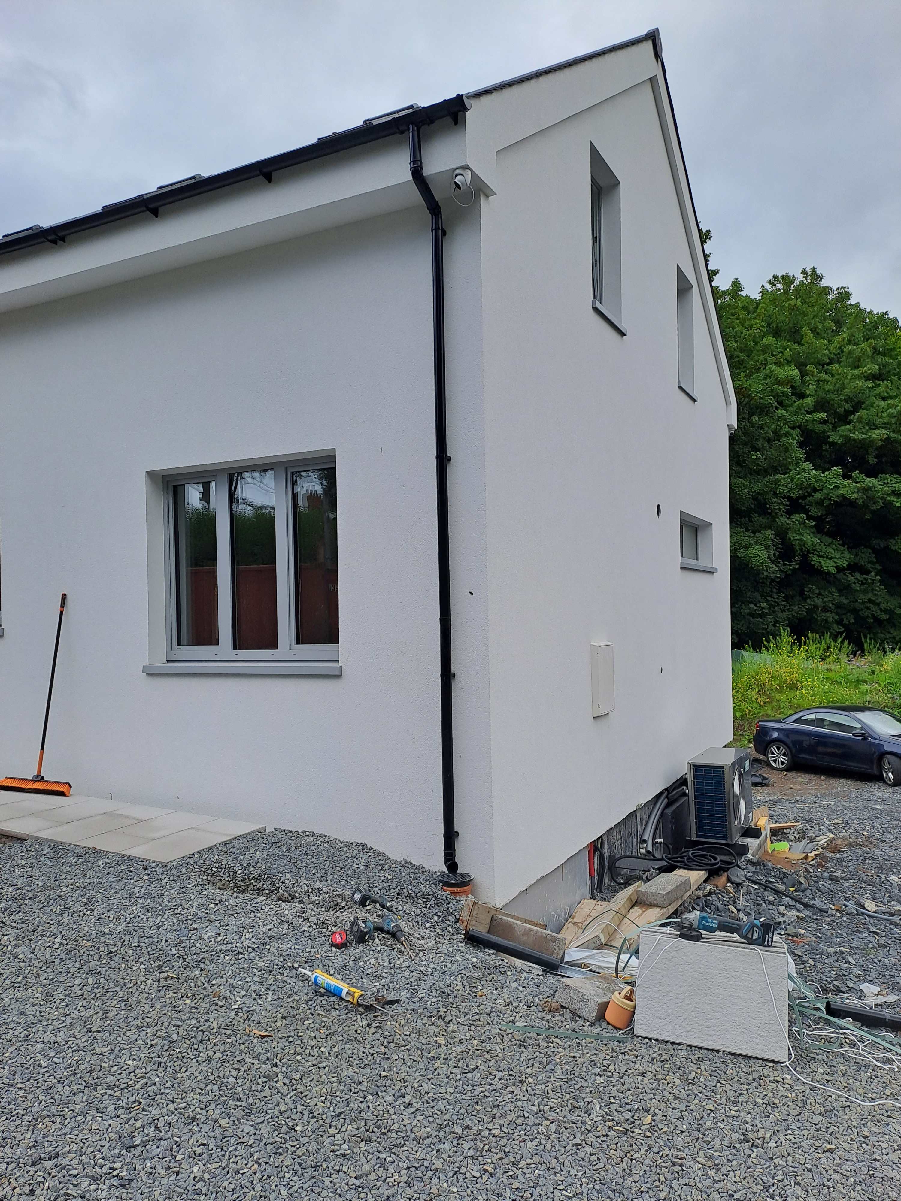

We put render board and rendered right up to the slates (with 8mm foam tape between)20220725_115607.thumb.jpg.26cc1b537ef6f1a587df909d1b597c97.jpg

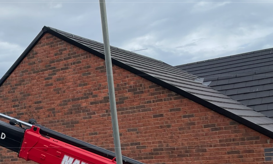

we went with a continuous dry verge. Have a look at Kytun; ours was supplied by LBS, sized to match their tiles.
