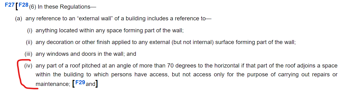

JohnMarsden Posted August 23, 2024 Posted August 23, 2024 (edited) Hi - I haven't found this answer searching the forums and I'm therefore wondering if it's a stupid question. We are having a loft conversion done. Part of the new roof is mansard. Does the mansard wall count as a wall or a roof for insulation purposes? Edit: I should say, the loft conversion has mansard 'walls' leading up to a flat roof. Edited August 23, 2024 by JohnMarsden Clarification

Mike Posted August 23, 2024 Posted August 23, 2024 From memory, it's treated as a wall if >70°, as a roof if <70°. But do verify that - I may be wrong / it may have changed.
DevilDamo Posted August 23, 2024 Posted August 23, 2024 5 hours ago, Dave Jones said: is the outside covering tiles or brick ? Why does that make a difference? A slate or tile hung dormer is a wall and that’s not brick. @JohnMarsden It would be treated as a wall.
JohnMarsden Posted August 24, 2024 Author Posted August 24, 2024 18 hours ago, DevilDamo said: Why does that make a difference? A slate or tile hung dormer is a wall and that’s not brick. @JohnMarsden It would be treated as a wall. Thanks! For anyone in the same position, the legislation is here: It is also reflected in the fire regs - essentially, the definition of what constitutes an "external wall" is quite clear now. cheers
