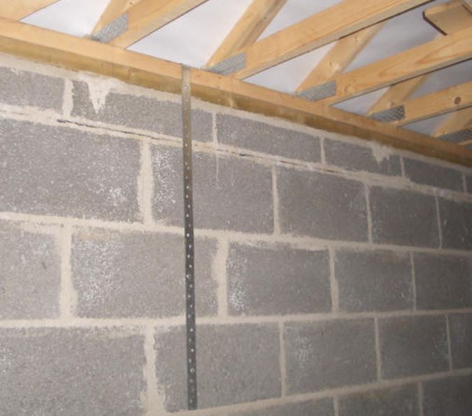

Ian Posted November 1, 2017 Share Posted November 1, 2017 2 minutes ago, MikeGrahamT21 said: 200mm each side, so more than the 150mm suggested. It was more of a what if something isn't right (since i built it myself), I don't think theres anything wrong, but my wife is seriously ill at the moment, and I cant be doing with any hassle if you get my meaning. I don't think you've got anything to worry about as nothing is going to collapse even if you get a meter of snow. The risk with lightly loaded roofs is usually to do with wind uplift - the timber wallplate for the roof should be strapped down using this type of restraint strap: Link to comment Share on other sites More sharing options...
