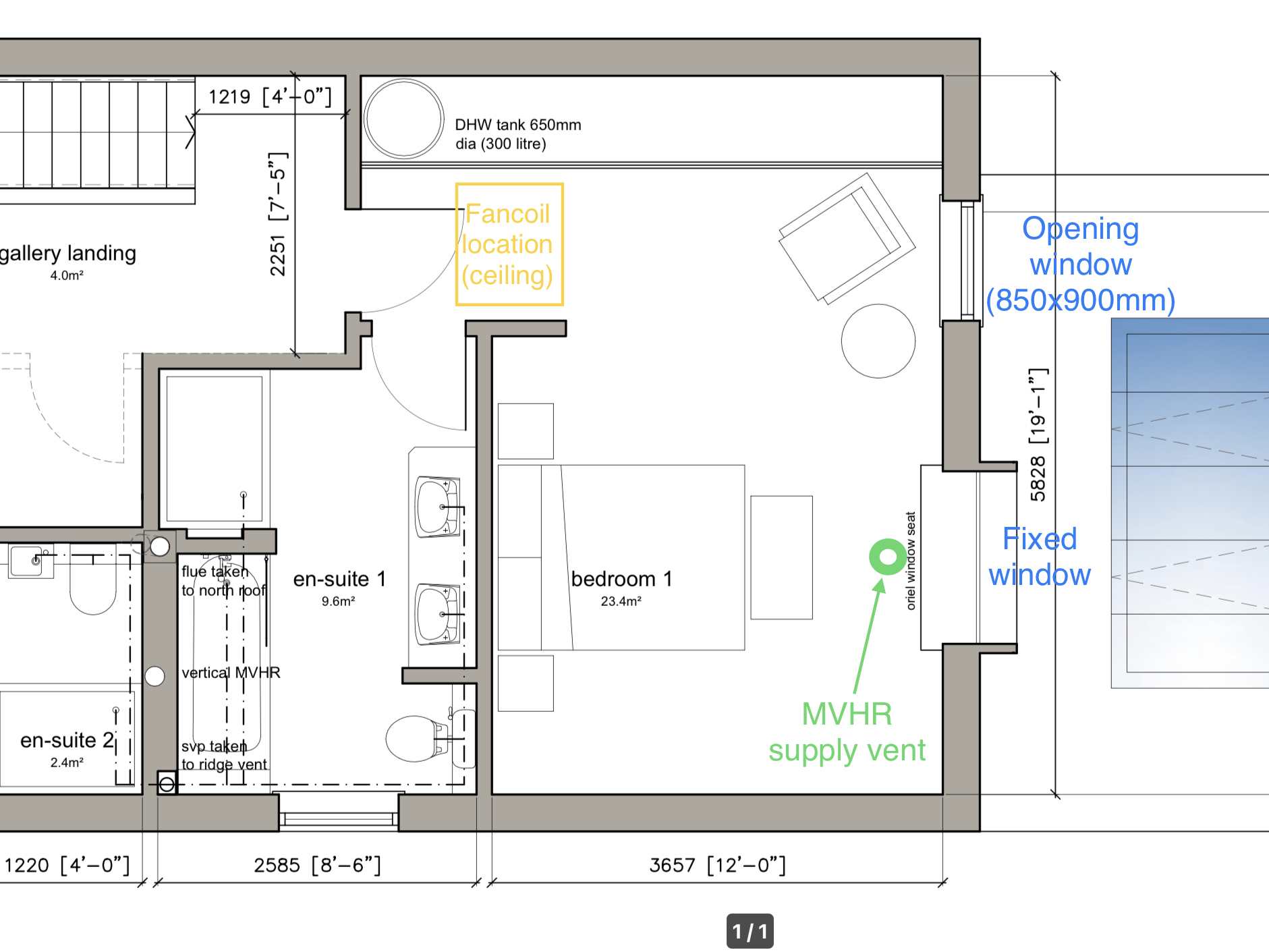

Given the recent warm weather it's not terribly surprising that bedroom cooling has been exercising our grey cells.  (I wonder if there's a correlation between time of year for design and later overheating issues?)
We are committed to ASHP (with some cooling capability) running wet UFH downstairs and electric UFH in all bathrooms, with electric points in case but otherwise no heating provision upstairs.  But we also want cooling in the bedroom.
The most sensible option for us appears to be a single fancoil unit in our bedroom itself, probably built into the ceiling, but I thought it prudent to ask you guys for a sanity check - not on me, I failed that long ago - but on the plan/placement.
The thinking is:
The fancoil location is good for pipes inc. the condensate drain, and is away from the bed and behind a wall to help with the noise.
Under normal conditions the fancoil will be dormant and not needed for heating though it could of course be turned on to heat.
Under mildly warm conditions front and rear windows will be opened to deal with the excess heat.
When running the fancoil will push through a lot more air than the MVHR.
When in overheat conditions the doors to the bedroom and ensuite will be closed, as will the windows, and the MVHR will keep the air fresh without carrying away all the cool air.
So folks, is the above a good plan?

I would do a simple wall mount one. Panasonic, Cool Energy or Myson are good ones. Condensation drain, yes if flowing 5 Deg water. But if the water is going through the UFH also a flow temp of 14ish would be better to keep away from condensation issues in the floor. If you don't involve the floor in the flow path you will need a 50 plus litre buffer also to stop short cycling. Our summer house fan coil has been running for the last 6 weeks, pipes not insulated and no condensate drain, zero drips.
Just run the pipes from your UFH manifold as a separate loop.

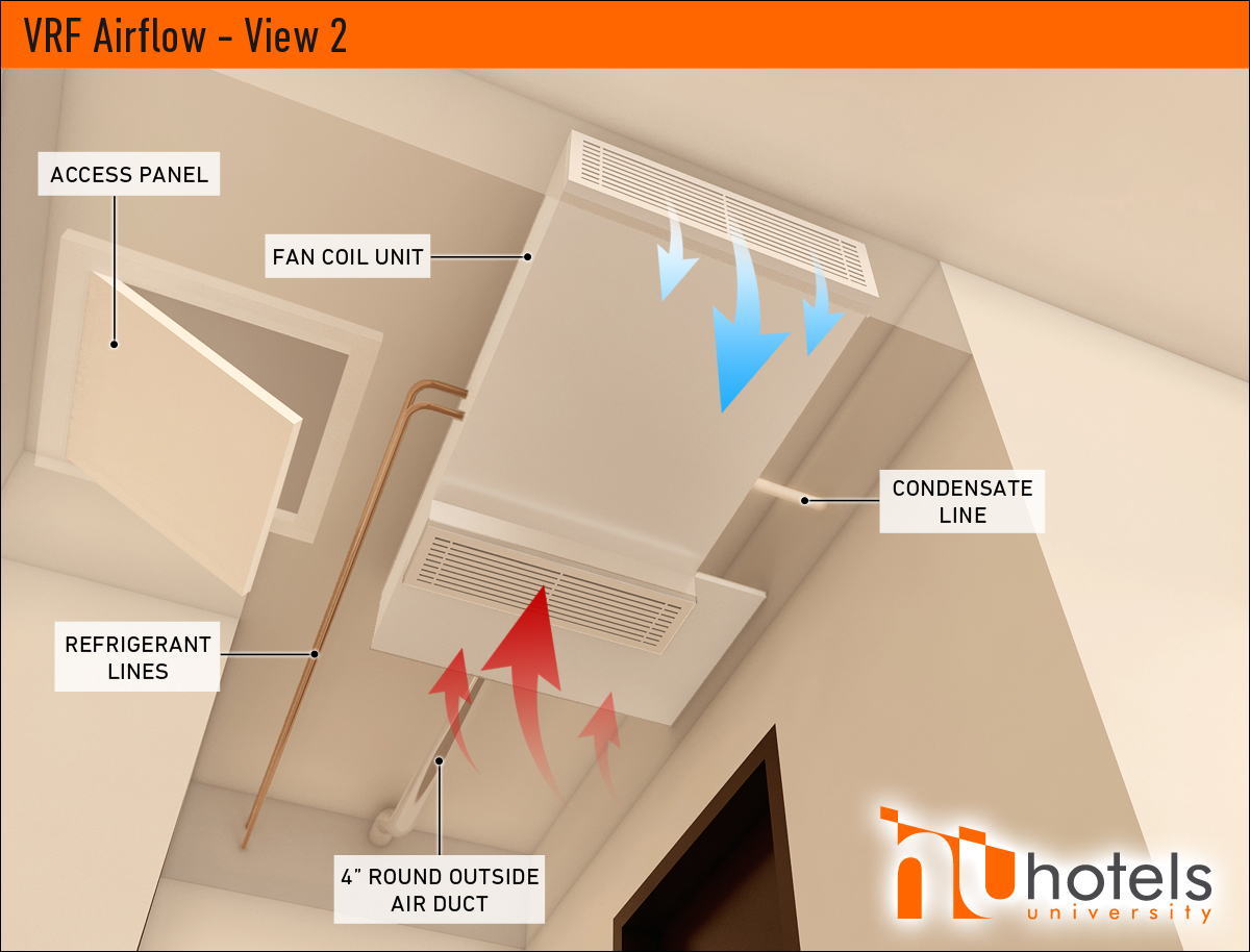

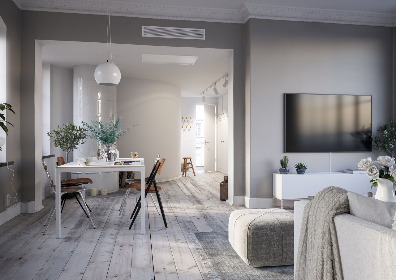

It's where you see them in most hotels. Dropped ceiling in the entryway to the room with access hatch and then the grille at the end so it's pushing into the room rather than down from above.
Here's a few images I have saved in the little "FCU" knowledge base for inspiration...

I did wonder if that would be enough to cool the bedroom sufficiently.  I kinda thought well, a drain won’t cost much to allow for condensate if used that way, and allowing for a zone valve to be able to be added later if needed to isolate just the fancoil would be easy too.
As for the volumiser, if five days a year for a few hours a day the heat pump ran short cycles would that matter?
In the 90’s I used travel lodges a fair bit and these ideas have reminded me of them.   I can never remember hearing the airflow or being much too hot in summer either.   Winter was different, they used have the heating on crazy.
So I’ve unconsciously been inspired by a cheap roadside hotel chain.  Outstanding!  😕

So I need to find one that fits above our bedroom door…

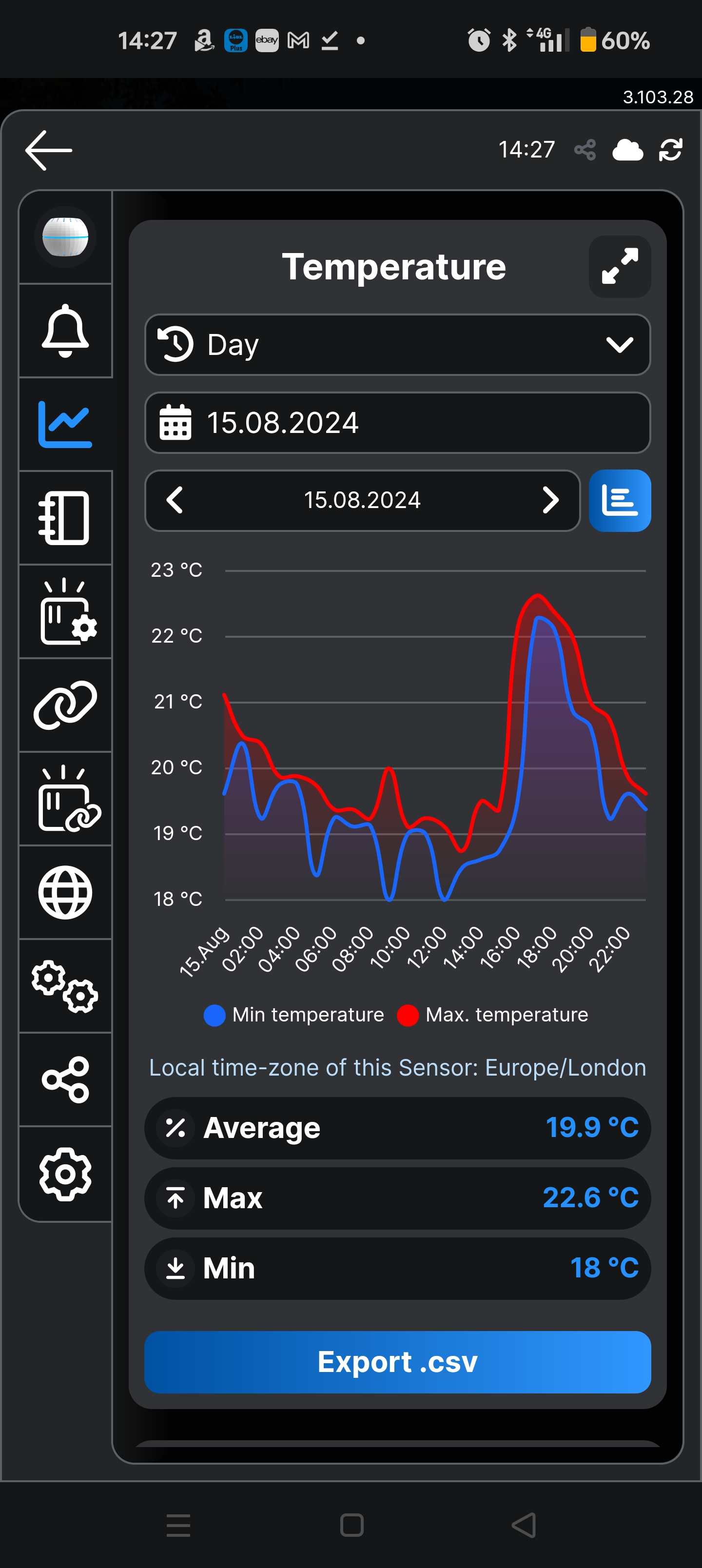

That's all @Dave Jones is using and says his bedroom remains well cool. This our summer house, you can clearly see when the sun came out with a steep rise in temp and equally quick drop in temp.
Screenshot_2024-08-18-14-27-58-92_0ac2addf979993c0e494aa40c40dbf6e.thumb.jpg.576bc1a5c21167f4a2a348c3f4b5e377.jpg

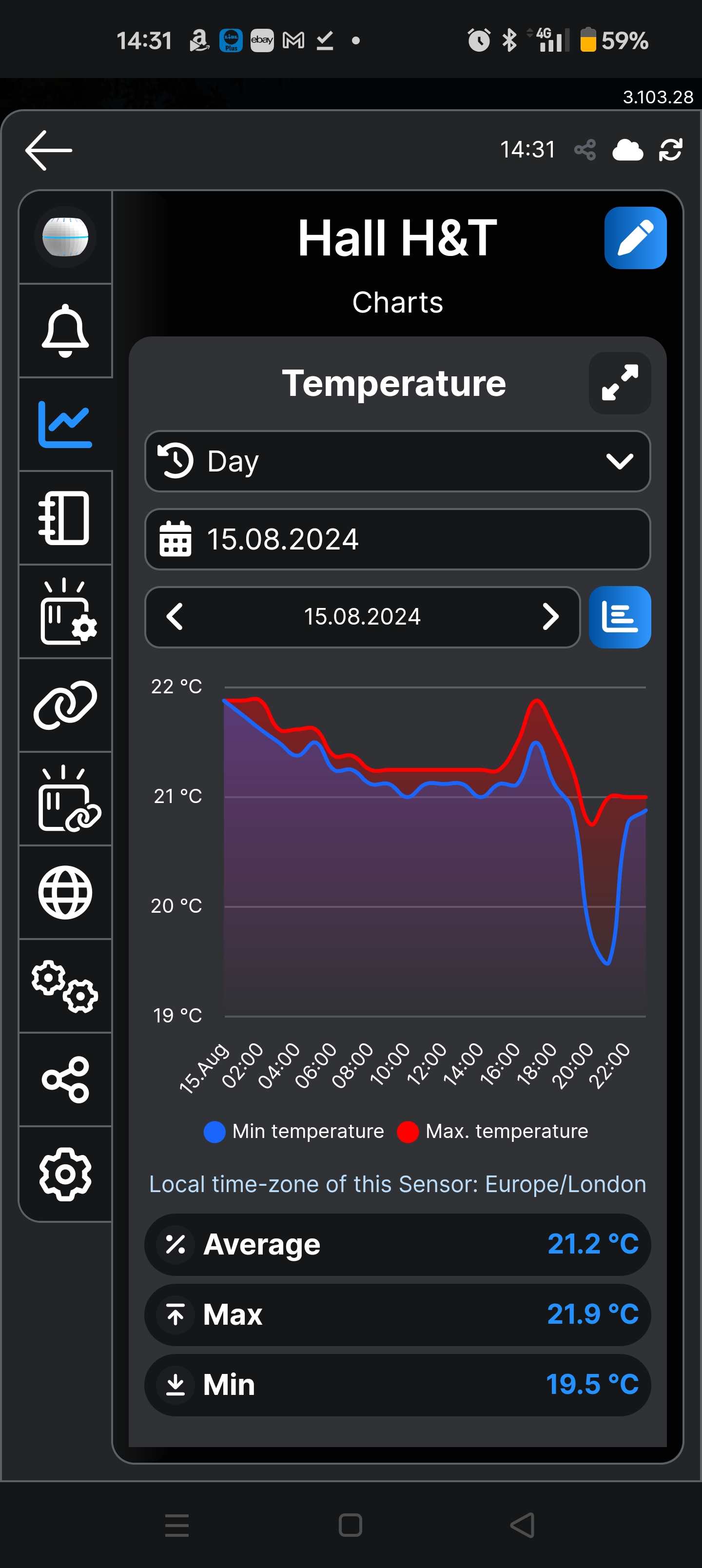

 For comparison the house (temperature sensor in hall) house is just UFH cooling. The real spike in the living room is much bigger, but the cooling effect similar.
Screenshot_2024-08-18-14-31-15-68_0ac2addf979993c0e494aa40c40dbf6e.thumb.jpg.ef06f910c51e31703f8e47e099b7e43d.jpg

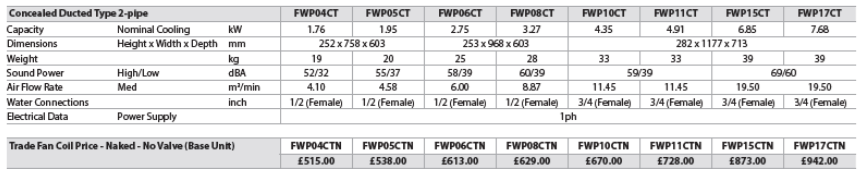

Another Daikin option is now available here: https://www.oceanairuk.com/product/daikin-fwp-2-pipe-medium-static-duct-fan-coil-unit-2-61kw-6-47kw/
It's actually the FWP-CT now, not -AT. (I swear these manufacturers much change model numbers more frequently than they sell units lol.)
This is the MSRP for the naked 2-pipe FCU, just takes mains input and (I believe) a 0-10V signal to control speed -- it's inverter driven so very fine grained controlled over speed vs the old 3-speed coils, which is great for anyone like me integrating it with advanced controls (e.g. Loxone). Per JohnMo comment, I put separate thermistor on the flow pipework to shut off the fan if there's a slug of warm water in the pipe (i.e. when switching from DHW reheat back to cooling)

@G and J is this a 2-story building, with bedroom(s) on the 1st floor?
Don't underestimate the effort it takes to add one FCU to an otherwise simple ASHP+UFH install. If you run the FCU on its own, it will have a much lower emitter size (and water volume) than the UFH so you're very likely to create short-cycling on the heat pump. Further if you run it as 2 zones you'll now need 3 circulation pumps, low loss header and electronic mixing valve (per Ecodan MIs at least, fairly typical) vs just one pump directly driving the UFH. And you lose some amount of cooling when the system switching to DHW and back. And you have to meticulously insulate all the ASHP pipework to avoid condensation (or only run it at 15+ degrees, which looses a heck of a lot of the cooling capacity which in turn increases risk of short cycling)
If doing it all again I'd look very seriously at adding a separate A2A system for the bedroom. While it maybe a bit more in materials, it really isn't that much, and the installation cost may actually be less simply because it's such a well known process to install a mini-split a2a. Can still use the ASHP for slab cooling, but this is then a very simple control system.
And this way you get two separate systems so still have some heating/cooling even if the other breaks.

Yep, two storey our bedroom upstairs and not huge solar gain as not huge windows and few south facing.  I’m now erring towards a single zone UFH and fancoil run just above dew point as per @JohnMo.  So at least I’ve got someone to blame lol
I could mount an A2A cooling unit in our cold loft, I guess I’d worry about noise and servicing it, as it’ll be a crawl through fink trusses by the time I’ve laid all the insulation up there with some crawl boarding on top.
If you are happy to self install (or can find someone else competent enough to do it professionally) this will work, just bear in mind if doing it above dew point it's much more of a low-and-slow cooling power rather than the icy hurricane-on-demand you can command on an a2a.
And always run UFH+FCU together to minimize short cycling.

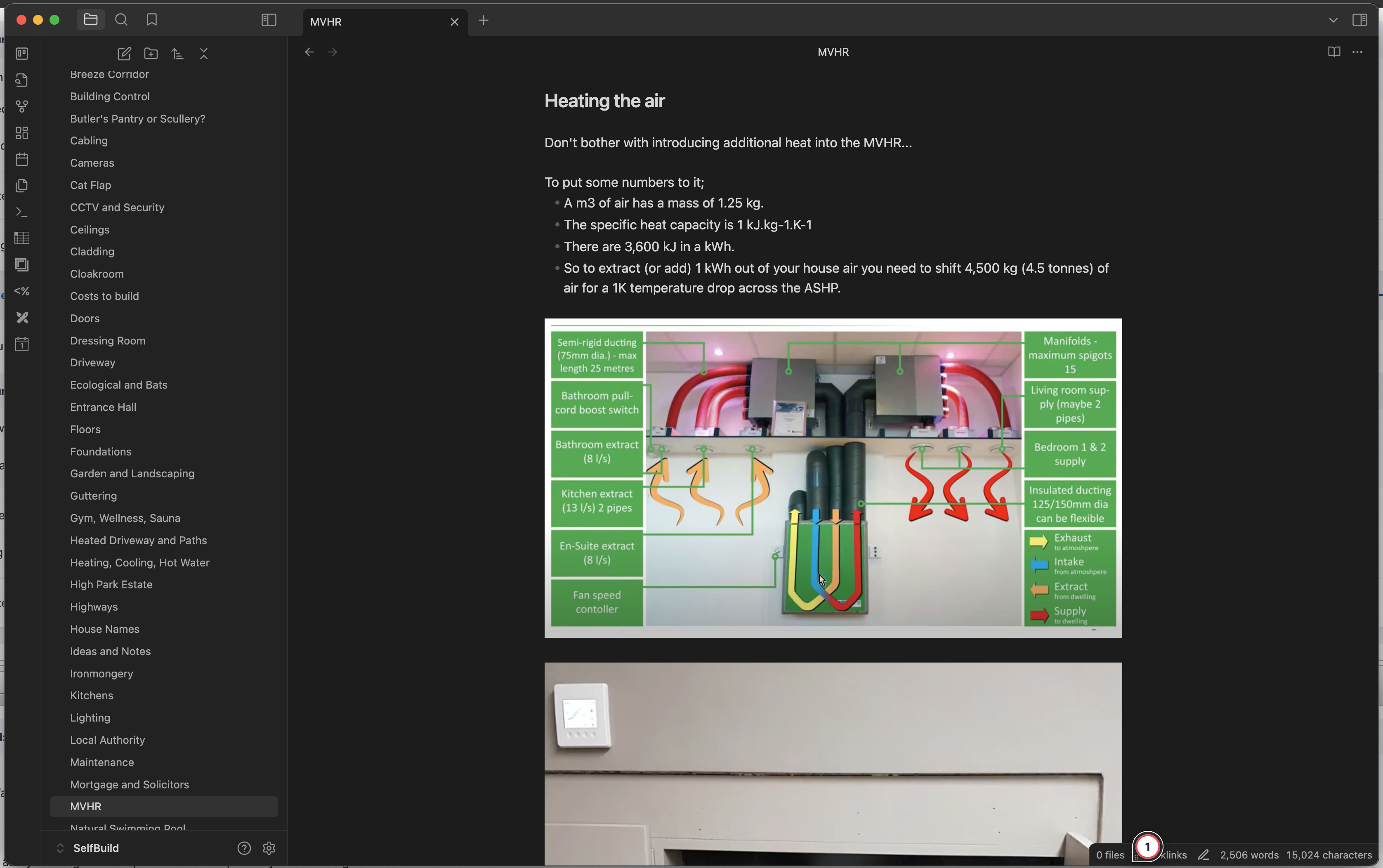

The knowledge base I referred to is my own. I use a package called Obsidian to create a Personal Knowledge Management (PKM) system for all sorts of things, but I have a dedicated one for everything related to the (hopefully) future build.
Those particular images came from this site though https://www.hotelsuniversity.com/hotel-hvac-systems-what-are-my-options-part-2/
