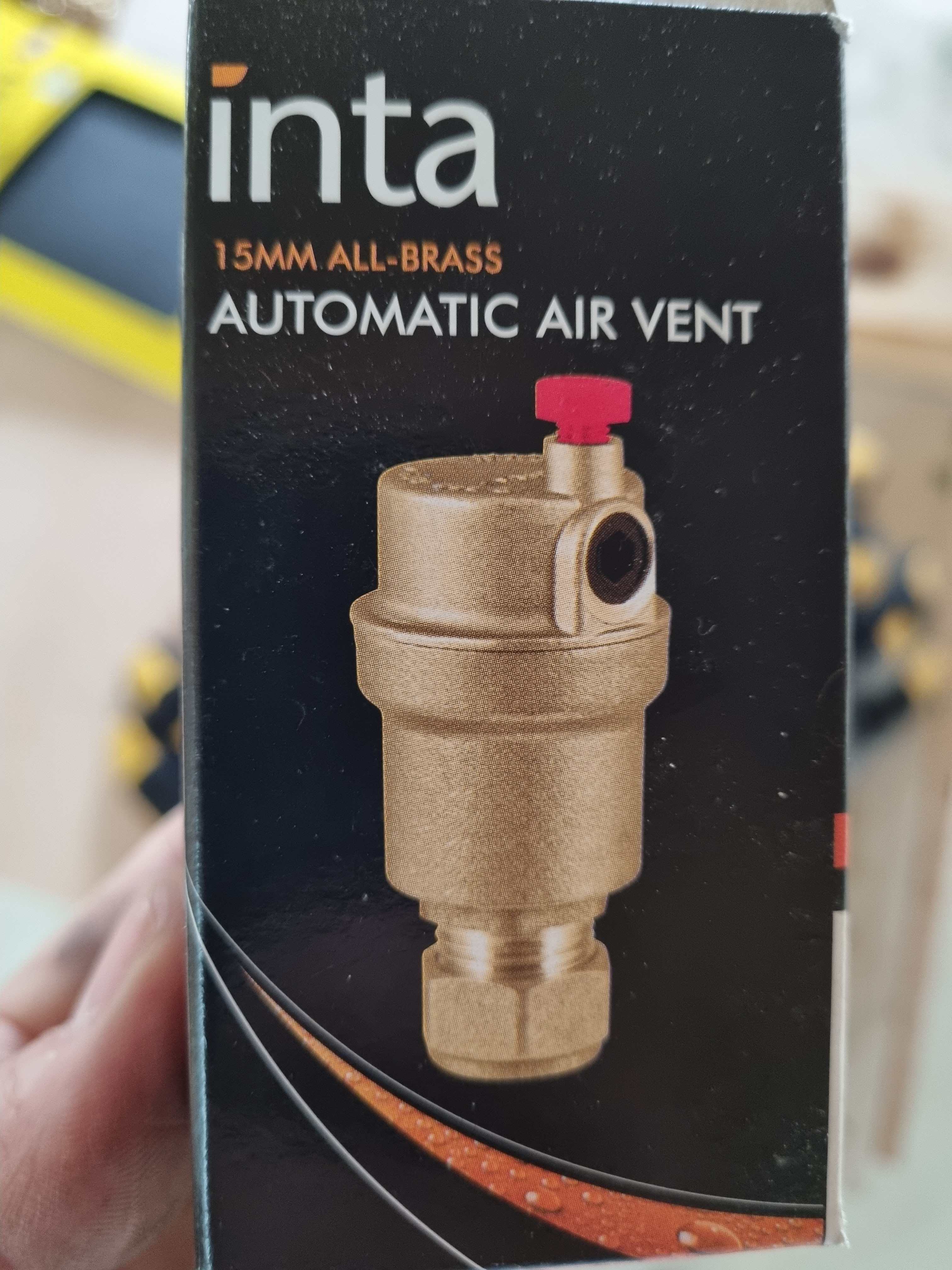

BotusBuild Posted August 15, 2024 Posted August 15, 2024 Should the red plastic knurled screw on the top be loosened off after fitting? left tightened? removed?
BotusBuild Posted August 15, 2024 Author Posted August 15, 2024 And before you ask, there are no instructions in the box
BotusBuild Posted August 15, 2024 Author Posted August 15, 2024 Thank you @dpmiller, that seemed the logical way.
JohnMo Posted August 15, 2024 Posted August 15, 2024 Mine is loose while bleeding the system, then I tightened. Then for the next month or so, i released every so often to let any caught air escape, afterwards re tightened. 1
