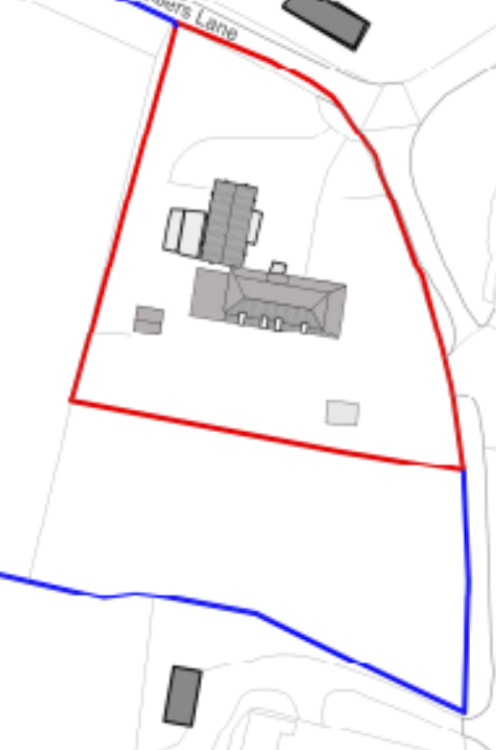

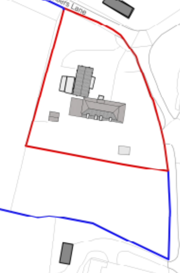

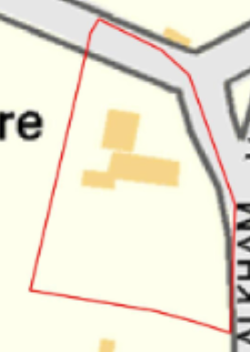

Drellingore Posted August 15, 2024 Author Share Posted August 15, 2024 11 hours ago, mjc55 said: how much of a change is it? Apologies for the wildly-varying image sizes. You can kinda match the shapes by the bottom/south boundary. Here's the ecology red line: ...and this is the smaller red line area from the site plan: Link to comment Share on other sites More sharing options...

joe90 Posted August 15, 2024 Share Posted August 15, 2024 With my build/plot the red line was the residential curtalige and a blue line an agricultural field belonging to us, the ecological survey however included the field although we could not/want to build on it. Is this not your case with the blue line? Link to comment Share on other sites More sharing options...
mjc55 Posted August 15, 2024 Share Posted August 15, 2024 2 hours ago, Drellingore said: Apologies for the wildly-varying image sizes. You can kinda match the shapes by the bottom/south boundary. Here's the ecology red line: ...and this is the smaller red line area from the site plan: So the build is not going to affect the extra area so I would not change anything. Link to comment Share on other sites More sharing options...

Drellingore Posted August 15, 2024 Author Share Posted August 15, 2024 4 hours ago, mjc55 said: Small-scale self-build and custom build development of no more than 9 dwellings and on a site which has an area no larger than 0.5 hectares is exempt from BNG. Ooh, interesting! The smaller red line is only 0.33ha; the larger red line for the ecology is 0.62ha. 3 hours ago, garrymartin said: Is it a Class Q? Nope, it's a non-designated heritage asset in a National Landscape, so I don't think permitted development rights exist. That said I had previously believed that permitted development rights were invalid in AONBs/NLs by default, and I never found a source for that, so it could just be folklore? 3 hours ago, garrymartin said: Was it validated before 2nd April 2024? Sadly not, t'was done in June. 3 hours ago, TommoUK said: if you get the red line wrong, and as a result inadvertantly include land outside your ownership, the application is technically invalid Ooh, that's good to know! Thankfully in our case that's one of the few oversights I've not yet made. Link to comment Share on other sites More sharing options...

Drellingore Posted August 15, 2024 Author Share Posted August 15, 2024 @mjc55 Thanks for pointing that out, I think it might be the answer here. I've emailed the planning officer to point this out, and ask 'can we just disregard it entirely, and save a lot of time and effort on both sides'. I know they're massively over-worked so hopefully this line of thinking will appeal to them. Then all I've got to do is deal with the Environment Agency who are objecting on the grounds that we haven't supplied a drainage strategy - despite the previous application getting approved without one, and despite us having a permit that we were going to mention when we got around to supplying a drainage strategy. To paraphrase Dana White: "every day shit will happen, and I will deal with it" 😆 The obstacle becomes the way, and all that! Link to comment Share on other sites More sharing options...
Drellingore Posted October 28, 2024 Author Share Posted October 28, 2024 Update on this front: our annexe is described in the application as an optional holiday let, and the LPA have concluded that this means the BNG exemption doesn't apply. The legislation doesn't explicitly handle this case so it's a matter of interpretation, and probably not worth quibbling over. Link to comment Share on other sites More sharing options...
