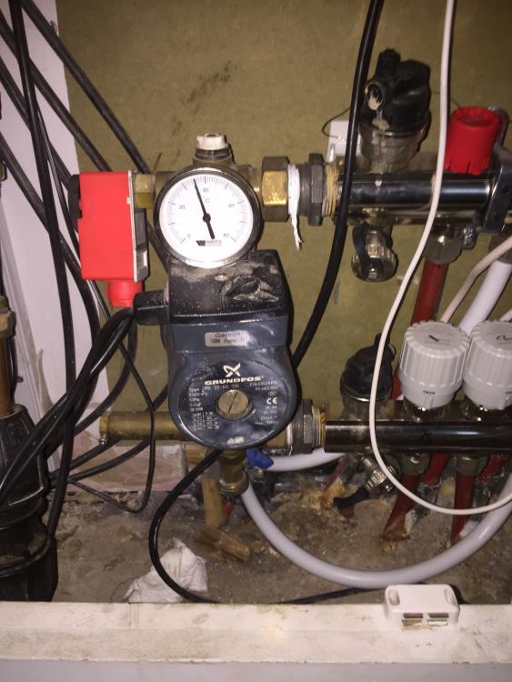

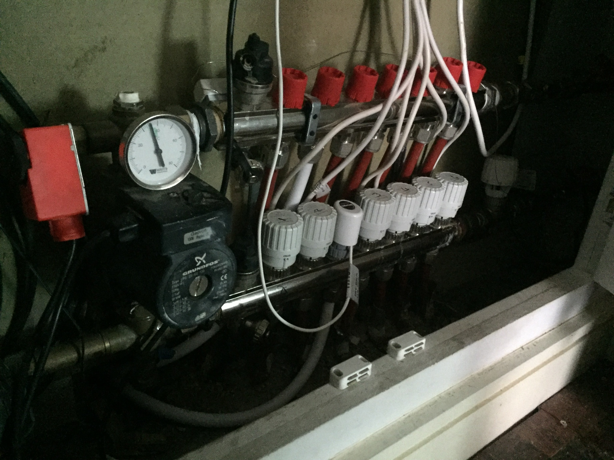

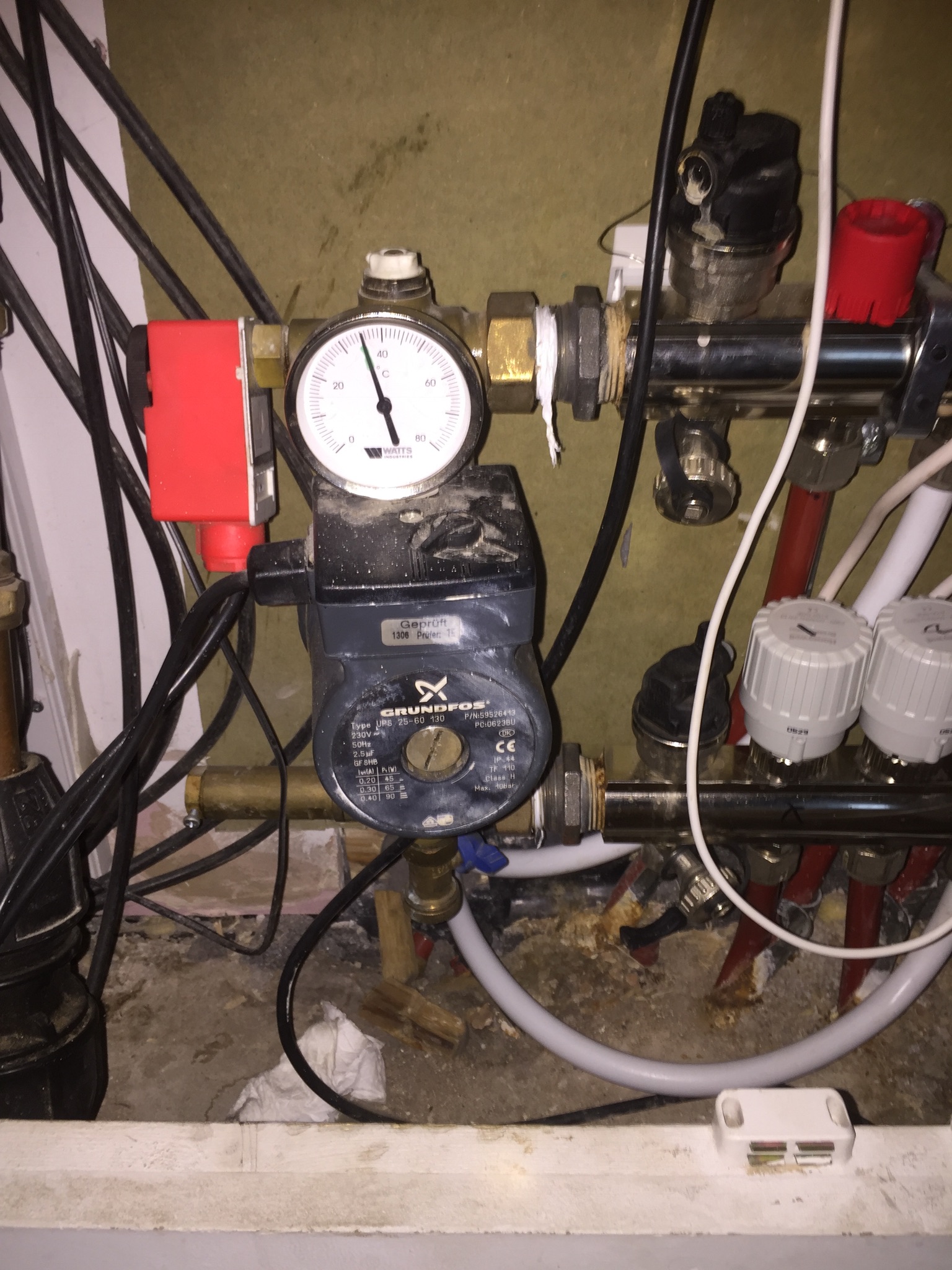

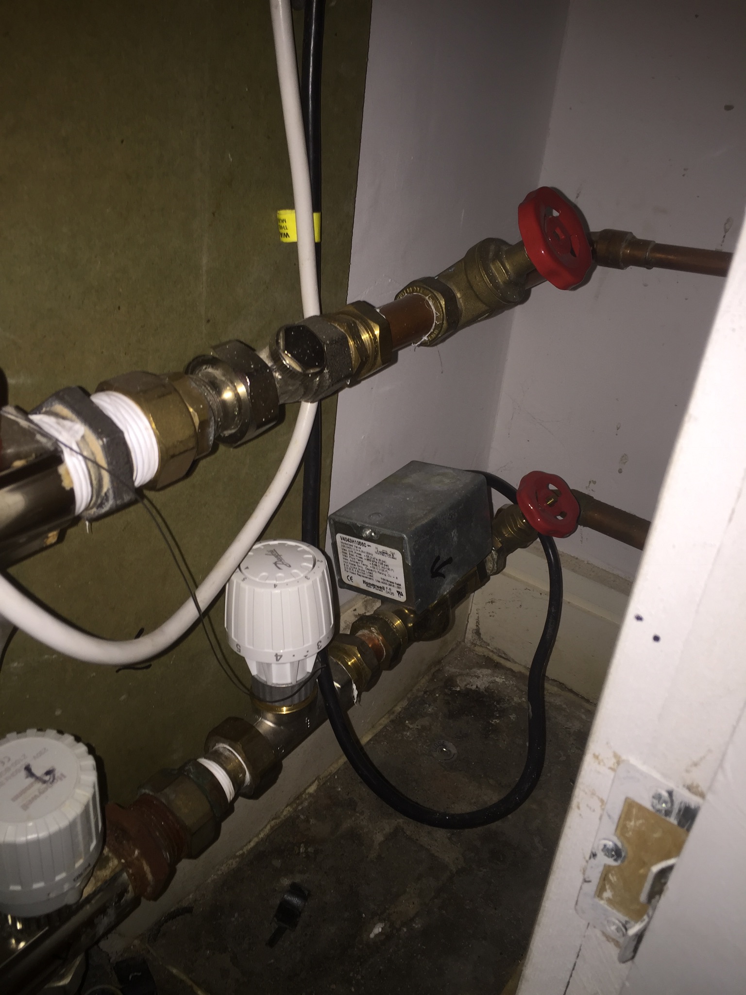

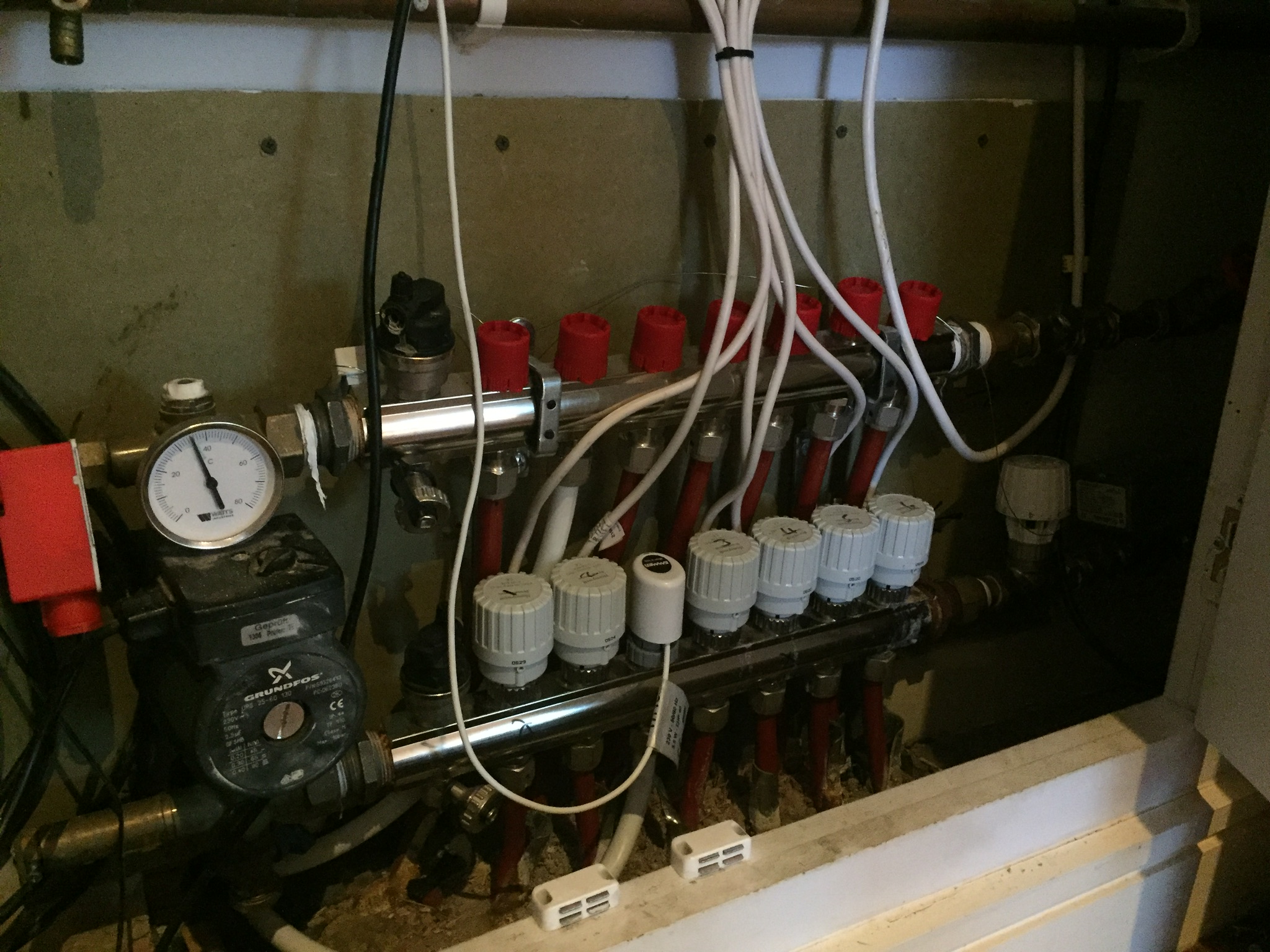

To be honest, I never knew about these until the other week when I priced to sort out my customers Ufh, which had never worked since they moved in around 2007 :S. Previous plumber had the boiler flow going across the return manifold, entering in the end which should have been capped off with the thermo aviator head / TRV there, then being sucked up through the pump and forced through the flow manifold, through it, and out the other end, going back to the boiler return ( so basically a conriuous recirculating loop which completely
Here you can see flow entering the bottom rail, and return leaving the top rail
bypassed all the Ufh loops,if there was no differential pressure greater than the resistance of any one loop ).
Here you can see boiler flow entering the bottom rail via the TRV and boiler return leaving via the top rail :/
It then gets pulled through the pump
What a shambles.
This is a development of 12 like properties in a gated complex, and one neigbour has already asked to be booked in for the same overhaul. I wonder if the same tool fitted them all ? If he did, I may be busy until Xmas. :D
Oh, and the flow temp was unregulated when I got there with the TRV sensor double sided taped to the backer board you see the manifold mounted on. Wtf. The temp dial was showing a bit under 70oC. o.O

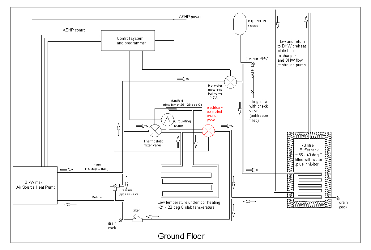

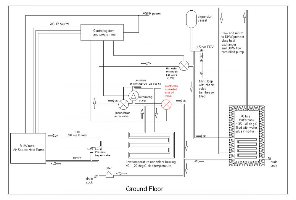

That's crazy!  Our arrangement is the older style Wunda manifold, where the flow comes in via a normal radiator-type TRV at the lower left, on the end of the return manifold, but before the pump station.  The remote sensor bulb for the TRV is in a long pocket inside the upper flow manifold and connected via a capillary tube.  The pump sucks from a tee immediately after the mixed flow injection point and feeds the top flow manifold.  The return comes for the right lower end of the return manifold, with an identical valve to the TRV, but with an actuator head fitted so that the UFH can be turned on or off, by just closing off the return.  The ASHP flow and return are bridged by a bypass valve, as well as by the flow and return to the buffer tank coil, although the latter has a motorised ball valve to be able to turn off the buffer tank when the system is in cooling mode.  This is what the system looks like now, with the new actuator in red:
