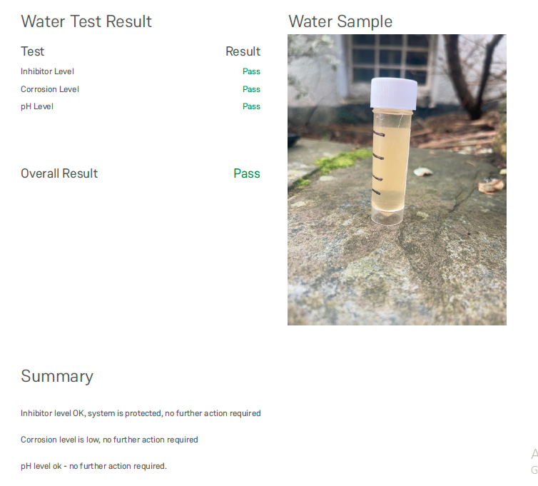

sharpener Posted September 10, 2024 Author Posted September 10, 2024 (edited) Some musings on the hydronics side of things. Installers included a power flush in their scope of work. It didn't produce much in the way of discolouration or debris but good to have it confirmed. When I added 3 rads a few years ago I did a de-scale with Fernox DS-1 (citric acid based), followed by 3 flushes, neutraliser and inhibitor so I was pleased to see it had all stayed clean thereafter. Flushing was done with treated rainwater (free) but the final fill was with mains water as it is slightly alkaline, so I was able to meter the volume, 348 litres which includes the 270 l thermal store. Slightly surprised that te rest including 11 rads was only 78 l but it is possible it was not completely drained to begin with. I would have preferred glycol (see this thread) but the cost for 20% of 348l would have been prohibitive. I asked Hydratech for progress on their cheaper alternative to Fernox HP-5C (which has a min conc of only 10%) but didn't get any meaningful response. So went along with installers' plan to fit 2 x Intatec AFVs which they did neatly and in strict accordance with the MFIs. To treat up to 375 l they then added 1.5 l of Adey MC1+ inhibitor and 1.5 l of MC11+ biocide which they have found necessary in the past. They then tested water samples from the HP itself and the extremities of the system. All three confirmed by the Adey app as OK for pH, corrosion and inhibitor level. Finally when the M.D. came to inspect two weeks later I got him to open the Magnaclean up, there was a small amount of deposit collected by the magnet but nothing on the knitted s/s filter. I was amused to see it was just like an enormous kettle fur collector, and a surprisingly coarse mesh. However its primary function is to trap particles big enough to block the passages in the HX so presumably adequate for that. All in all I felt they had done a very diligent job on all this. Some of the plant room lagging was a bit ragged but they left me some spare lengths and different rolls of tape for inside and outside which I have been using as and when. The pipework external to the house is however lagged with Armaflex inside 2x black plastic ducts so looks very neat. The sparky has done a good job too, and hidden the mains wiring in one and the l.v. in the other to keep them apart. The mild weather has meant that so far we have had no real opportunity to put the heating system to the test. As upthread the HW side is still a bit of a puzzle, I will write up the results as a separate exercise, meanwhile ATM there is mostly enough sun for the immersion heater to cope from the free PV generation. NGED have finally agreed I can increase the battery inverter max power setting to 4.4kW, which gives us a chance of now running the HP at 60% of full output entirely on battery power. This will give us 9kW thermal output down to 0C while leaving 600W to spare for other loads. Edited September 10, 2024 by sharpener

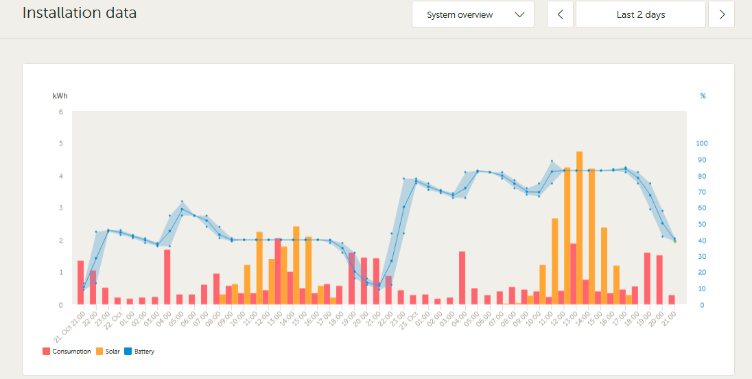

sharpener Posted October 23, 2024 Author Posted October 23, 2024 So a lot has happened since my previous post! 3/10/24 Octopus' subcontractor fitted a smart meter in place of the obsolescent Radio Teleswitch E7 meter. 4/10/24 smart meter operational, and import tariff changed to Octopus Cosy 8/10/24 the DNO agreed to unlimited exports (installed PV 6.9kW nom) and an increase in the inverter rating to 4.4kW 17/10/24 smart meter exports now operational on Octopus Outgoing Fixed tariff (though Good Energy have yet to discontinue their deemed exports) All this has enabled me to change the way I use the HP/battery system. The house is long and thin and unless we have guests we only use specific rooms at specific times. In addition to the HP there is also an AGA in the kitchen/dining room where we spend much of the day if we are not out or in the garden. Bedroom is over the kitchen so requires only a little additional heat. So the time schedule is now as follows (cheap windows in bold😞 0000 - 0400 Cosy tariff 24.71p/kWh - house runs from battery, HP off 0400 - 0700 12.11p - forced charging of battery from grid, HP charges 270 litre thermal store 0700 - 0900 24.71p - thermal store supplies bedroom and bathroom radiators 0700 - 1300 24.71p - PV surplus (if any) charges battery. HP available for UFH (only needed for hall and dining area in cold weather). 1300 - 1600 12.11p - forced charging of battery from PV or grid, HP charges the thermal store 1600 - 1900 35.82p - thermal store supplies sitting room radiators, HP off, house runs from battery. 1900 - 2200 24.71p - HP runs from battery to heat livng room (and bedroom and bathroom from 2130) 2200 - 2359 12.11p - forced charging of battery, HP runs from grid as necessary to heat bedroom until 2230. The battery charging is under the control of the Victron inverter's Dynamic ESS algorithm (in its more agressive Trade Mode) which is still learning. But I am not yet convinced it is doing any better than the standard Scheduled Charging regime would achieve. Apart from this I think the routine is now fairly settled, but optimising the DHW is still a voyage of discovery.
sharpener Posted October 23, 2024 Author Posted October 23, 2024 (edited) Edit: Forgot to include this pic. It shows that today the Victron algorithm has decided the optimal state of charge is 83%, and achieved this during the first two cheap windows so it can export most of the solar which was predicted for the afternoon. Whereas yesterday the plateau was at only 40%, was it expecting there to be more sun so left more headroom but it failed to appear? There's not a lot in it anyway as the round-trip efficiency is around 80% so the cost of charging at 12p is almost exactly the same as the extra PV gained at 15p. And that is before the depreciation which has been put in at a token 5p/kWh/cycle. Edited October 23, 2024 by sharpener

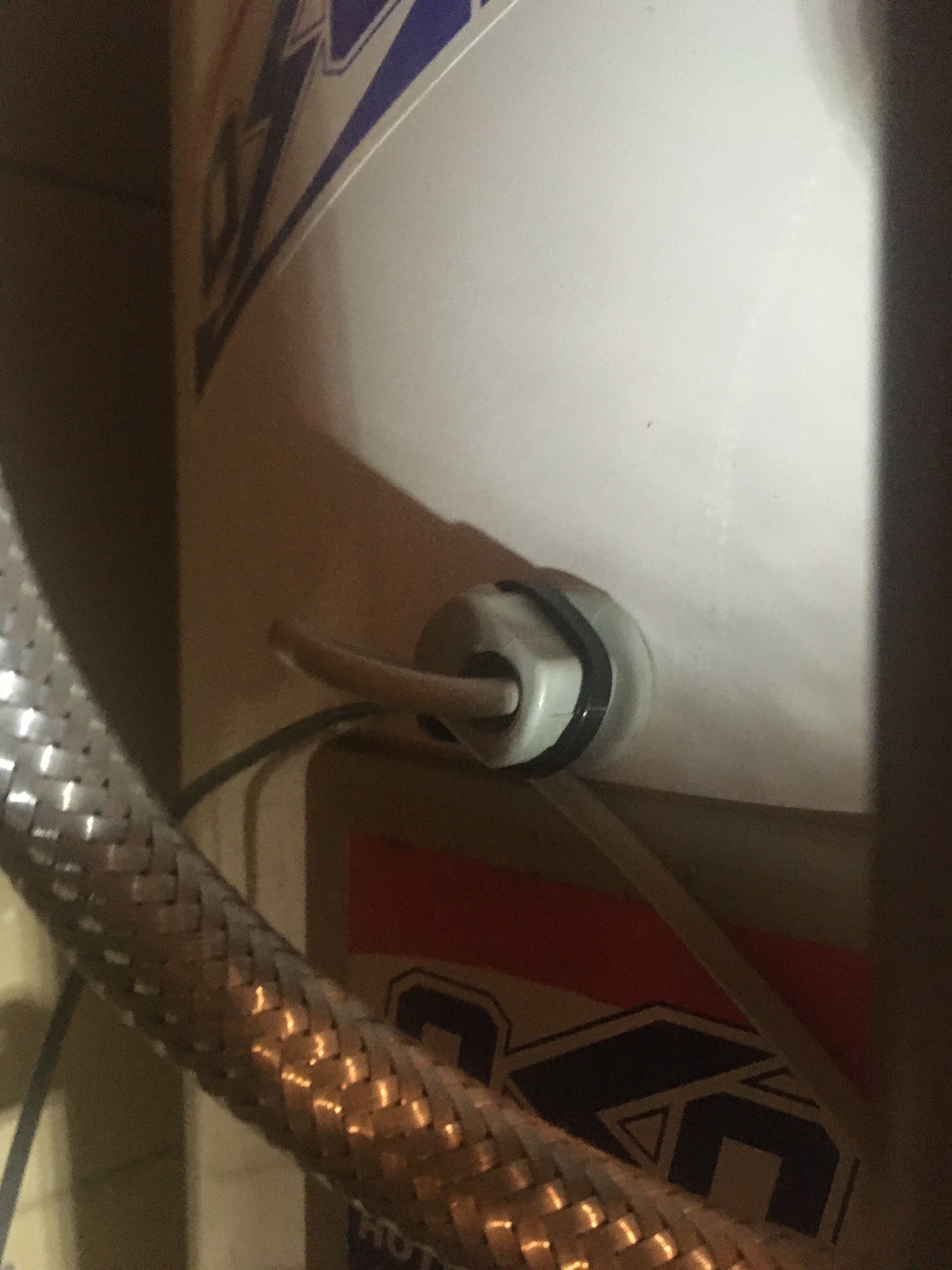

sharpener Posted October 29, 2024 Author Posted October 29, 2024 (edited) Finally made a discovery which might explain some of the anomalies on the HW side of things. Water was too hot to touch but temperature measurement was only 30-ish degrees. The temperature sensor had been stuffed into some random hole about 2/3 of the way up the tank, I think it is a cable strain relief for the (unused) upper terminal cover. Not a thermostat pocket at any rate, see pic: There was no thermal contact with the tank at all bc the springiness of the cable pulled it back out a bit. Removing it from there and pushing it a short way under the insulation on the outlet pipe at the top of the tank caused the reading to jump from 32.5 to 40.5 and running off some hot water raised it to 42. Explains a lot. Will now have to re-do all the tests I did to find the optimal way of running the HW. The original plan as upthread was to configure the TS as a second HW tank but that didn't work bc (contrary to what Vaillant Tech said) if there are two cylinders they are fed one after the other not simultaneously. Because of this I have now added a switch so that charging the thermal store automatically feeds the coil in the cylinder in parallel. And then the HP isn't working on its HW cycle, so doesn't run up to 70C trying to force 12kW into the cyl (or even 6 in Eco mode). Every day a school day. Edited October 29, 2024 by sharpener 1

marshian Posted October 31, 2024 Posted October 31, 2024 On 29/10/2024 at 18:45, sharpener said: Finally made a discovery which might explain some of the anomalies on the HW side of things. Water was too hot to touch but temperature measurement was only 30-ish degrees. The temperature sensor had been stuffed into some random hole about 2/3 of the way up the tank, I think it is a cable strain relief for the (unused) upper terminal cover. Not a thermostat pocket at any rate, see pic: There was no thermal contact with the tank at all bc the springiness of the cable pulled it back out a bit. Removing it from there and pushing it a short way under the insulation on the outlet pipe at the top of the tank caused the reading to jump from 32.5 to 40.5 and running off some hot water raised it to 42. Explains a lot. Will now have to re-do all the tests I did to find the optimal way of running the HW. The original plan as upthread was to configure the TS as a second HW tank but that didn't work bc (contrary to what Vaillant Tech said) if there are two cylinders they are fed one after the other not simultaneously. Because of this I have now added a switch so that charging the thermal store automatically feeds the coil in the cylinder in parallel. And then the HP isn't working on its HW cycle, so doesn't run up to 70C trying to force 12kW into the cyl (or even 6 in Eco mode). Every day a school day. That is a little poor (understatement) PS thanks for sharing the journey
