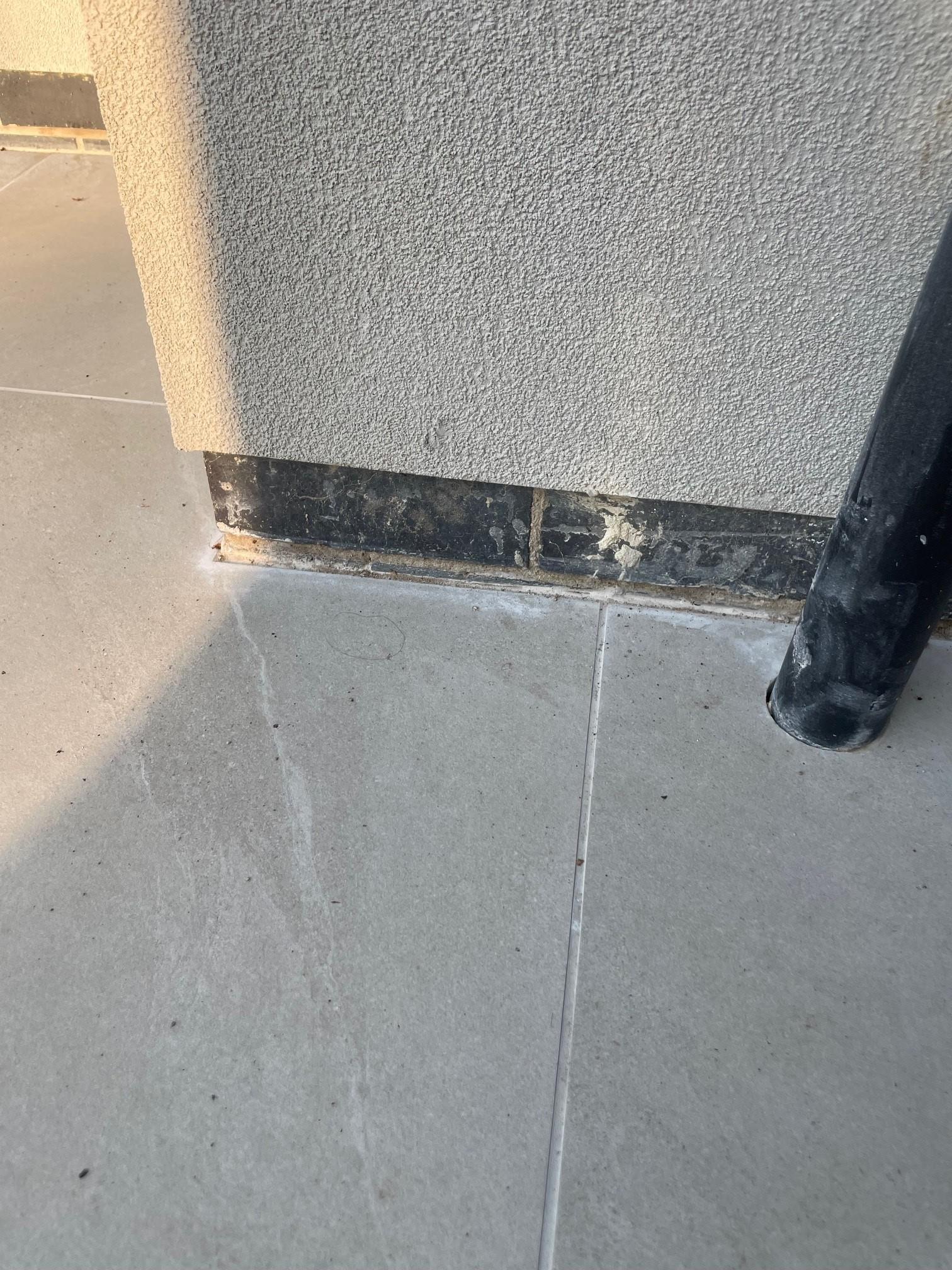

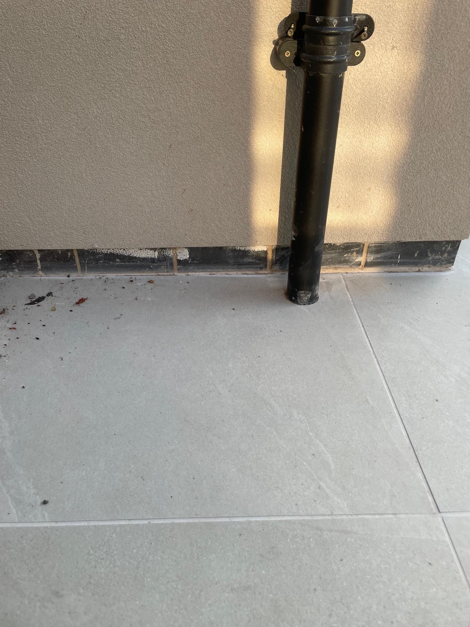

richo106 Posted August 2, 2024 Share Posted August 2, 2024 Good Morning all I am now looking to clean up my blue bricks round the bottom of the house, they have quite a bit of mortar and some render paint (see attached photos) Could anyone recommend the best way (cleaning stuff/tools/brushes) to get these cleaned up the best I can Many Thanks Link to comment Share on other sites More sharing options...
Mr Punter Posted August 2, 2024 Share Posted August 2, 2024 Brick acid and a stiff brush. Gloves and glasses. Link to comment Share on other sites More sharing options...
goodbyegti Posted August 2, 2024 Share Posted August 2, 2024 12 hours ago, Mr Punter said: Brick acid and a stiff brush. Gloves and glasses. +1. I made a mess of mine, and brick acid worked a treat. As Mr Punter says, don't skip the PPE. Link to comment Share on other sites More sharing options...
bassanclan Posted August 3, 2024 Share Posted August 3, 2024 Usually 150mm to dpc, looks like only 75mm Link to comment Share on other sites More sharing options...
