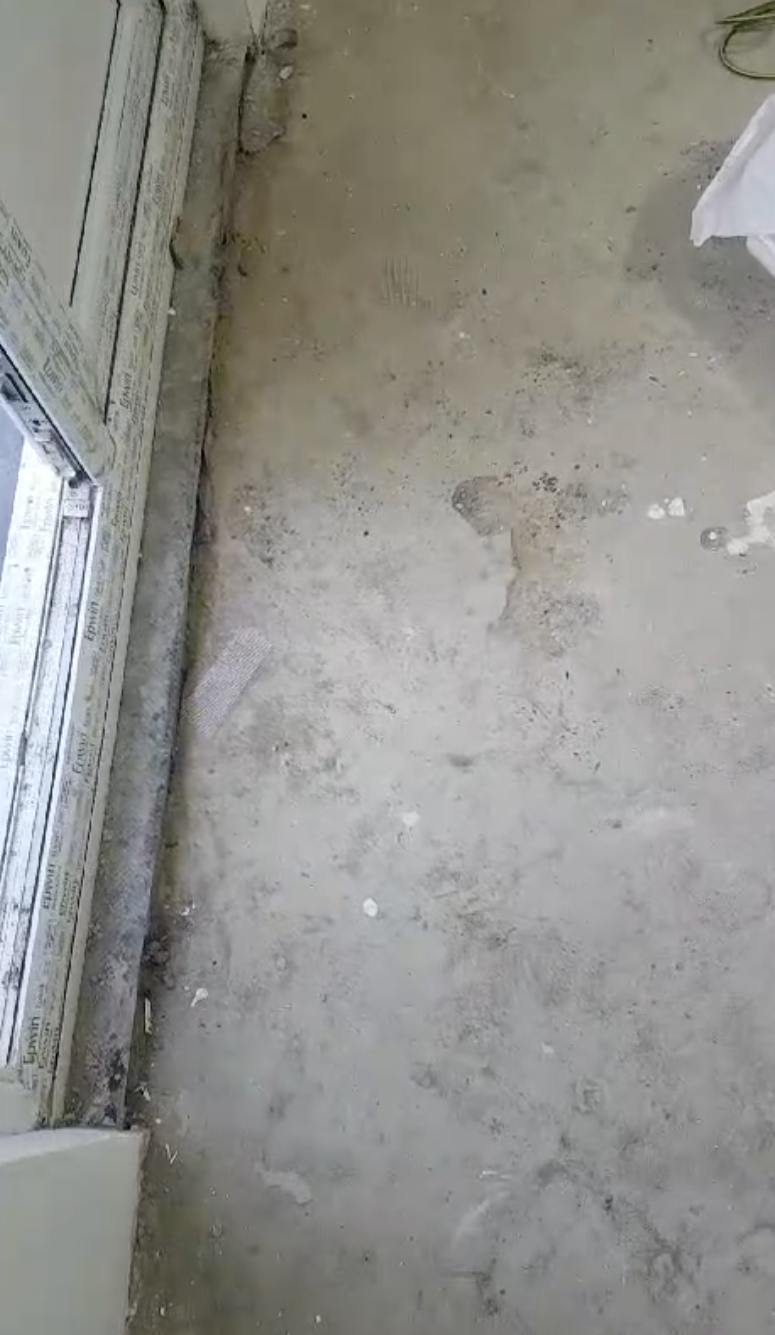

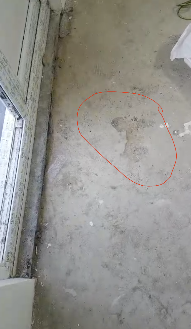

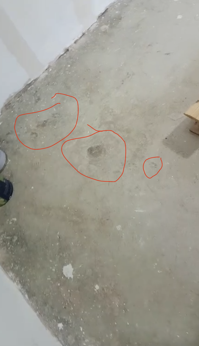

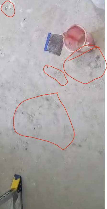

Janan Jai Posted July 23, 2024 Posted July 23, 2024 The Floor in the shed was not upto standards and it appears loose, I mean it appears loose materials keep coming out as we walk along. For example, if we have to use the floor walking up and down 100 times at the same place, it is very likely to become loose. Have attached some images. I would like to make this floor stable and strong as iam going to use the shed heavily for storage. What is the best way to go about ? Screeding or Self levelling compound ?? I may just have less than an inch worth of depth left ? Need a strong and a stable floor. I am likely to go with engineered wooden planks or Vinyl sheets for flooring later. Please advise.

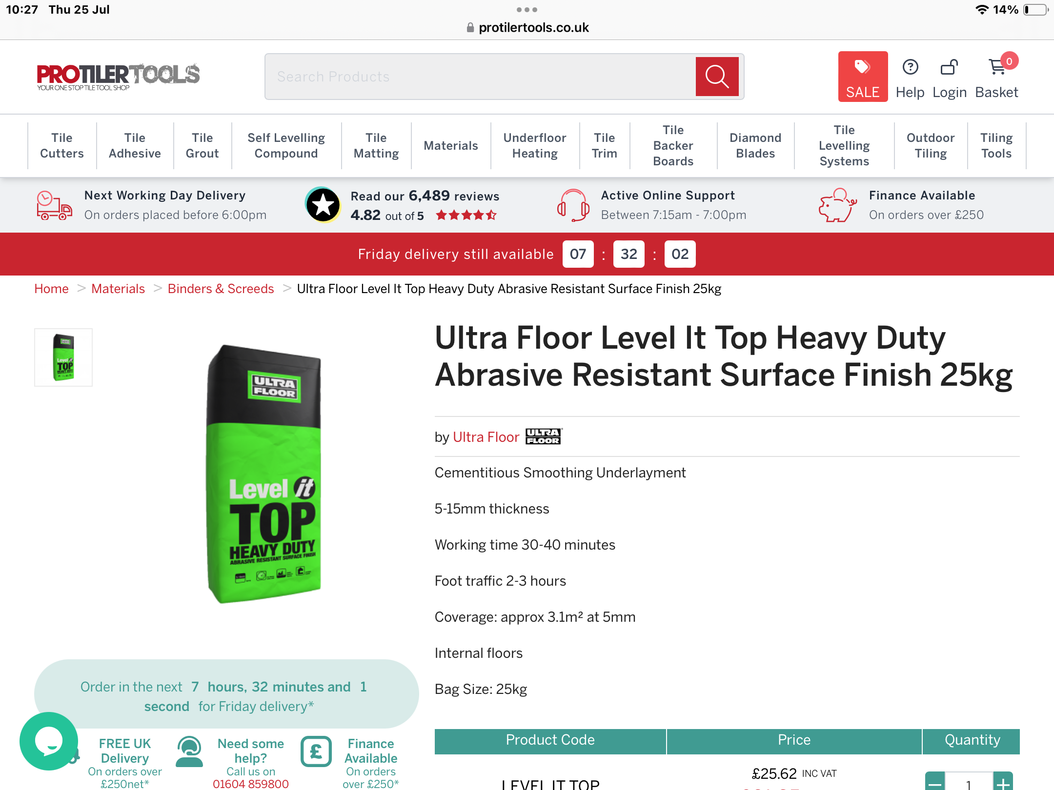

Russell griffiths Posted July 24, 2024 Posted July 24, 2024 You can get a leveling compound that is designed as the finished floor, you want this, not all self levelling compounds are designed to be walked on for a prolonged time.
Janan Jai Posted July 24, 2024 Author Posted July 24, 2024 6 minutes ago, Russell griffiths said: You can get a leveling compound that is designed as the finished floor, you want this, not all self levelling compounds are designed to be walked on for a prolonged time. Can you please advise any levelling compound which are fit for this purpose ?
