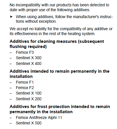

billt Posted July 24, 2024 Share Posted July 24, 2024 Too long, didn't read or similar. (Wants the precis because people don't like lots of words.) No inhibitor in my system so you could call it VDI 2035 if you wanted to be pretentious. I've long been sceptical of the value of chemical additions to a properly sealed system. 2 Link to comment Share on other sites More sharing options...

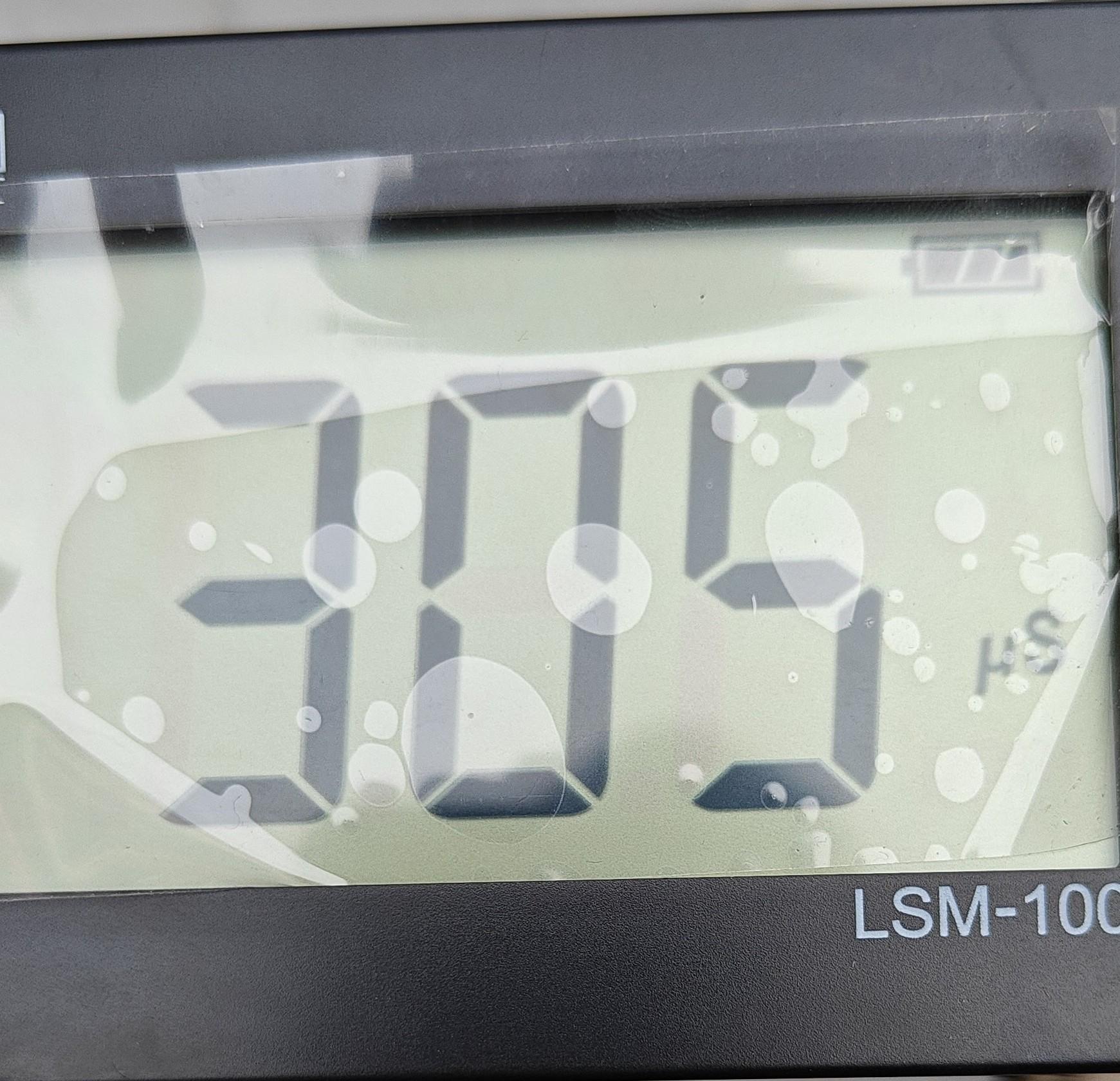

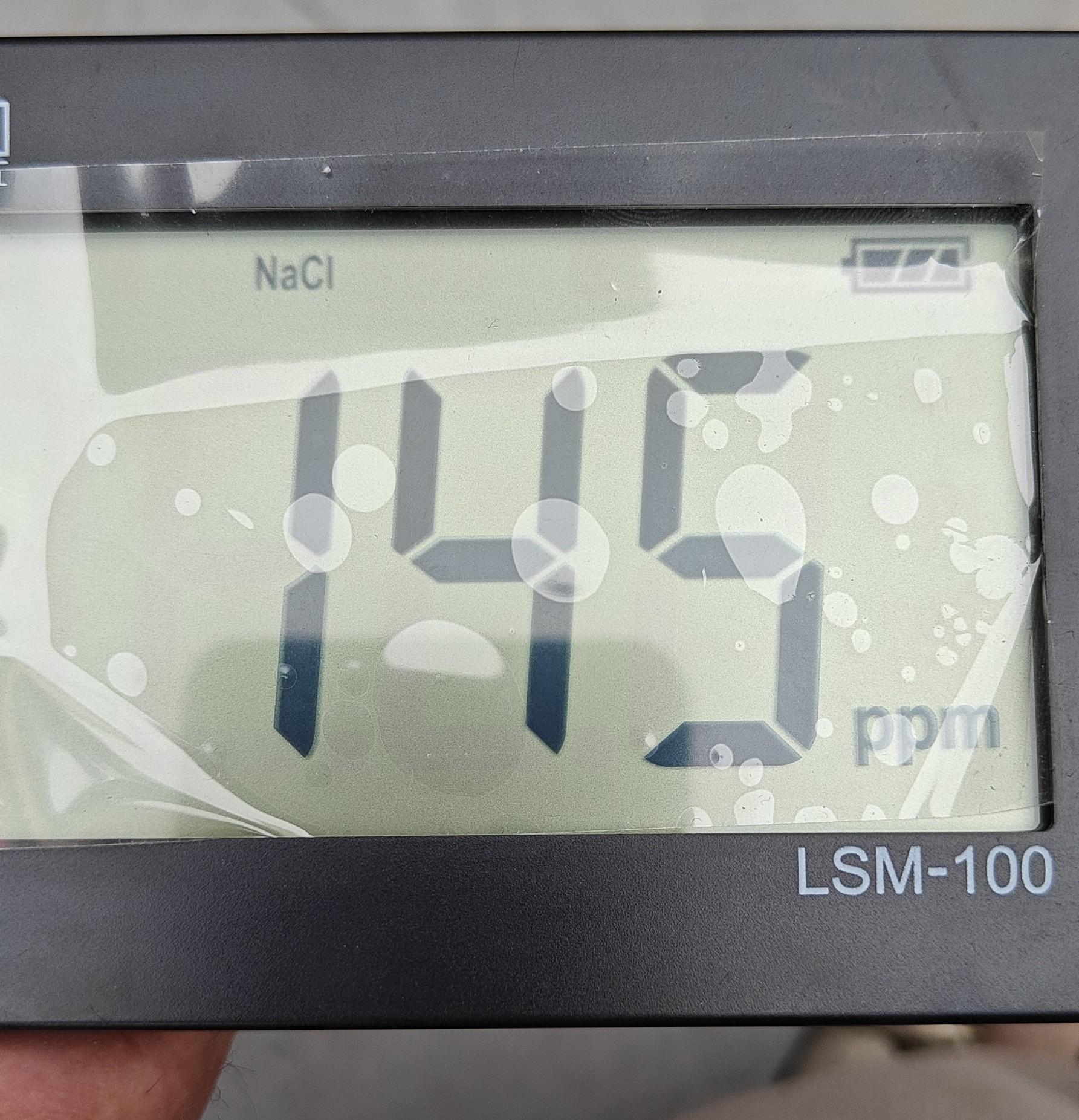

JohnMo Posted July 31, 2024 Author Share Posted July 31, 2024 On 23/07/2024 at 16:45, JohnMo said: Conductivity (80 to 1550 microsiemens) Ph 8.2 to 10 And Scale products below 300ppm Got my meter today, similar size to a smart phone, so you don't need your glasses on the read the digits. Just tested some tap water Conductivity is 305 microsiemens Scales produced (dissolved minerals) is 145 ppm. So my tap water comes in fine. But higher than I would like, so will be treating it. Ran tap water through the ion exchange resin, it seems to drop the dissolved minerals to about 45 ppm and half the conductivity to 150 microsiemens. A bit of playing with flow rates required to see how it changes. Have added a cheap hose pipe flow meter, then I can repeat a flow rate and also see the quantity of water I have, flushed out or added to system. Link to comment Share on other sites More sharing options...

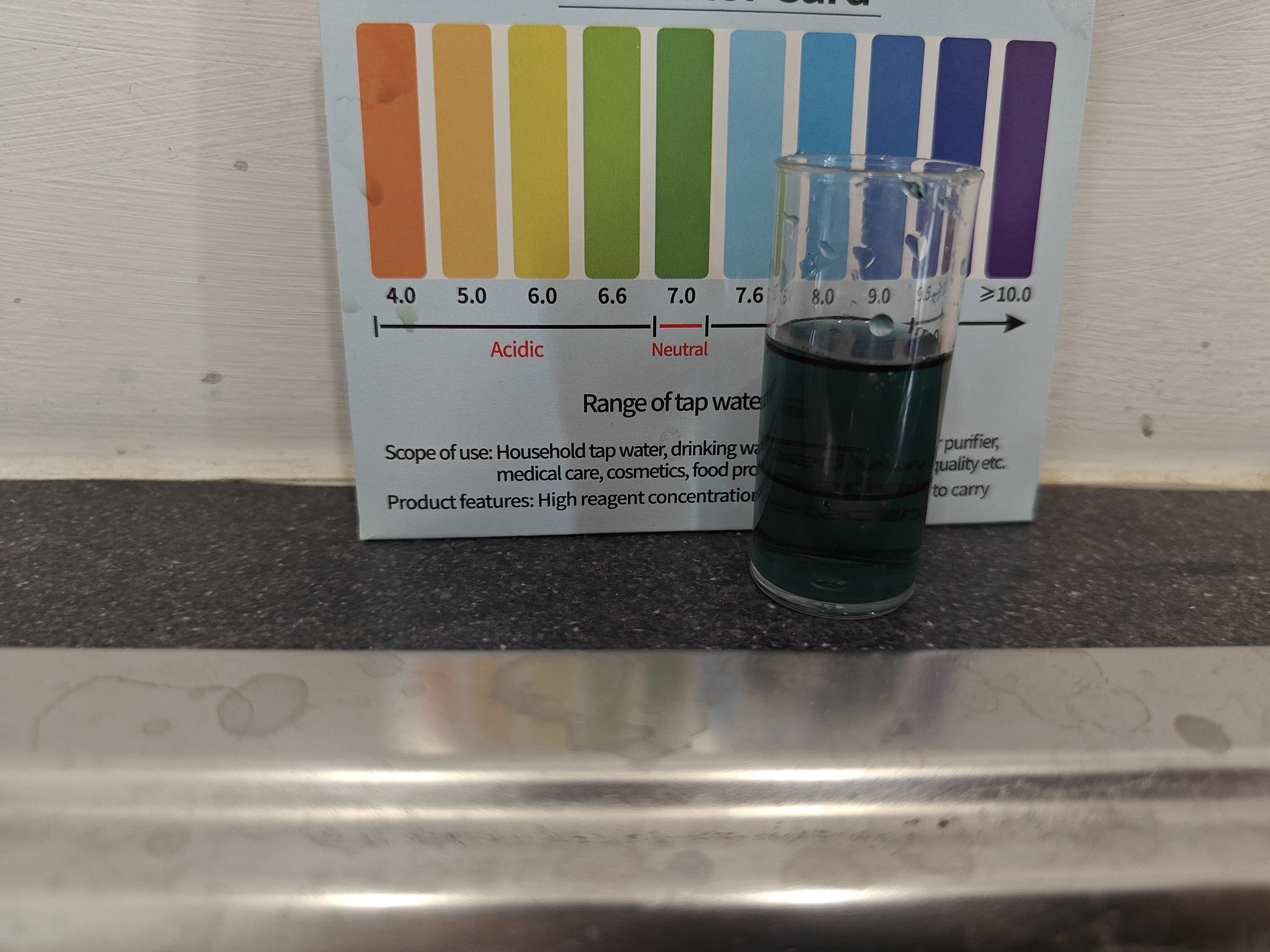

JohnMo Posted August 16, 2024 Author Share Posted August 16, 2024 Did a final finish on the water yesterday and today, after leaving the water to circulate for a couple weeks. Did the finish with a slip stream at 0.7L/min through the media. Let it run for about 7 hrs over two days. Final ppm is 114 Final conductivity 236 microsiemen Water looks really clear The above was completed with one fill of Ion Exchange media and it processed around 850L of water. So from brown water with glycol in it, to clear fresh water. On 27/07/2024 at 13:11, sharpener said: colour card is not quite accurate, pH 7.5 is a beautiful cyan colour not the pale blue shown This mine, none of the colours but looking more alkaline than acid. Link to comment Share on other sites More sharing options...
sharpener Posted August 17, 2024 Share Posted August 17, 2024 On 16/08/2024 at 12:48, JohnMo said: This mine, none of the colours but looking more alkaline than acid. Yes, that is what I meant, defo alkaline. If you titrate it carefully with say bicarbonate solution it will change into the sky blue colour they show for 8.0. Ditto wine vinegar, at neutral it will turn a proper green. Which is the basis for my thinking cyan is in the region of 7.5. I had a fruitless exchange with Water for Health about this, couldn't get near anyone technical and gave up, however they are the only ppl I could find selling it in small qties. Tried searching online for other colour charts since this universal indicator mixture is fairly common, but found nothing better not even the Wikipedia article. On 03/08/2024 at 20:49, JohnMo said: One thing that surprised me was the effect on system flow rate. Nothing had been changed except the fluid pumped, it is now straight water. Prior to clearing the glycol mix from the system, it was circulating 1m³/h, this morning just below 1.3m³/h. So a question Do I leave the flow rates high or adjust the UFH manifold rates down to bring overall rate down? I would guess leave the flow rate as high as it goes for improved heat transfer provided flow is not noisy. Meanwhile as you may have seen my 12kW Arotherm plus is operational. Total system capacity is 348 litres so installers put in 1.5 litres of Adey MC1+ inhibitor and 1.5 l of MC10+ biocide. They hadn't heard of VDI 2035 even though there is a paragraph in the Vaillant manual. They also did a power flush with great fanfare, but the water looked pretty clean and passed the shiny nail test so the Fernox F1 put in many years ago was still working. I would have preferred filling with glycol solution to fitting antifreeze valves but Hydratech didn't respond to my query as to when their product suitable for diluting to 5% was going to reach the market, and at 10% the cost of 35 litres would have been prohibitive. Link to comment Share on other sites More sharing options...
