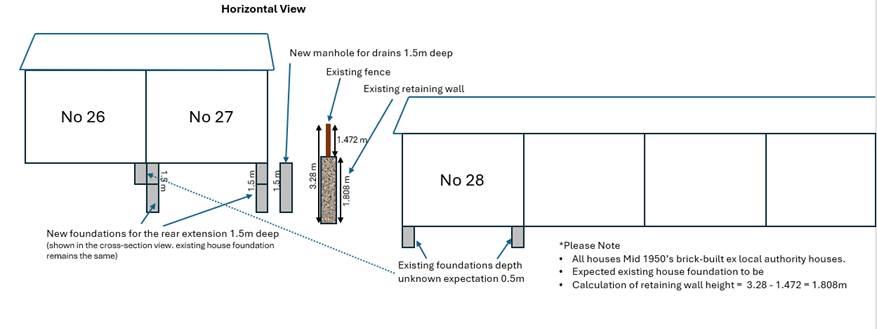

I'm wondered if i can seek your advice thoughts, experience and comments. I am planning on doing a small single story rear extension on the back of my house.
Our house is a (1950’s) semi (ex local authority house). I won't be building on the dividing walls of the houses or the neighbours garden/retaining wall.

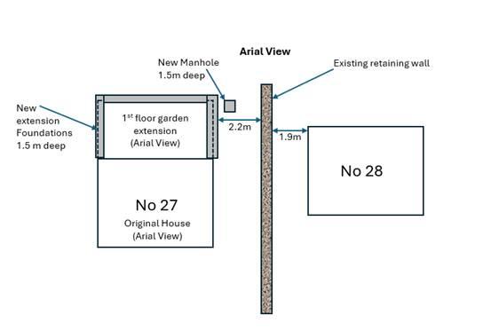

I will be building about 4m away from this retaining wall, so my new proposed foundations will not be touching this walls foundation. I have done a couple of illustrations to outline the situation.
There is quite a significant reop between me and my unattached neighbour on the right. With a minimum of 1.8m in height (This is the lowest height of the retaining wall)
The retaining wall between my neighbour and I have been there since the houses were built and is fine structurally although some facings of bricks have blown with the weather and ill repoint and repair these post the extension build and get access to the neighbours land.
Soil wise its hard clay here if that provides additional context. The drawings state my extension foundations should ne 1.5m I don’t officially know what the existing house foundation depth is, for the neighbour or I, However as mentioned I wont be surpassing the neighbours foundation depth.
The wall of the extension and the wall of the neighbour’s house is 4.1m apart. They are also as mentioned nearly 2 meters below in height. So my understanding is it is not within 3 meters and also I will not be putting foundations lower than the neighbour’s house. Therefore a PWA agreement is not required.

·         My question is around a Party wall agreement, based on the information above and the diagram below is a party wall agreement required?

Well i have an update a letter landed on my doorstep this morning from a party wall solicitor citing that they have been authorised by my neighbours to act for them in relation to the proposed building works, and that under the party wall act i need to serve one month notice prior to commencement of the works and that i should direct all plans and communication to them in their office.
They are also stating they can act for me also.
I thought on 2 grounds the act wouldn't apply based on the above, am i wrong? Everything i have read seems to support that.
  • The party wall agreement only applies if you are building within 3m of the neighbours foundations. Which i am not as its just over 4m away.
  • The foundation's need to go lower than the neighbours foundations to make the party wall act valid within that 3m boundary, and my foundations will not be going lower.
Am i right on the two points above and if so what response  shall i give to the letter sent?

IMO you can either ignore the letter or reply stating the PWA is not required.

Bear in mind that as soon as you serve a Party Wall notice you will be liable for the fees of your surveyor plus those of the adjoining owner.  In any case you will be liable for any damage.
If you do the work without serving a notice the only recourse the adjoining owner has is to issue a High Court injunction.  If they are not successful with the injunction they will be liable for your fees and expenses in defending it so quite a gamble if they are not sure of winning.
