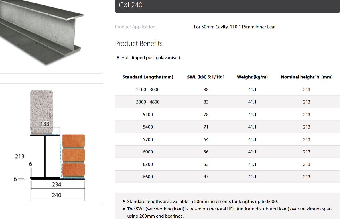

Ian Posted October 24, 2017 Share Posted October 24, 2017 (edited) Try looking on the Catnic website. Here's one of their standard cavity wall lintels. It's designed for a 250mm cavity wall (you need to check the width of your own wall) and is in the "extreme duty" category (you may not need something this heavy duty). https://catnic.com/products/cxl240 Edited October 24, 2017 by Ian Link to comment Share on other sites More sharing options...
