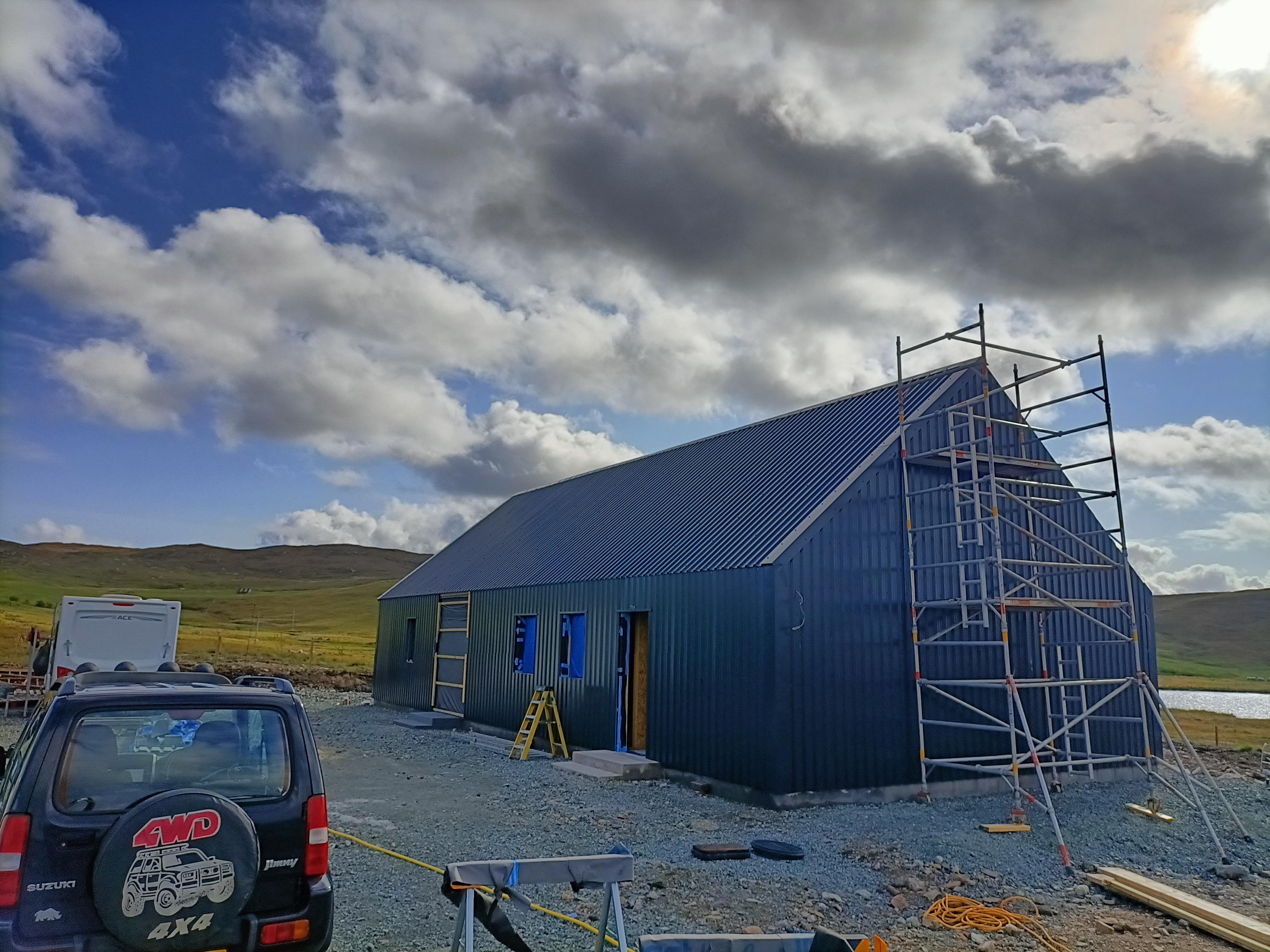

Nealt Posted June 27, 2024 Share Posted June 27, 2024 We are building a house on Shetland. Weve got all our roof/wall sheets on. Now our BW Inspector is insisting on ventilating under the roof cladding. The sheets are fixed to 50mm battens. We used foam sealing strips top and bottom, but they arent air tight. Given the wind in Shetland I cant believe there is a lack of air movement under the sheets. Anyone have any thoughts, suggestions on this issue Link to comment Share on other sites More sharing options...

Eric Posted June 27, 2024 Share Posted June 27, 2024 With the sheets being on 50mm battens I would say that would provide the ventilation, if you removed the foam strips. House looks smart, is that metal sheets on the walls also? Link to comment Share on other sites More sharing options...
Nealt Posted June 28, 2024 Author Share Posted June 28, 2024 10 hours ago, Eric said: With the sheets being on 50mm battens I would say that would provide the ventilation, if you removed the foam strips. House looks smart, is that metal sheets on the walls also? Thanks for the response Eric. I dont think removing the inserts is a good idea here. The wind will drive rain under the sheet. Thinking about it the air under the sheets when warm must rise and vent out under the ridge by convection. Yes we have the whole house clad in steel Link to comment Share on other sites More sharing options...

Nealt Posted June 28, 2024 Author Share Posted June 28, 2024 4 hours ago, IanR said: What are the 50mm battens on? Do you have counter battens or are they on a solid deck? Have you got a continuous gap from ridge to eaves? The battens are on the sarking fixed through to the trusses. Yes there is a continous gap up to thr ridge, formed by the peak of the sheets Link to comment Share on other sites More sharing options...
