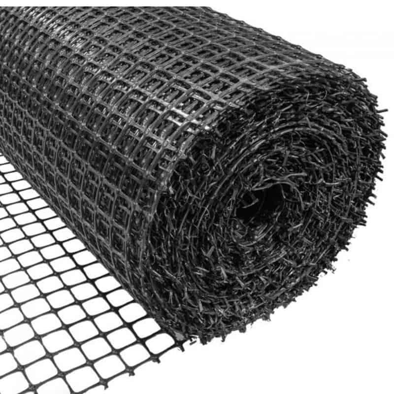

ToughButterCup Posted June 20, 2024 Posted June 20, 2024 I'm planning an external workshop - the internal area will be 30 square meters. Following Chapter 10 of the NHBC guidance, I'm going to use this cross-section for the foundation; I have some left over Geogrid from our build - this stuff I have a good deal more than 30 square meters of it. According to the NHBC, I don't need any 393 - I intend to put in a Movement Joint anyway I'm keen to see the back of the roll of Geogrid. It's fine when its underground, but a right pain in the Botticelli anywhere else. Is there any point in putting it in the concrete as reinforcement ?
Kelvin Posted June 20, 2024 Posted June 20, 2024 If there are no downsides, you can’t sell it, and it’s in the way why wouldn’t you?
saveasteading Posted June 20, 2024 Posted June 20, 2024 I see downsides. Big stones will be isolated on either side of this mesh, reducing the interlink, thus reducing the strength. How would you support it? Why not give it away? If it was useful for concrete I'd expect it to be advertised for it. 1
ToughButterCup Posted June 20, 2024 Author Posted June 20, 2024 Good point. So if I just put the mesh in contact with the ground and then put mot1 over the top of that?
saveasteading Posted June 20, 2024 Posted June 20, 2024 35 minutes ago, ToughButterCup said: in contact with the ground and then put mot1 over the top of that? that is fine and what it is for. it will prevent stone pushing down and mixing with mud.
